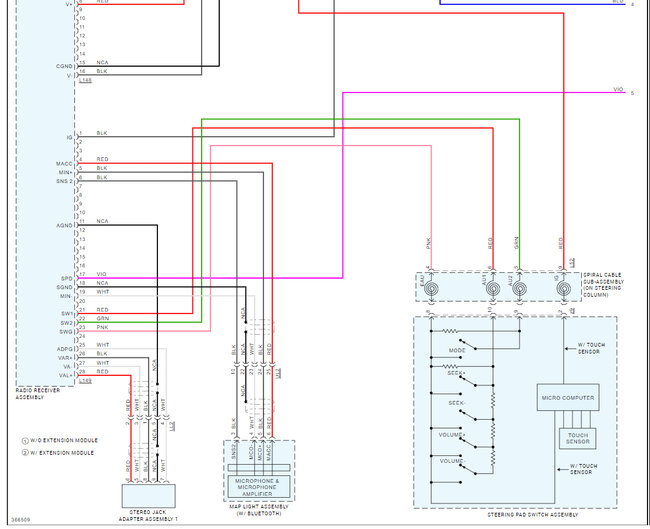

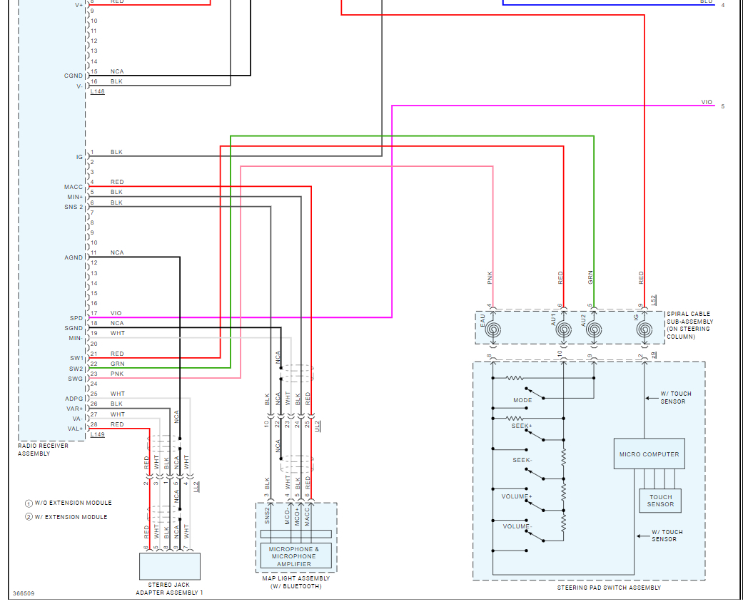

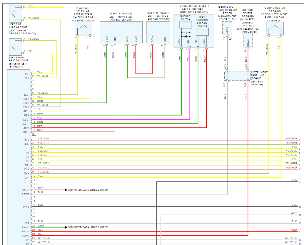

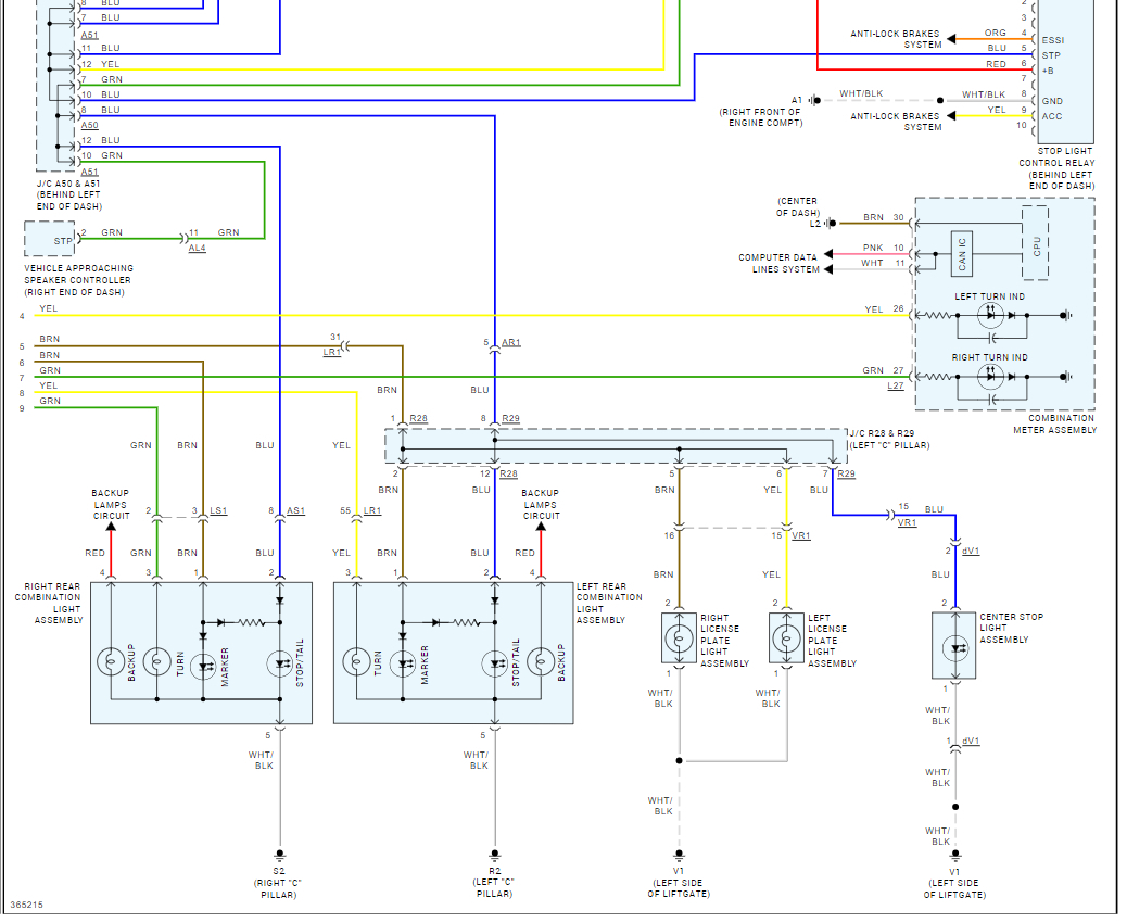

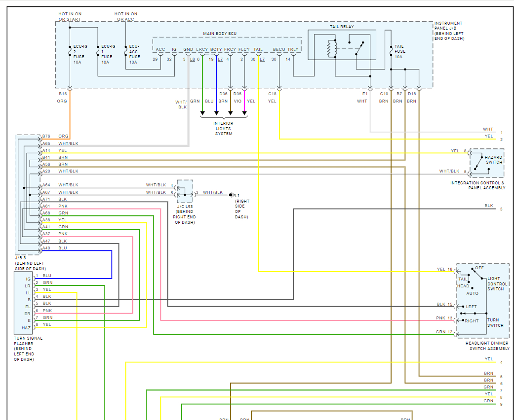

I have a friend who has the vehicle listed above. Their ex slashed all the tires and cut the wiring underneath the steering wheel. I've found all the connectors for everything but there are several wires of the same color going to different connectors. I'm hoping somebody could help me out with a wiring schematic of the part of the harness going to the steering wheel and hopefully pinouts of the plugs going to it.

I am sorry to hear that, let's get it fixed back up. Can you tell what the wiring harnesses are going to? I have all of the wiring diagrams but need to know which ones you need.

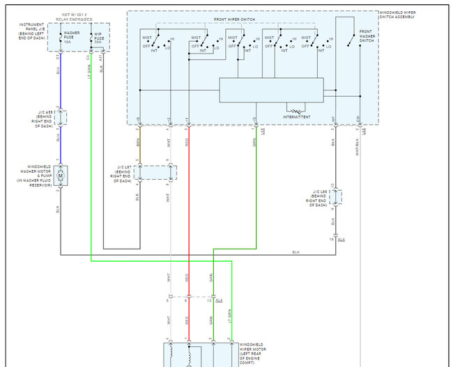

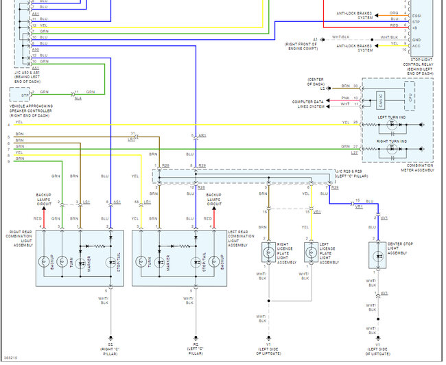

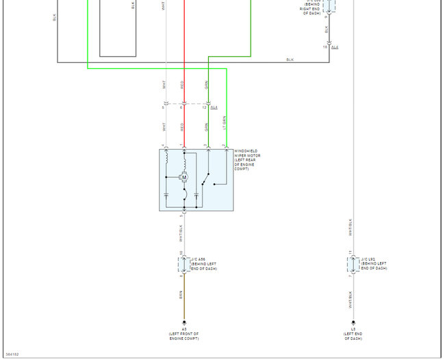

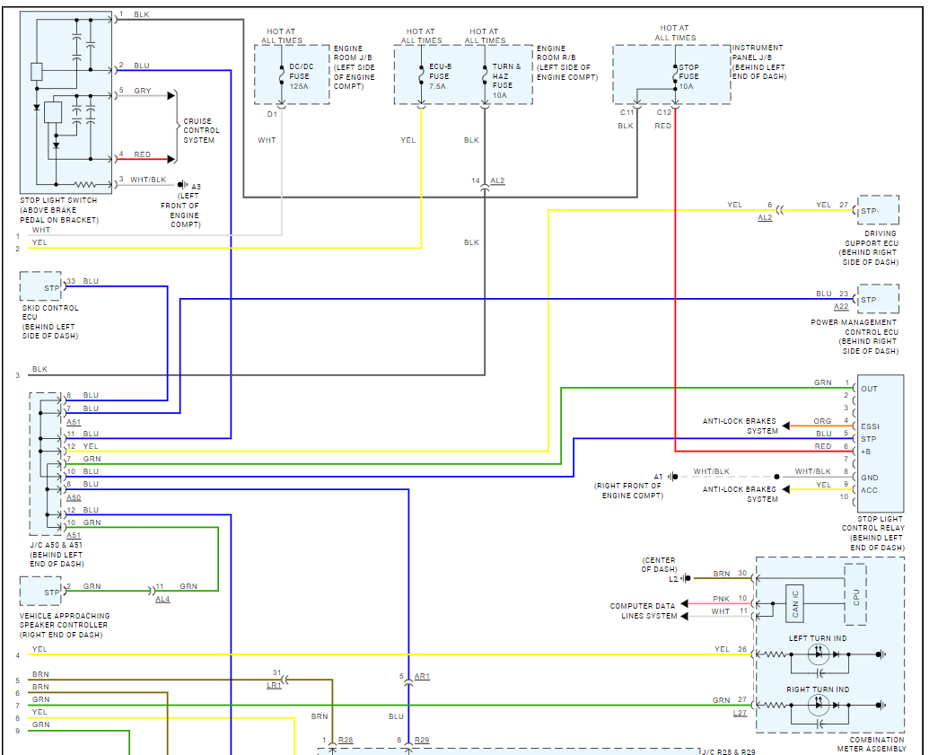

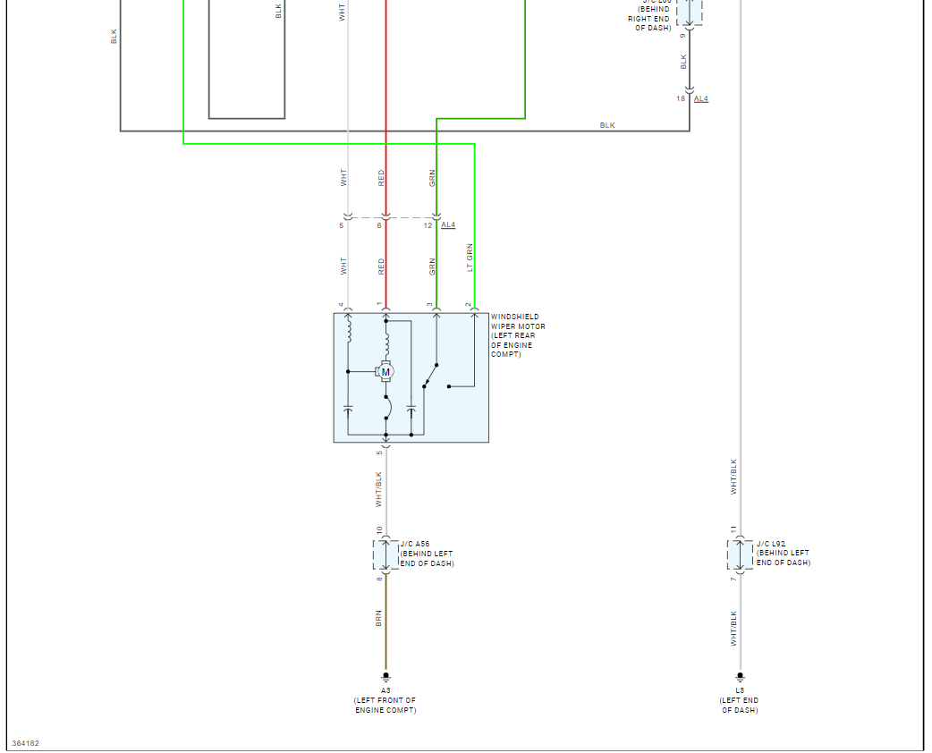

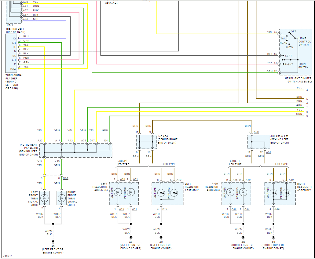

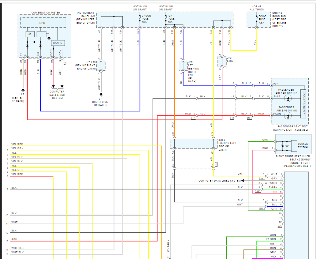

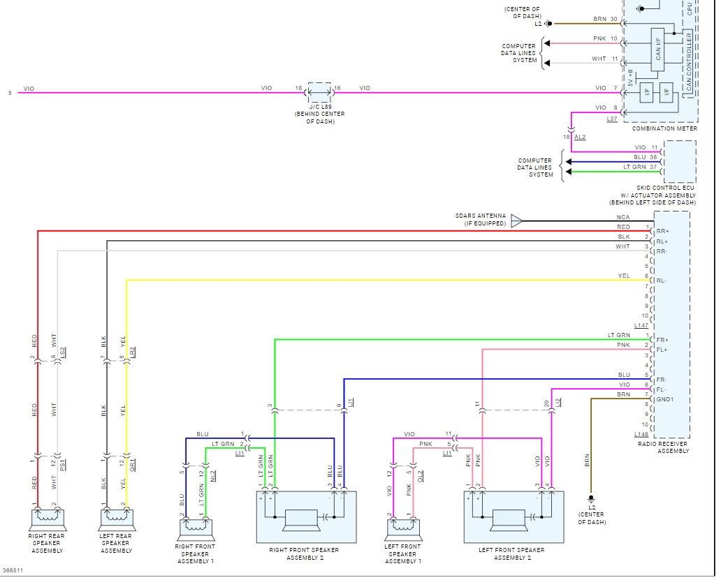

Hello, thanks for responding. I need it for the windshield wiper switch, the turn signal switch, and the steering wheel controls.

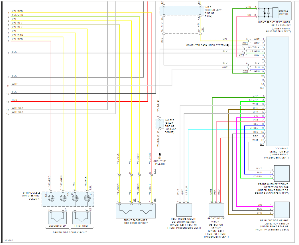

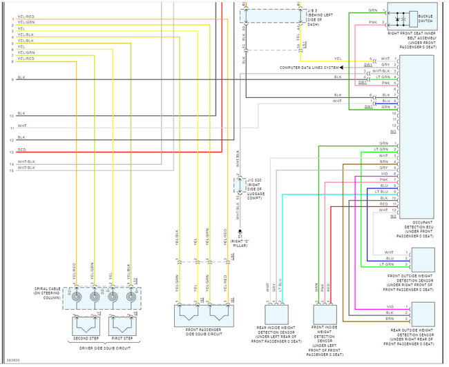

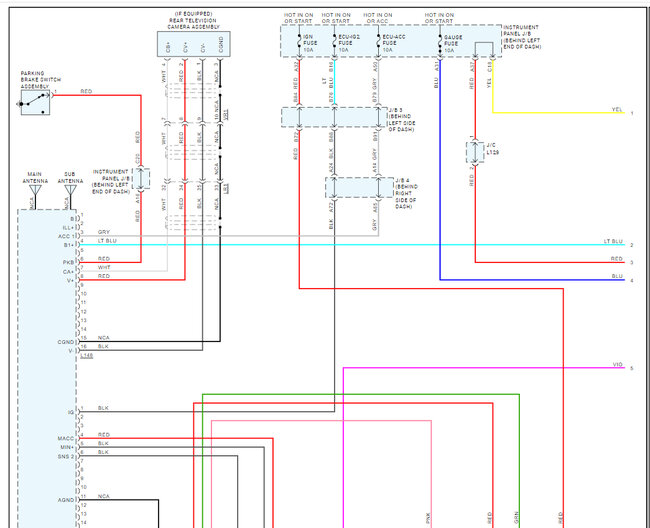

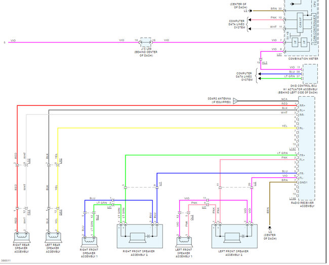

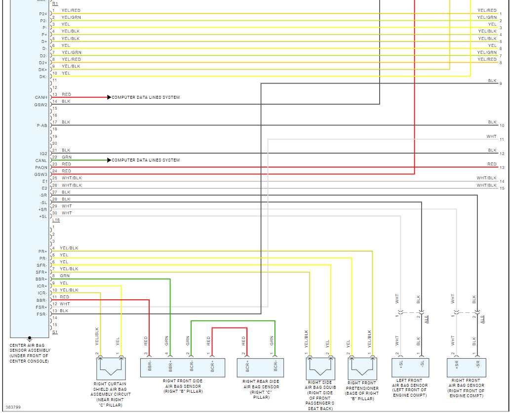

Sure, no problem, here are the wiring diagrams for the wipers, blinkers, airbags, and radio. Check out the images (below). Let us know if you need anything else.

Thank you Ken that helps. Would you possibly be able to help me out with the pin outs for those plugs? mainly the turn signal switch and the steering wheel controls
Apr 29, 2024 at 2:57 AM
  • 55,423 POSTS
Alldata does not offer connector views for these cars for some reason, sorry.
