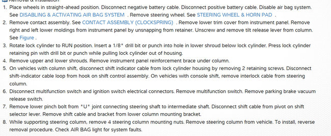

How do you drop the steering column on my car?
I have everything removed and disconnected but it is hung up on the left side on something that I cannot figure it out. I am trying to replace the upper steering column lock actuator and need to get the steering column housing out to work on it. Like I said, its hung up on the left side, seems like it needs to be tilted to be removed but even when that is done it is still stuck.

see picture for removal and install instructions. there are no pictures for this. it may be something else like a panel in way.
