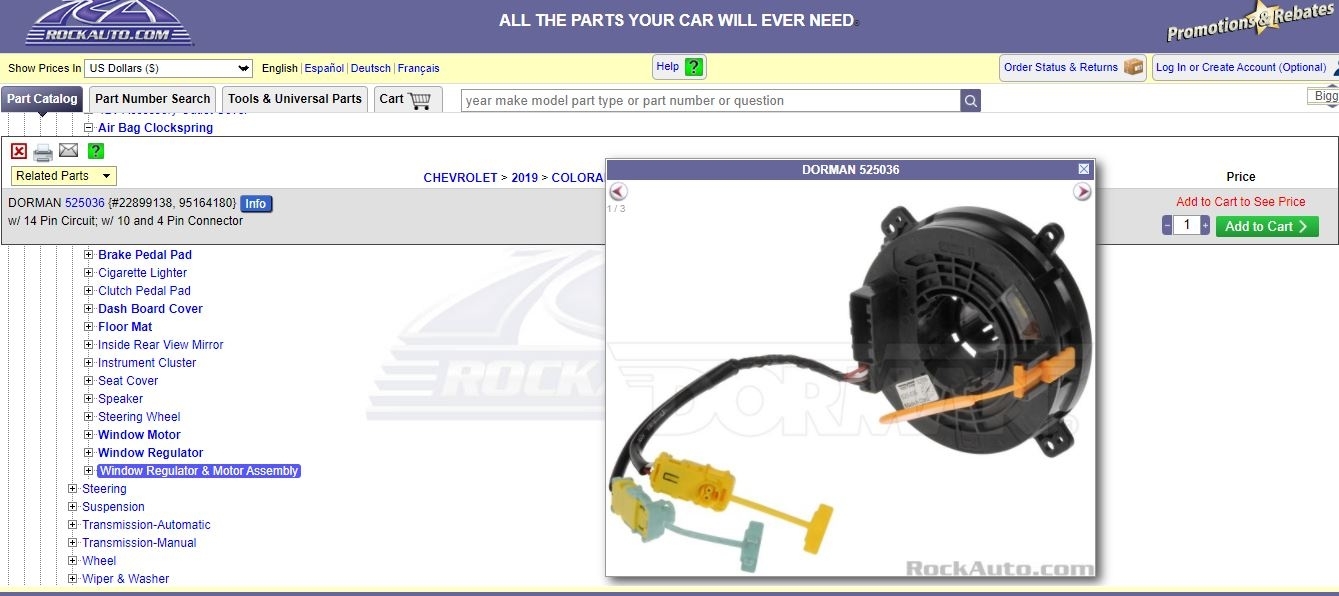

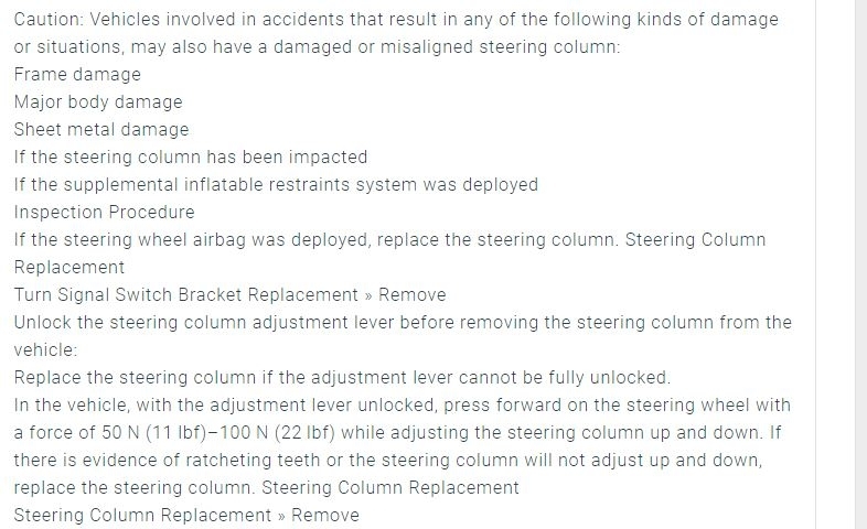

I am going to replace the non-telescoping steering column with one that telescopes.
I know exactly how to do this but it will entail removing and reinstalling the clock spring. If I buy a new clock spring it will come with a plastic immobilizing stop that pulls out after installation. I don't need to buy a new clock spring. I want to keep the clock spring I have because there is nothing wrong with it. How can I remove it and maintain it in a fixed position during the removal and reinstallation? Can I buy an immobilizing plastic insert like the kind that comes with a new clock spring or can I improvise and cut out and shape a piece of plastic and tape it in the hole to achieve immobility?
Jan 8, 2021 at 8:08 AM
Good evening,
The new one does come with a plastic lock to prevent it from turning too much.
https://www.2carpros.com/articles/steering-wheel-clock-spring-removal
I attached a picture of it for you to view. Dorman makes the clock spring and you can get it at any parts store or Rock Auto.
Jan 8, 2021 at 8:33 AM
STEPHEN T.
Hello Roy,
I know I can buy a whole new one from Dorman. I want to use my existent one and want to just buy just the plastic lock for it. Can I do so?
If you read my email carefully I said " I don't need to buy a new clock spring. I want to keep the clock spring I have because there is nothing wrong with it. How can I remove it and maintain it in a fixed position during the removal and reinstallation? Can I buy an immobilizing plastic insert like the kind that comes with a new clock spring or can I improvise and cut out and shape a piece of plastic and tape it in the hole to achieve immobility?
Best ,Steve T.
Jan 8, 2021 at 9:26 AM
The plastic piece is not available by itself. it is only available with the clock spring.
You can try to make one.
