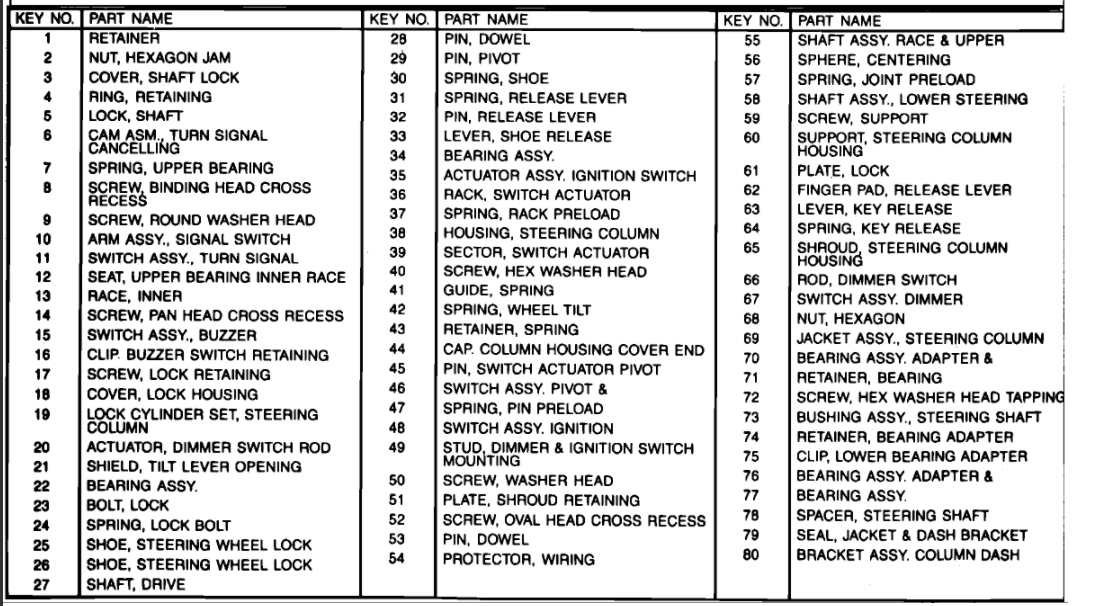

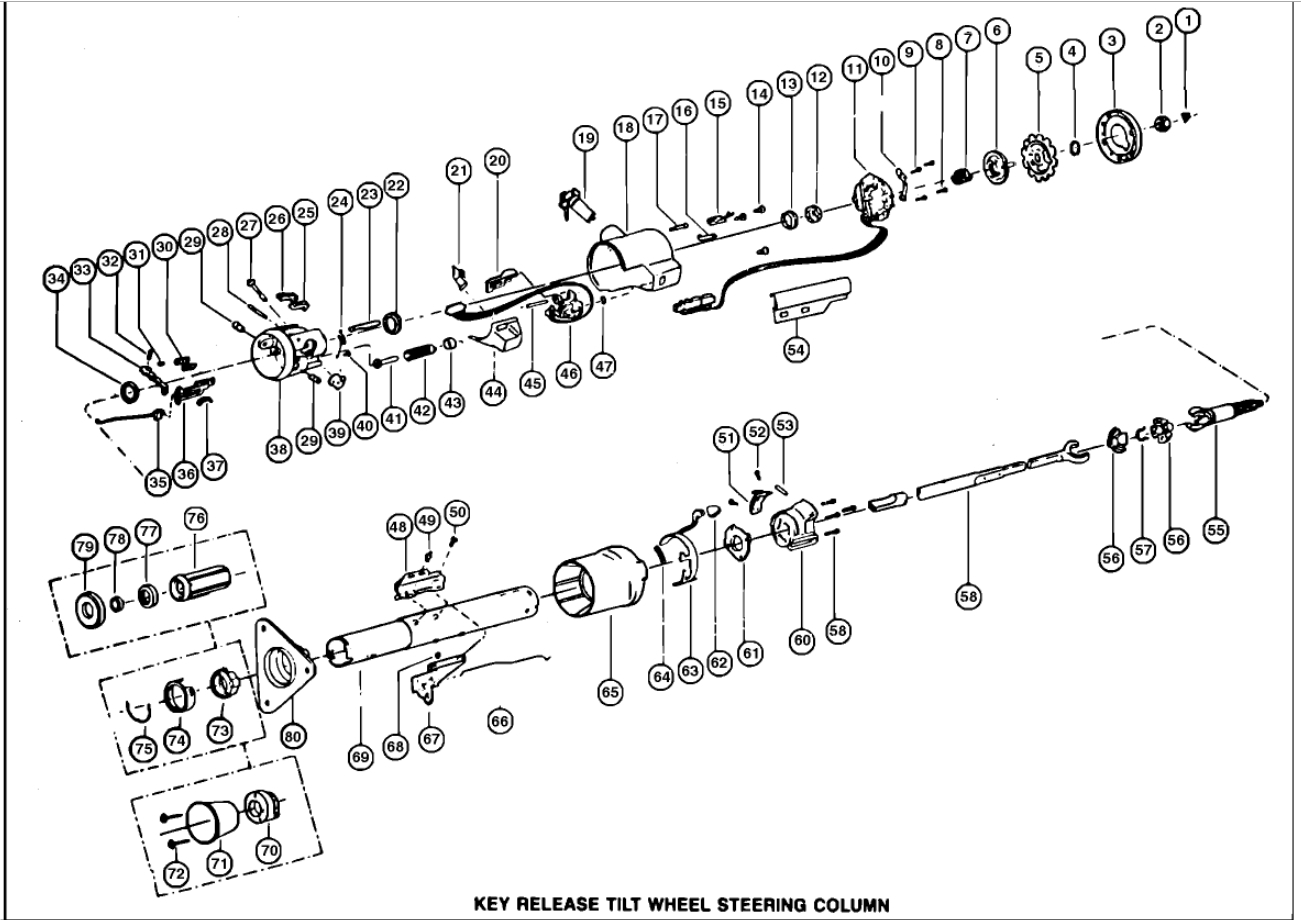

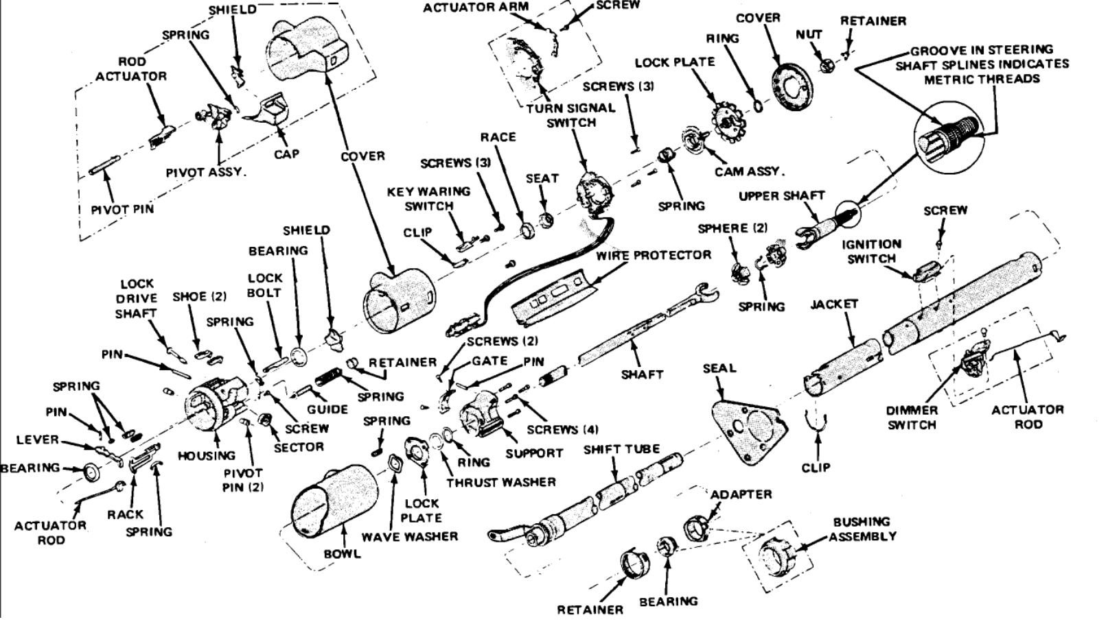

I am writing from France, so first of all forgive my English please! lol
So here is my problem: i have the car listed above it is the Royale model to restore by myself. This model has a tilt steering column.
I guess there is some missing parts, because the column moves at the steering wheel level.
Do you have a detailed diagram with all parts (even the little ones) so that i can check and rebuilt the whole column?
Thanks for your help!
Oct 17, 2017 at 7:36 PM
  • 55,694 POSTS
Yes there are many small parts and you may need a small pivot pin puller to remove the bowl.
Here is a diagrams (below) that will show you how it goes together:
