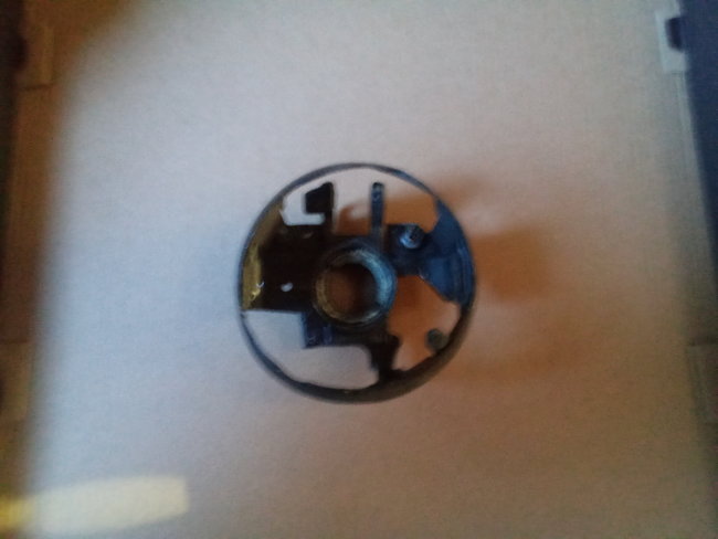

I just replaced my power steering pump and hoses, and when I went to start the truck, my key got jammed. so, I've replaced the starter switch activator before, so I assumed it broke again. I started taking the column apart, the small tip on my key switch had broken off, (easy fix) also the starter switch activator was intact, as I inspected everything, I noticed the tilt wheel flange was cracked in three places. So, I disassembled everything and pulled the flange out. now I'm faced with buying a whole used column or pray I can find a used flange (this part is discontinued by Ford). I found a flange for a cheap price of $185,000, sarcasm! So, now I have to wait 7-10 days for the part, I've pulled all the interior panels left and right under column, everything is apart waiting for that flange .my question is, will my truck start if I push on the starter switch rod? I have ordered a new switch (the one down on the column) but haven't replaced it. I did try it and the truck turned over, but I didn't hear the fuel pump and the truck didn't start.

The EECM (PCM) should not prevent the fuel pump from coming on if it is getting the signal from the ignition switch.
So, what the ignition switch needs to do is just send voltage to the EECM so that it knows a good key has turned the switch and the clutch is pressed or is in park or neutral. If these things are true then the EECM gets voltage on the ignition feed circuit, and it then sends power to the starter, ignition and fuel system.
So, if the engine is turning over then the EECM is seeing this signal from the switch circuit. If the fuel pump is not coming on, then we will have to figure out why the fuel pump is not coming on.
It is possible that this is caused by this not being assembled however, it is unlikely on this older truck.

Still waiting for part, but I was wondering. I have the dual tank switch on the dash disconnected for access to the starter switch, would that cause the fuel pump not to work?
Dec 13, 2021 at 9:56 AM
Absolutely it will. Great job mentioning that. Take a look at the wiring diagram.
The power runs directly from the fuse/relay to the inertia switch to the selector switch.
Let me know what happens when you hook that back up.

Yes it was that switch , had to buy a used column but I'm on the road again !
