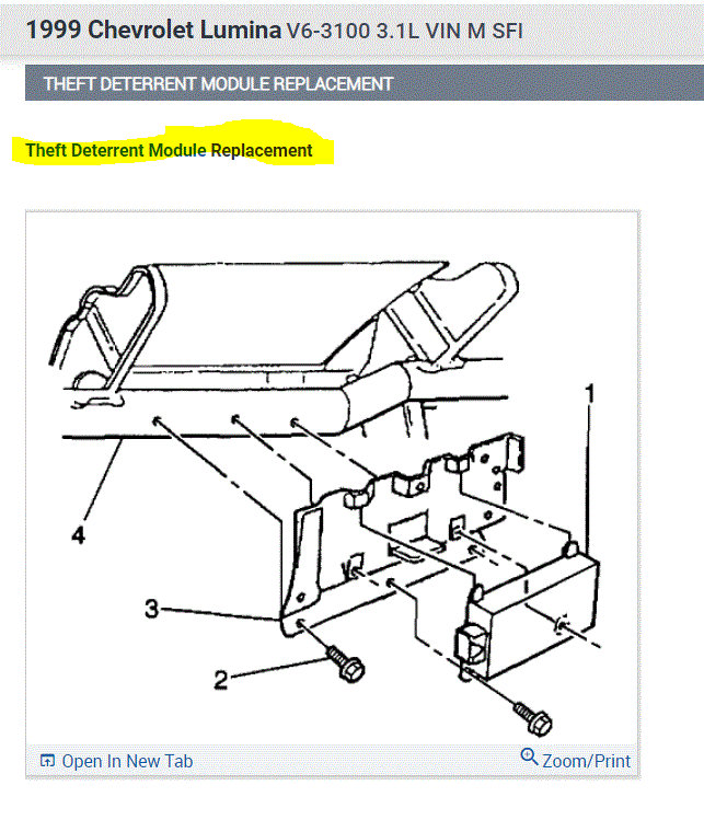

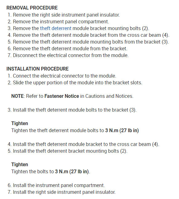

Also, did you use your old switch, key, and theft deterrent module? If not, you will have to get a new theft deterrent module. The theft deterrent module will learn the first key installed. To get a new lock cylinder and key without a theft deterrent module the dealer will have to get the key ID to match it up. Otherwise, a new theft deterrent module will be required.

I have a feeling that will need to be done. The one concern I have is the vehicle will not start when the theft light turns off (after 10 minutes). It should start. When you say an aftermarket alarm system was on the old one, I'm wondering if there is wiring that has been changed within the vehicle to accommodate the system. IS there any evidence of wires being spliced, cut, or anything you can see?
