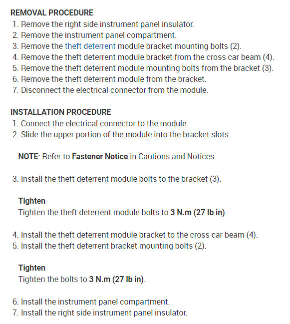

The steering column had broken where it tilts, so I located one at a junkyard, (was only at salvage yard for short time). I stripped it down and replaced ignition switch, turn signal switch and everything from broken column. I have to add that car has an aftermarket alarm and I did wire it back in. So I got it all put back together, turned key forward, everything works! Next I tried to start the car and nothing, again all lights, radio, heater/AC etc., work fine but starter did nothing. I tried cleaning the key and using the spare(have chip on key) i unplugged the computer and even tried the rest. I have tried every thing I know to do. never have had this much problems with a car. thank you very much.

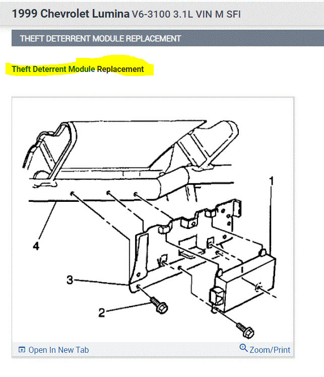

Mike,
When you turn the key to the start position, do the lights turn off on the dash? I'm just wondering if the switch is the issue.
Also, did you use your old switch, key, and theft deterrent module? If not, you will have to get a new theft deterrent module. The theft deterrent module will learn the first key installed. To get a new lock cylinder and key without a theft deterrent module the dealer will have to get the key ID to match it up. Otherwise, a new theft deterrent module will be required.
