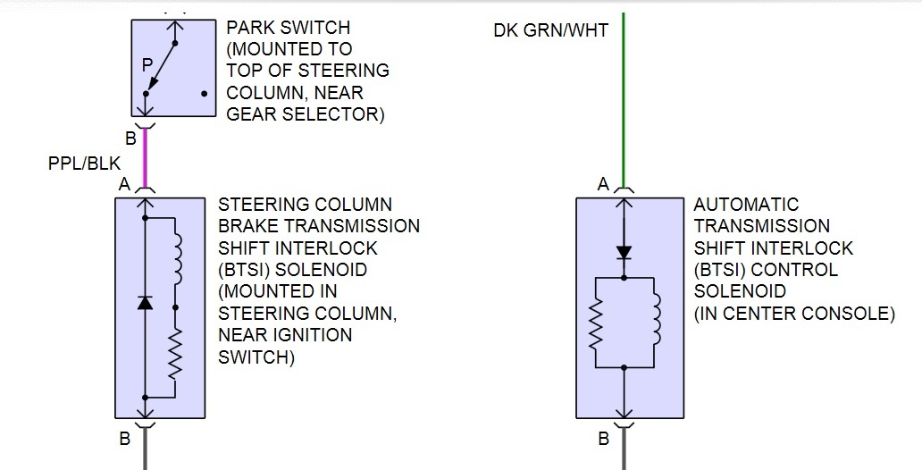

Changed steering column and now it won't come out of park once we bolted it up . It will move gear selection before we bolted it up
Jun 27, 2015 at 11:46 AM
JDL
  • 16,098 POSTS
I'd have to check shift interlock system. The replacement steering column is out of the exact same year--make--model?
Jun 28, 2015 at 2:08 AM
JDL
  • 16,098 POSTS
Just to add, no bind on the shifter or anything?
