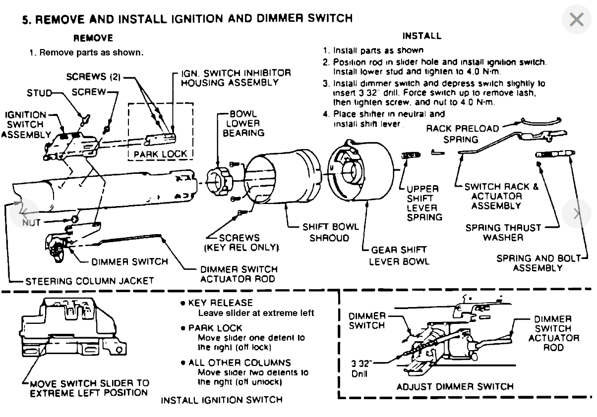

I want to change out my steering column and want to know what vehicle's steering column will fit my 1990. It doesn't have tilt and I would like to put tilt in if possible.

SQM
  • 6,383 POSTS

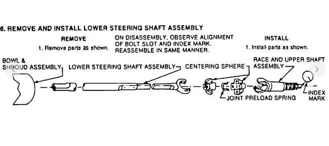

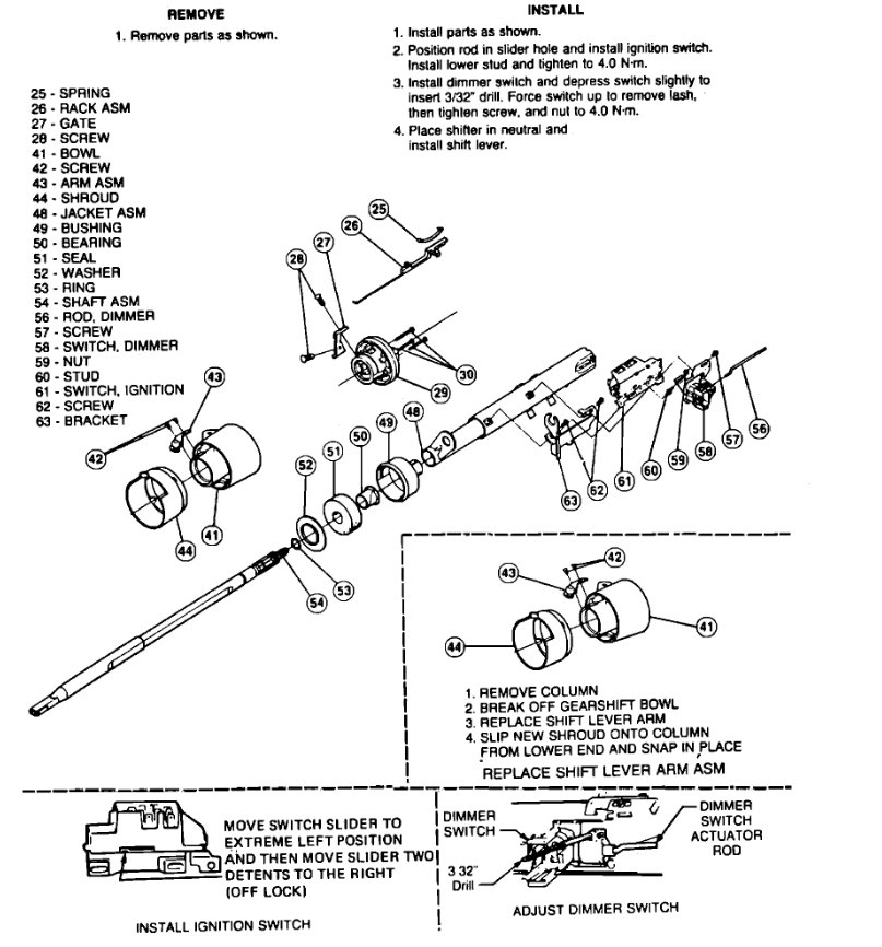

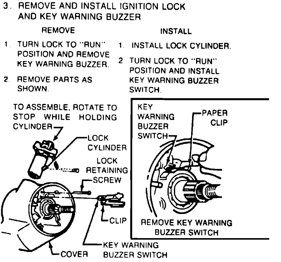

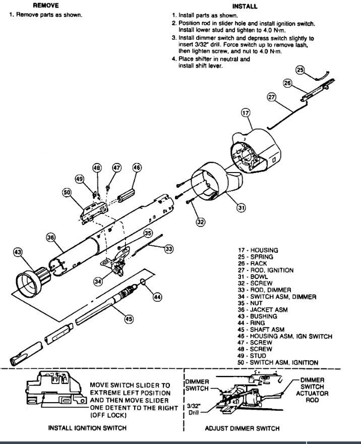

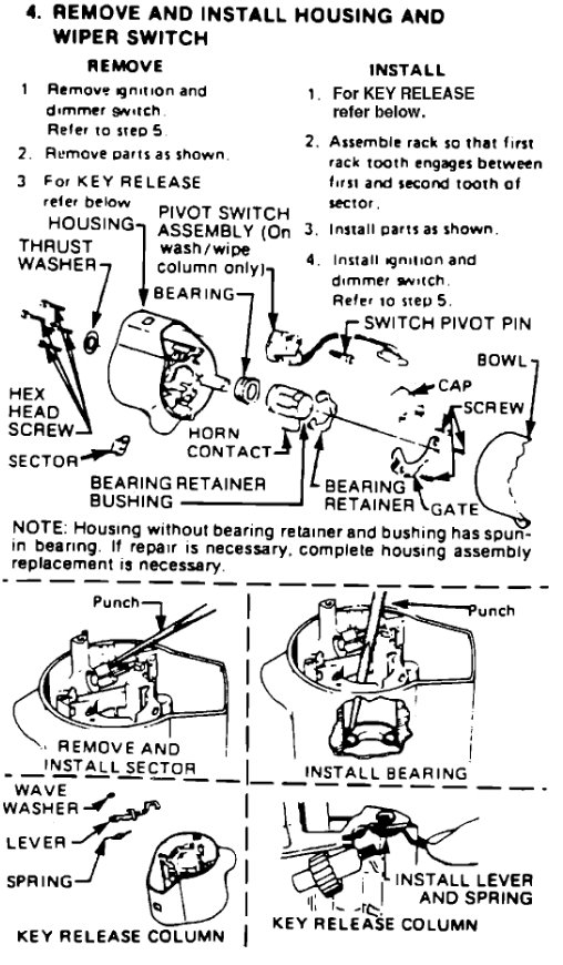

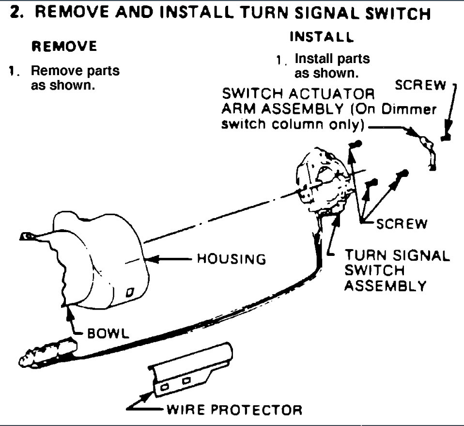

For the Cavaliers they use the same column (non-tilt) from 1990 to 1994 also the Pontiac Sunfire 1990 to 1994 uses the same steering column.
This is the OEM part number for the non-tilt column: 26003384.
I have attached the replacement procedure below.
Let me know of any questions.
https://www.2carpros.com/articles/steering-wheel-removal
