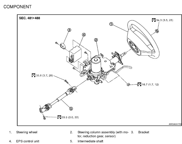

I got the steering column completely replaced at the dealership, but when I barely touch the steering wheel it rattles like loose change.

They must have given a warranty for their work? Sounds like they must have left something loose. I've attached a picture below of an exploded view of your vehicles steering column.Hope this helps and thanks for using 2CarPros.
