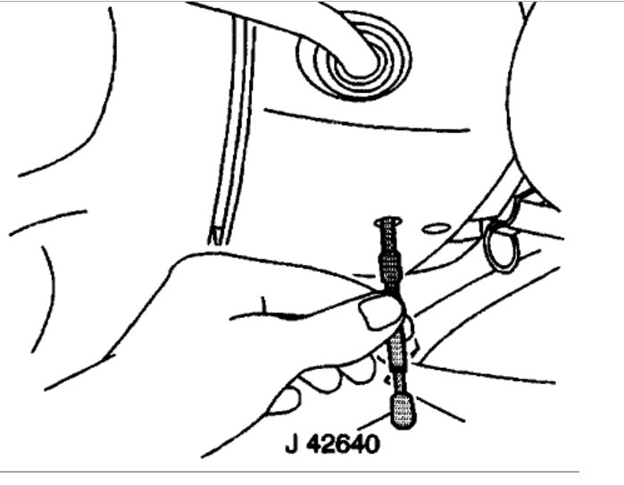

Notice: The front wheels of the vehicle must be maintained in the straight ahead position and the steering column must be in the LOCK position before disconnecting the steering column or intermediate shaft. Failure to follow these procedures will cause improper alignment of some components during installation and result in damage to the SIR coil assembly.

Lock the steering column through the access hole in the lower steering column trim cover using J42640.

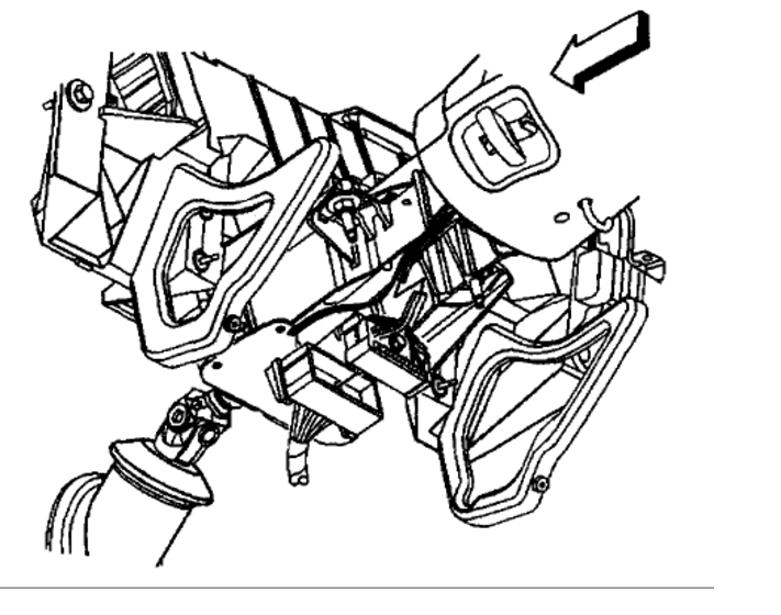

Disconnect the steering column electrical connector.
Disconnect the body wiring harness connector from the steering column lower bracket.

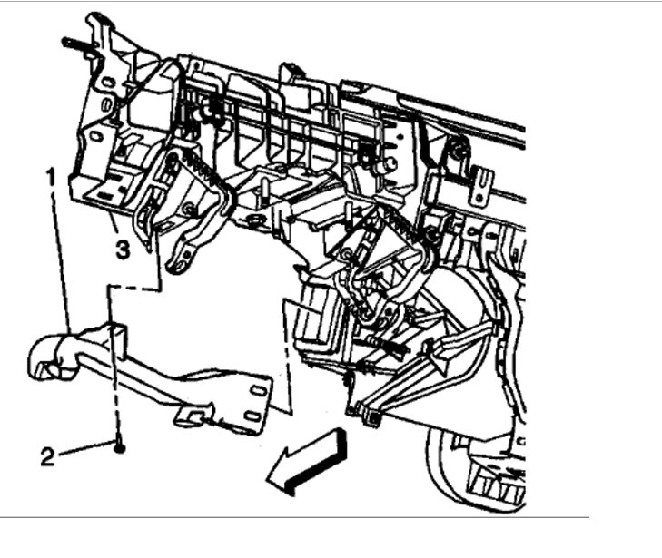

Remove the retaining screw (2) from the left HVAC floor duct (1).
Disconnect the left HVAC floor duct temperature sensor and remove the left HVAC floor duct.

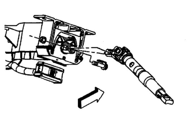

Remove the intermediate shaft bolt from the steering column.

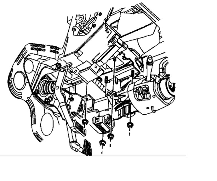

Remove the steering column mounting nuts.
Remove the steering column from the vehicle.

Install the steering column to the vehicle and connect the column to the intermediate shaft.

Install the steering column mounting nuts. Tighten the nuts to 27 Nm (20 ft. lbs.).
Install the intermediate shaft bolt to the steering column. Tighten the bolt to 50 Nm (37 ft. lbs.).
Connect the left HVAC floor duct temperature sensor and install the left HVAC floor duct (1).
Install the mounting screw (2) to the left HVAC floor duct. Tighten the screw to 1.9 Nm (17 inch lbs.).
Connect the body wiring harness connector to the steering column lower bracket.
Connect the steering column electrical connector to the vehicle wiring harness. Tighten the screw to 6 Nm (53 ft. lbs.).

Unlock the steering column by removing J42640 from the lower trim cover access hole.
