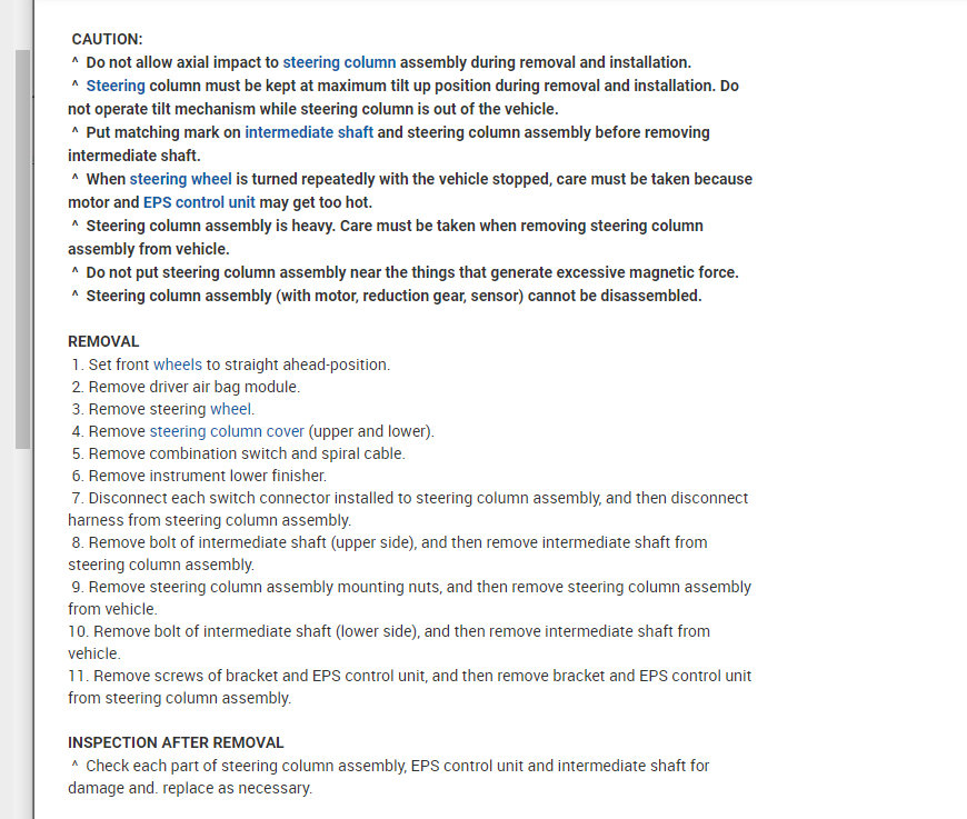

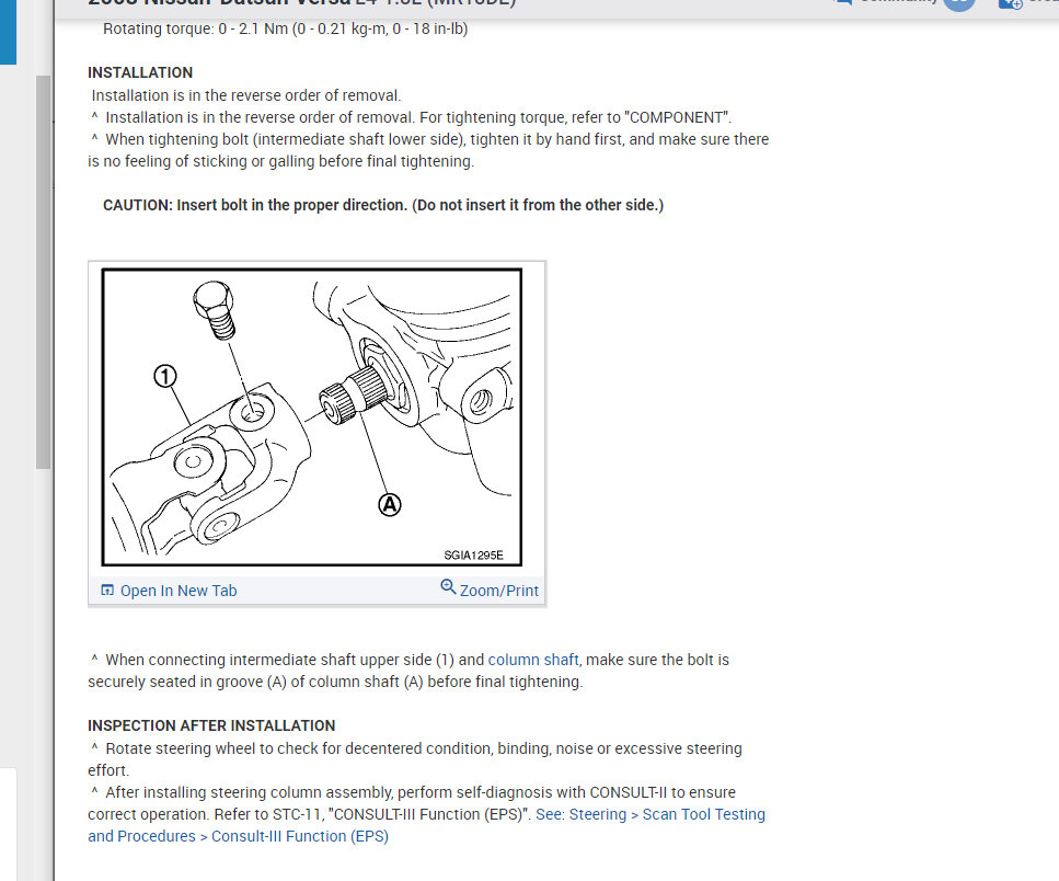

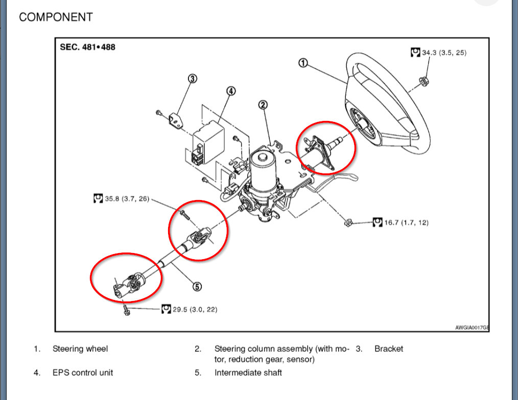

I think you are exactly correct. If you feel a single clunk in either direction then the way to confirm it would be to remove the load from the front tires and if the clunk is still there then it is the intermediate shaft.
Basically once these are worn then the break away torque causes a clunk and then once it is spinning it is okay. This will only get work and more than likely you will start feeling it more frequently.
I am attaching the process below from the manual on a Versa which is basically the same vehicle. Unfortunately we don't have a manual on this specific vehicle just because it is not offered here in the USA but again, the Versa is the same unit.
Please run through this material and let us know if you have other questions. Thanks
