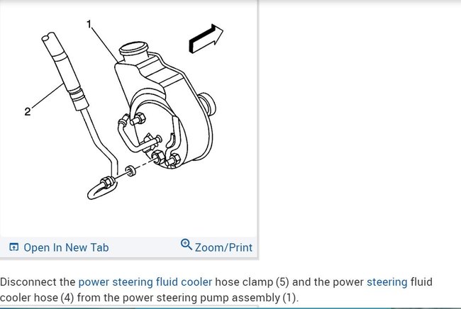

The truck listed above is a 2500 hd. no power steering no power brakes. Replaced Hydro boost no change. No leaks no noise from either Hydro boost or power steering pump.
Jun 14, 2022 at 10:18 PM
Good evening,

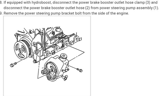

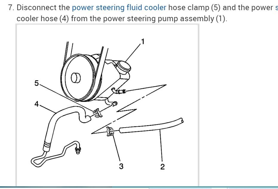

This sounds like the pump has stopped working.
https://www.2carpros.com/articles/how-to-replace-a-power-steering-pump
https://www.2carpros.com/articles/power-steering-fluid-flush
You need around 800 pounds of pressure from the pump in order for it to work.
You can rent gauges from a parts store if you don't have another set.
