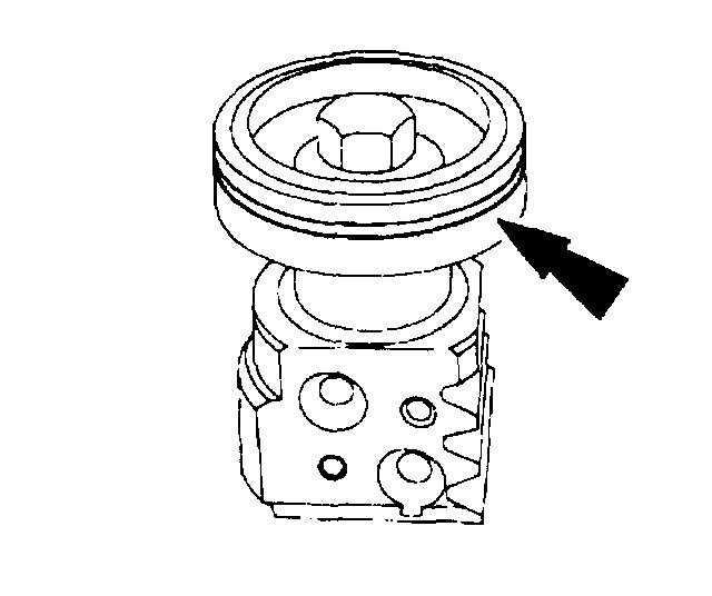

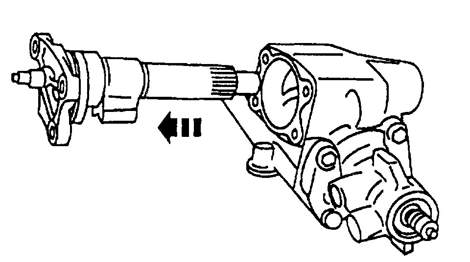

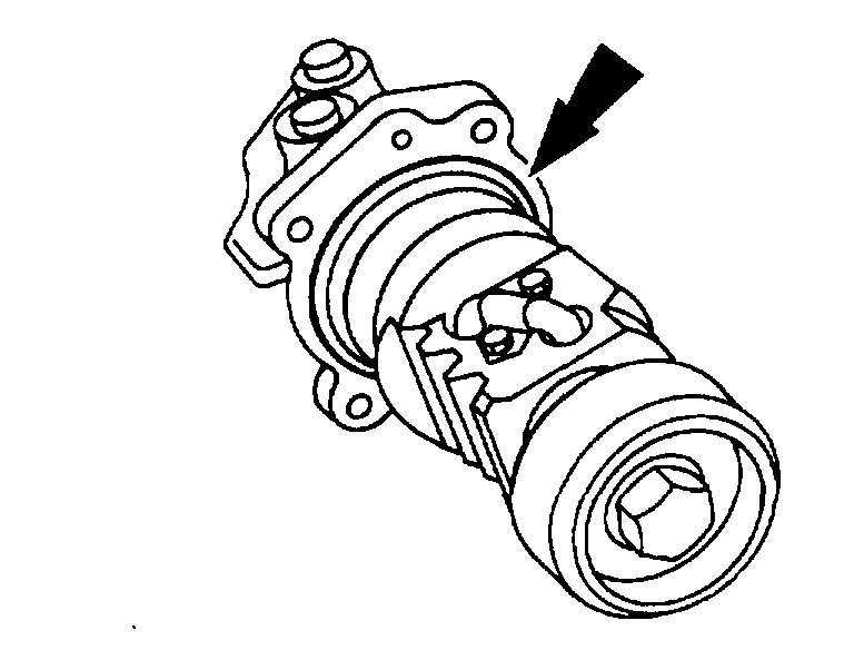

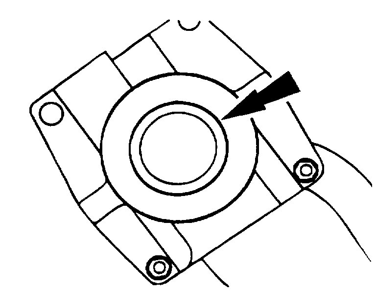

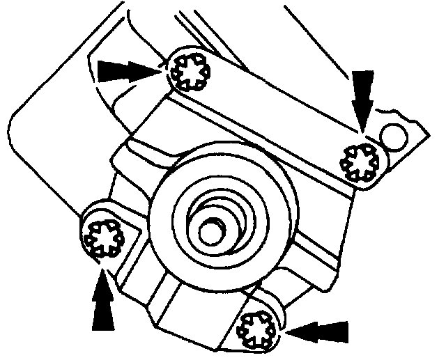

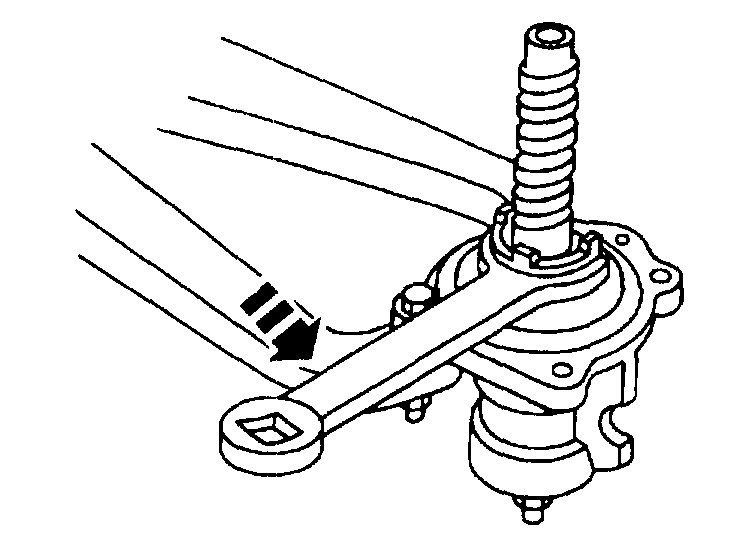

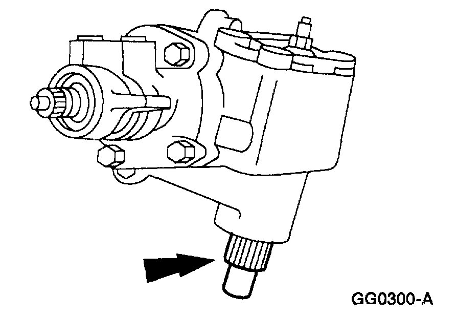

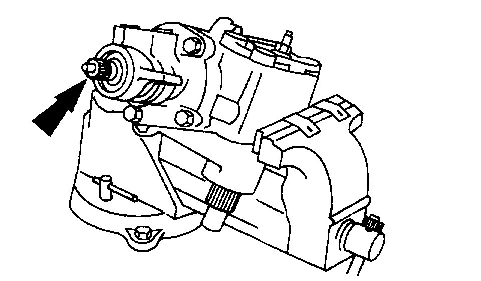

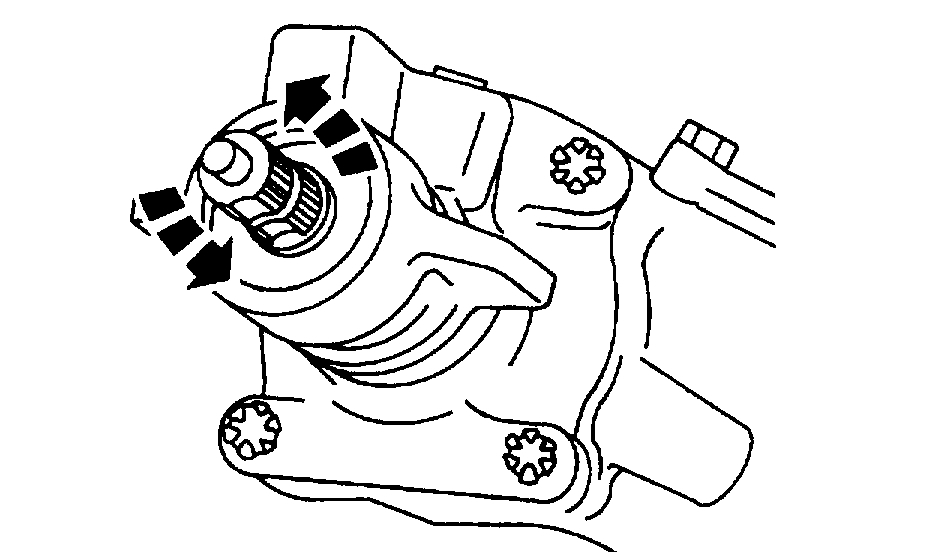

My steering box is leaking at the out put shaft for the steering arm. Can this be fixed with a seal? Or do I get a used one at junk yard?
May 5, 2019 at 3:30 AM
  • 110,236 POSTS

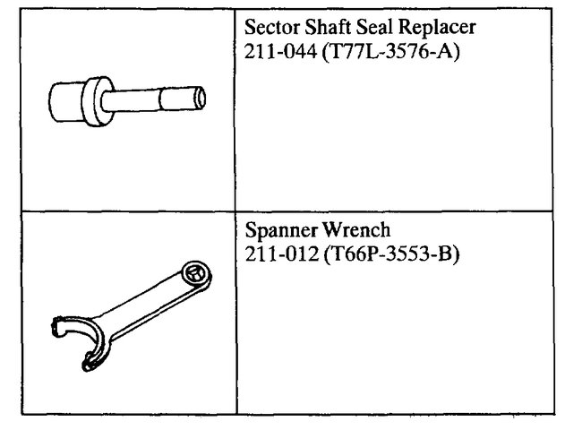

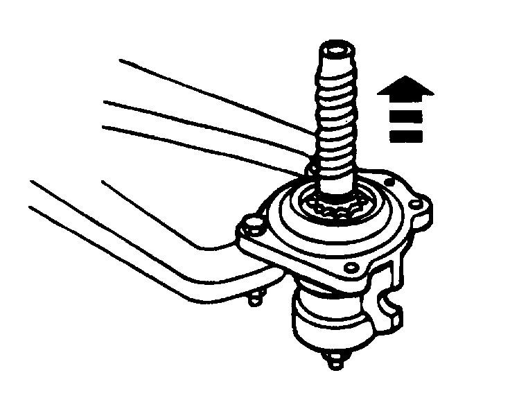

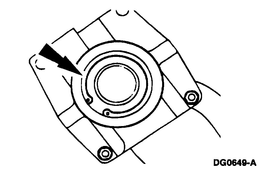

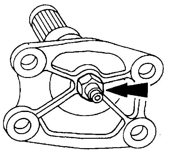

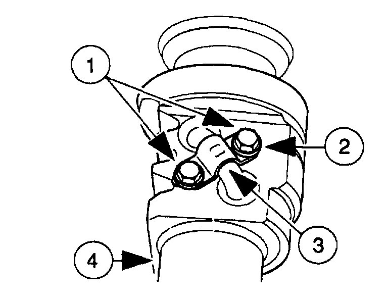

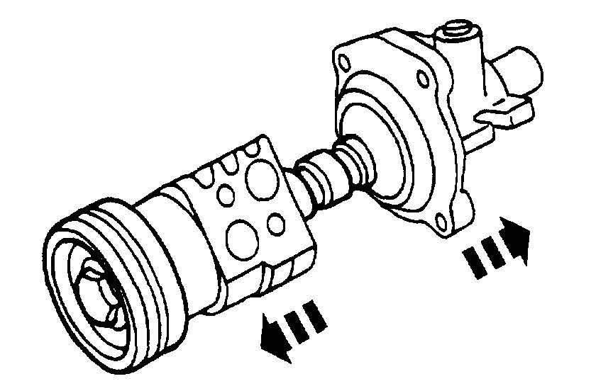

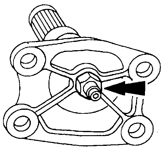

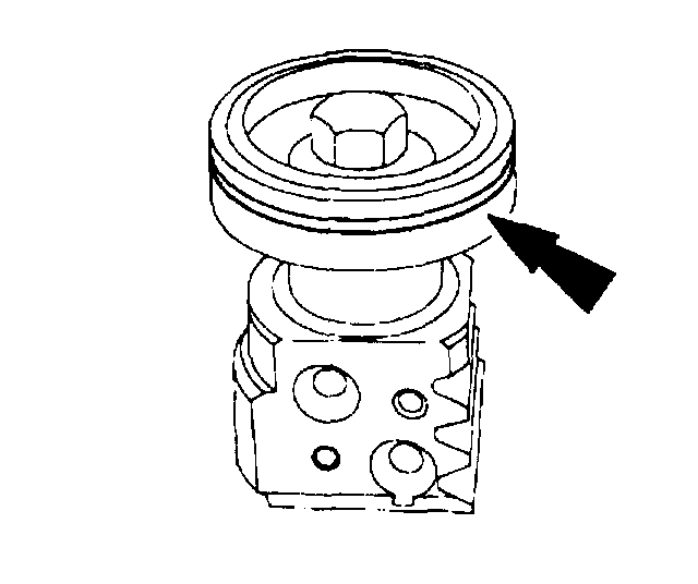

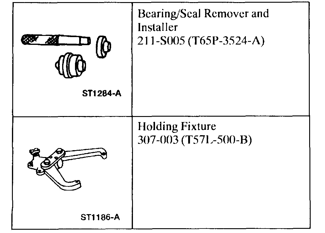

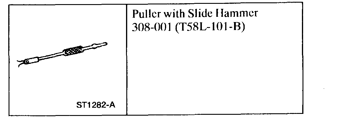

Chances are it can, but there could also be an issue with o-rings and seals. Also, excessive wear on the output shaft can cause the leak. With that in mind, I am going to provide the complete overhaul directions and pics to help. I hate to say it, but it would be a lot easier to get a new one. LOL Regardless, here are the directions which include the replacement of all seals. The attached pics correlate with the directions. Check out the diagrams (Below). Please let us know what happens.
Disassembly
Note: The steering gear input shaft and seals cannot be repaired or replaced separately. Gear replacement may be necessary.
1. Secure the steering gear in a vise with the indexing flat pointed down. Use protective caps on the vise jaws.
2. Rotate the power steering gear input shaft and control from stop to stop and then center the gear.

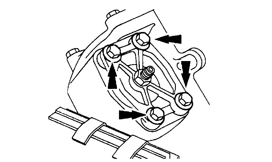

3. Remove the steering gear sector shaft housing cover bolts.
4. Tap on the lower end of the steering gear sector shaft.
5. Remove the steering gear sector shaft.

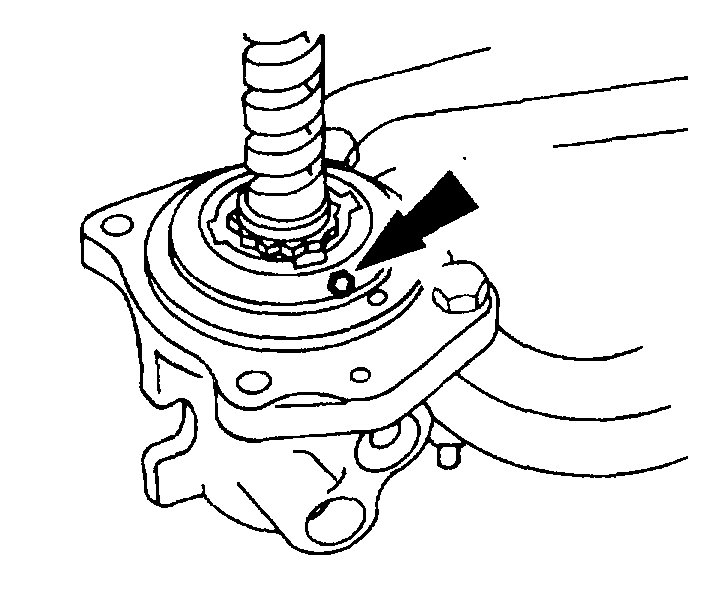

6. Remove the locking nut from the steering gear sector shaft adjustment screw.
7. Remove the sector shaft housing cover.
^ Hold the steering gear sector shaft.
^ Turn the housing cover counterclockwise.

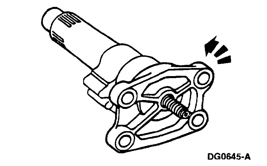

8. Remove the valve housing bolts and the identification tag.

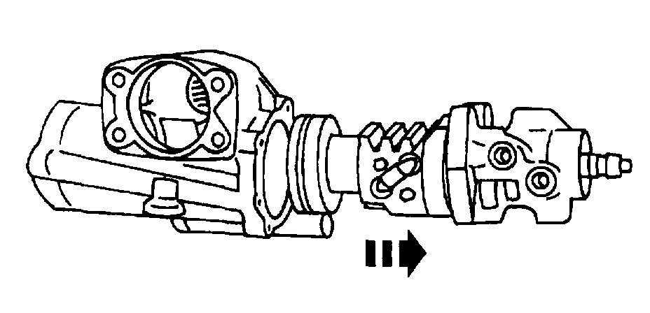

9. Remove the valve housing and piston assembly.
10. Remove and discard the gasket.
11. Remove the ball bearings.
1 Remove the bolts.
2 Remove the steering gear ball return guide clamp.
3 Remove the steering gear ball return guide.
4 Rotate the piston over a container to collect the 28 steering gear worm balls.
12. Remove the input shaft valve and housing assembly from the piston.
13. Remove and discard the seal.
14. Install the valve housing in the Bench Mounted Holding Fixture and loosen the setscrew.
15. Use Adjuster and Locknut Wrench to remove the race nut.
16. Remove the power steering gear input shaft and control from the valve housing.

19. Remove the input shaft snap ring.
20. Rotate the valve housing with the Bench Mounted Holding Fixture, and use the Input Shaft Bearing/Seal Tool to remove the bearing and power steering gear input shaft seal.

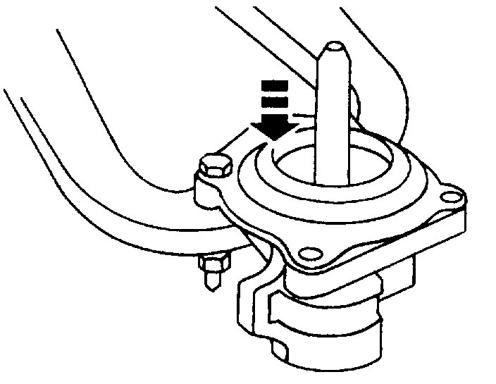

22. Install the steering gear housing in the Bench Mounted Holding Fixture and remove the steering gear sector shaft dust seal from the sector shaft seal bore.
23. Remove the spacer.
1 Remove the snap ring.
2 Remove the spacer.
24. Note: The steering gear sector shaft bearing is not replaceable.
Use the Puller to remove the sector shaft seal.
Assembly
1. Lubricate the sector shaft seal bore.
^ Use Multipurpose Grease D0AZ-19584-AA or equivalent meeting Ford specifications ESB-M1C93-B and ESR-M1C159-A.
2. Use the Sector Shaft Seal Replacer to install the sector shaft seal.
^ Lubricate the sector shaft seal, using Multipurpose Grease DOAZ-19584-AA or equivalent meeting Ford specifications ESB-M1C93-B and ESR-M1C159-A.

19. Install the steering gear ball return guide clamp.
1 Position the steering gear ball return guide clamp.
2 Install the bolts.
