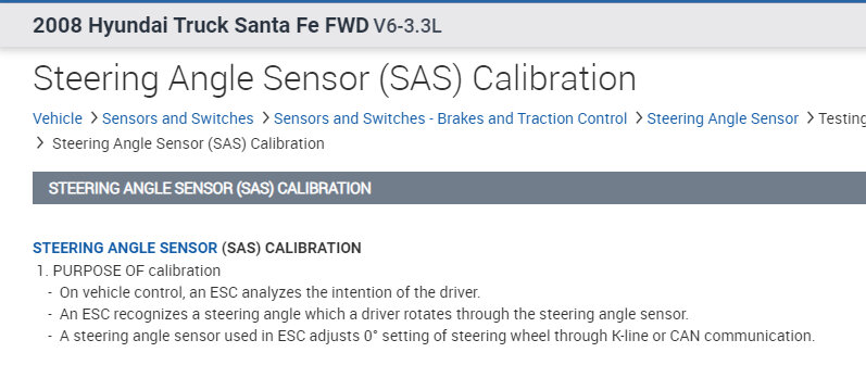

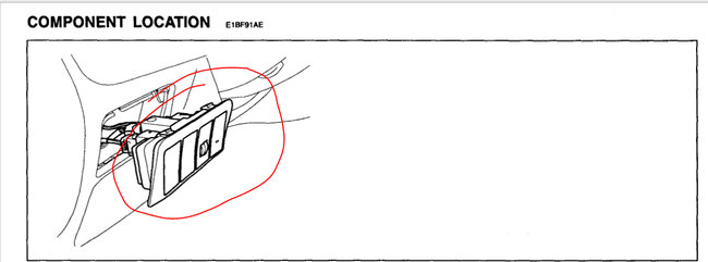

I agree with you. The steering angle sensor can be recalibrated. Also, as far as the ESC off light is concerned, are you sure it wasn't turned off by the switch? I believe it is in the center of the dash. (See pic 1 below) If you already checked, what happens when you turn it on? Keep in mind, the ESC depends heavily on the steering angle sensor, so calibration may be the cause.

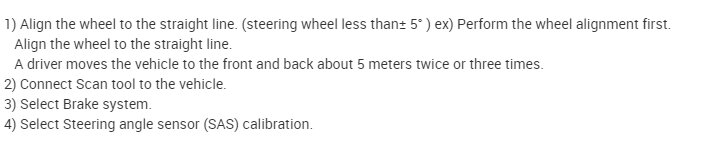

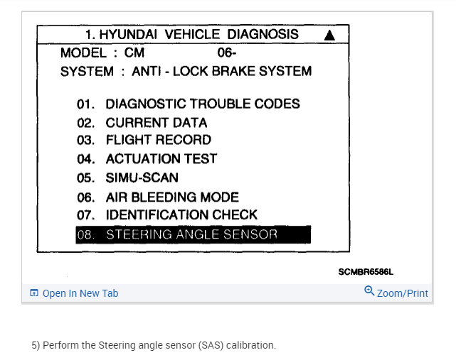

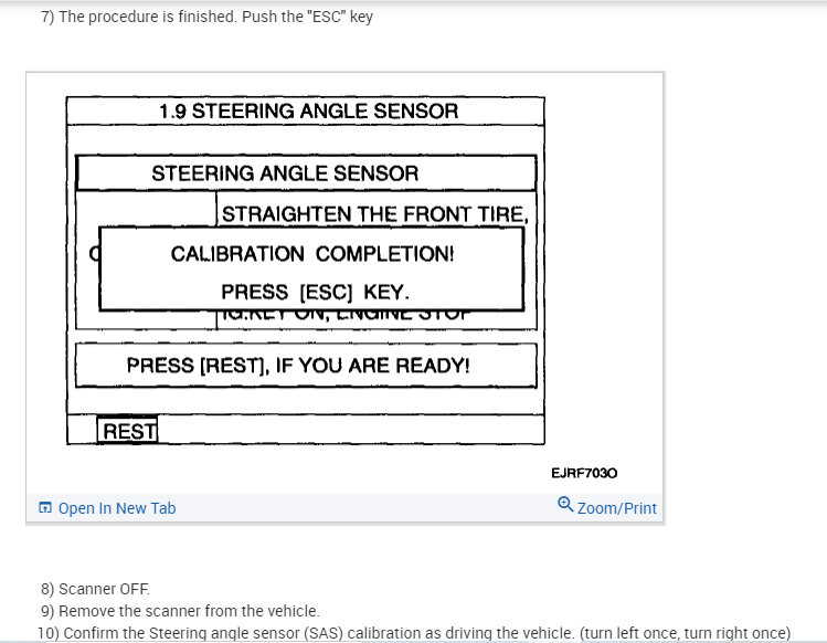

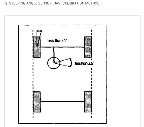

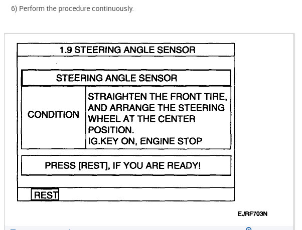

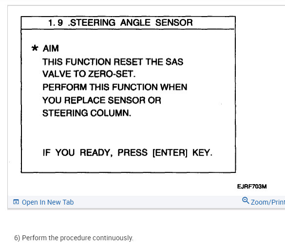

As far as recalibrating the angle sensor, I attached the directions below, but you will need a scan tool that can perform the procedure and the vehicle should be on an alignment rack to ensure the wheels are straight. If I recall, they had to take the lower steering shaft off the rack to remove it. So, I have a feeling it just needs to be calibrated.

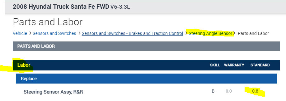

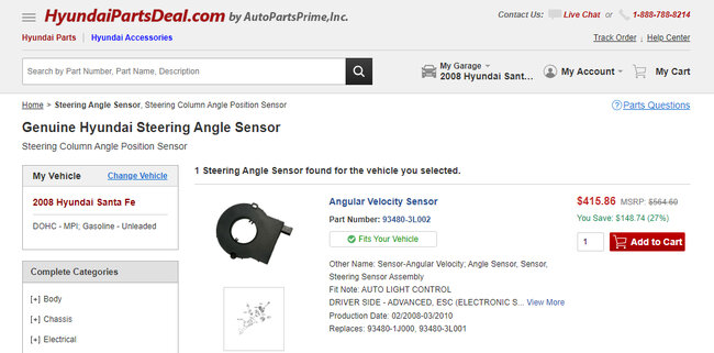

I certainly recommend taking it somewhere other. The labor time is 0.8 hour (less than an hour). So, either he charges $600.00 an hour or is taking advantage. See pic below.
Also, the sensor's retail price is $564.00 (see pic 2) It seems you are paying for the sensor, and he is taking 50 minutes to install it. Note the price shown in pic 2 is for an OEM part. It's likely you can get an aftermarket one for much less.
