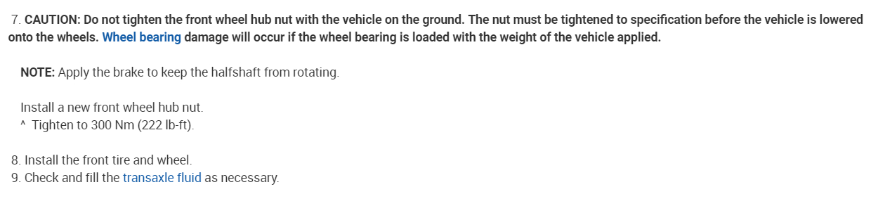

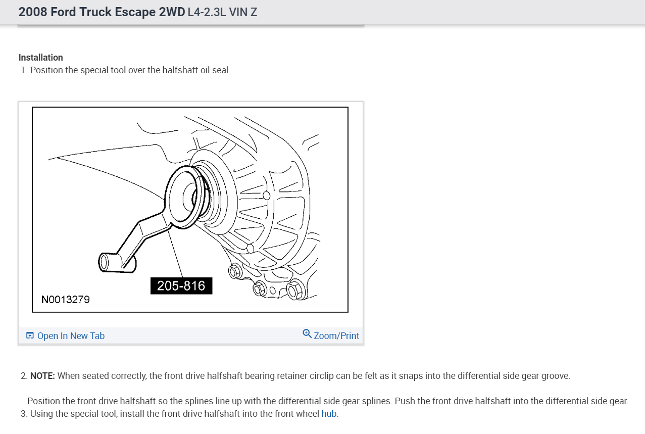

I have lots of noise especially when turning the wheels tight and I get a funny noise and feeling when putting on the brakes.
Dec 16, 2018 at 3:22 AM
  • 55,721 POSTS

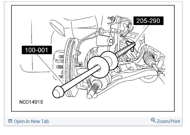

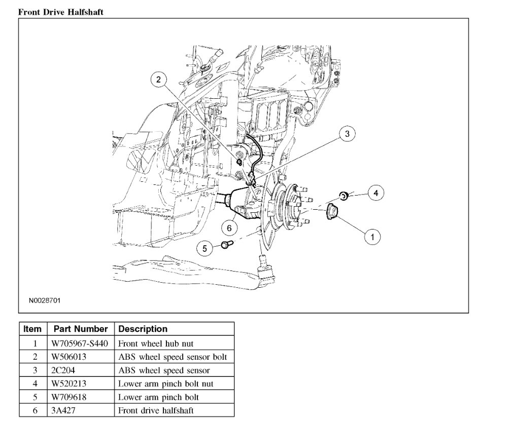

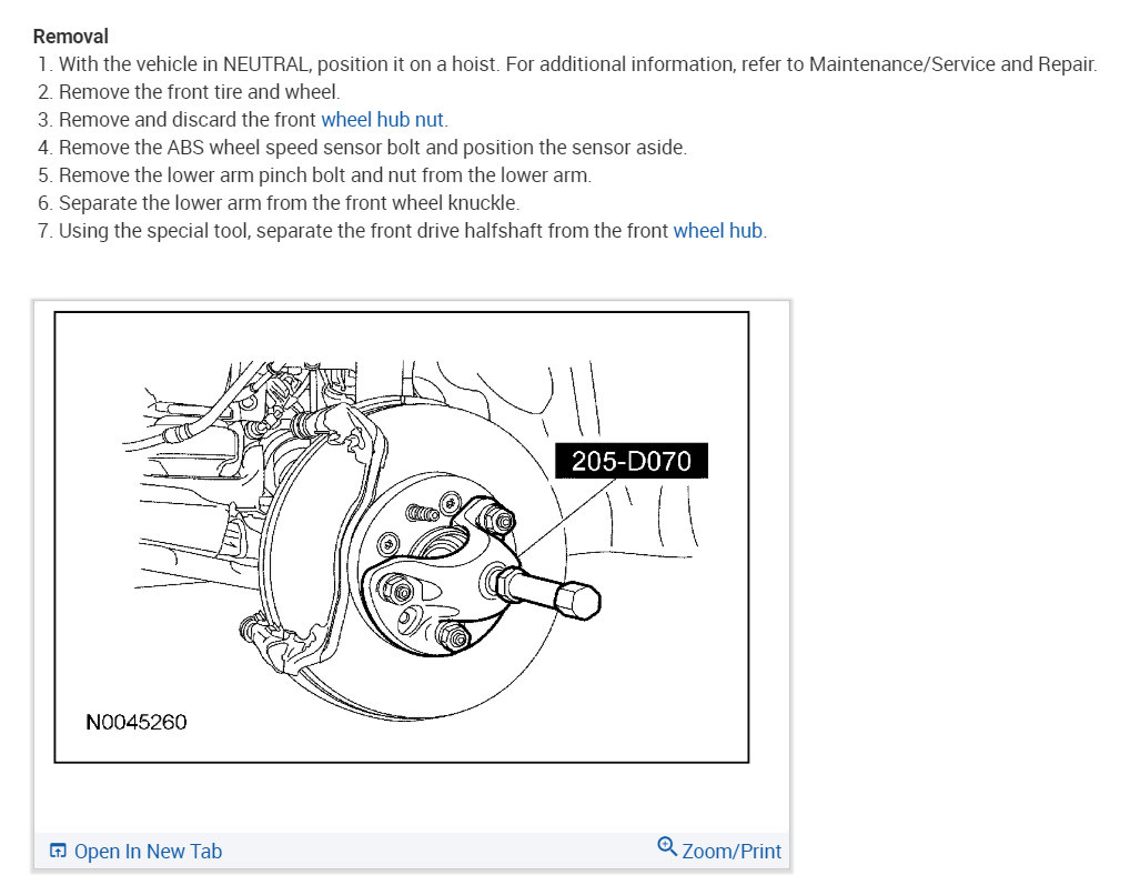

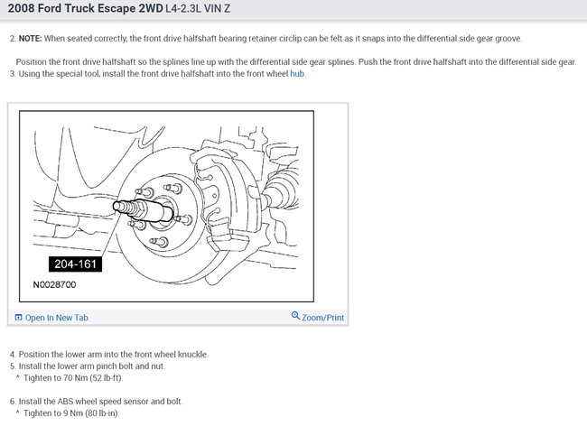

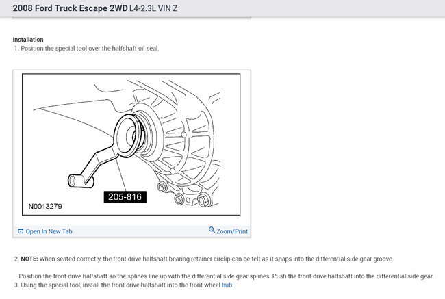

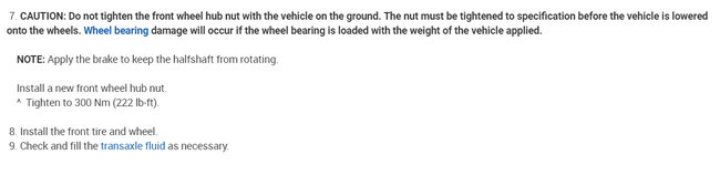

This is typical of CV axles that are worn out and need to be replaced. here is a guide to help walk you through the steps and diagrams below to show you on your car:
https://www.2carpros.com/articles/replace-cv-axle
