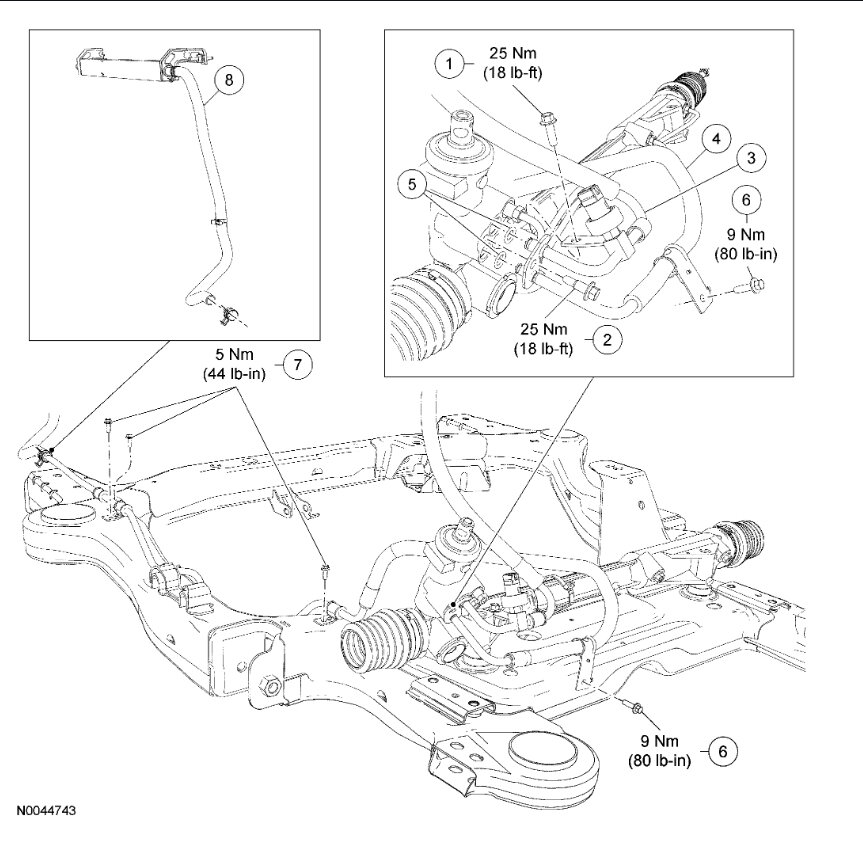

I need to change the hose that goes from the reservoir to the power steering pump. What is that hose called? It is maybe 5 to 6 inches, and it curves.

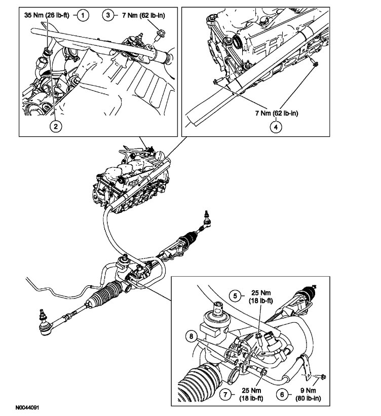

These are the two power steering hose names:
Power Steering Pump to Steering Gear Pressure Line
Steering Gear to Fluid Cooler Return Hose
Please upload a picture of what you are talking about. Check out the images (below).
