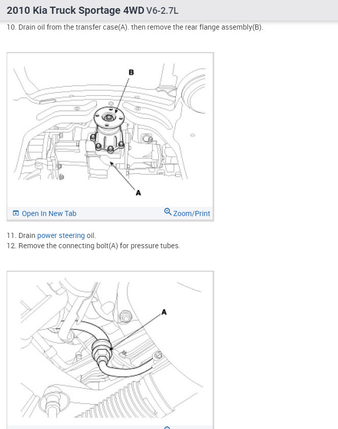

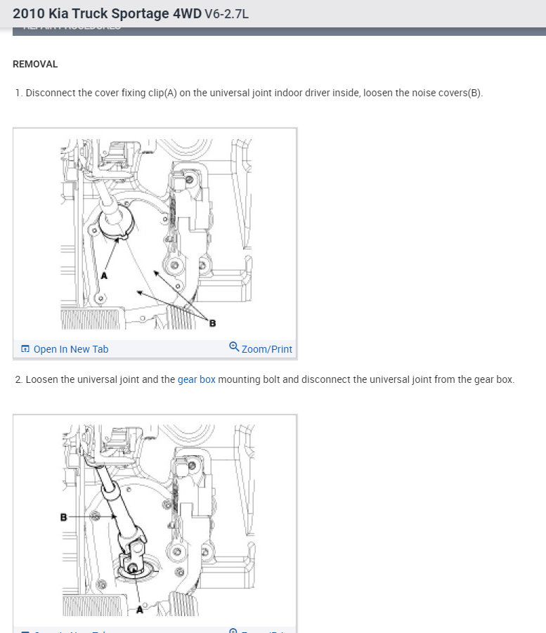

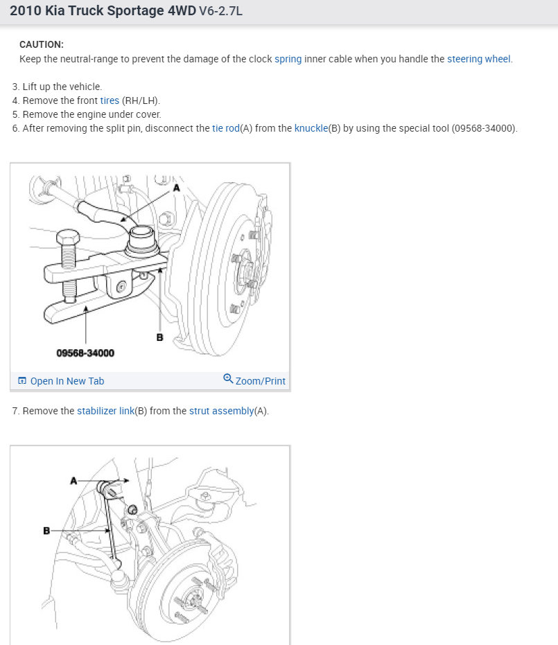

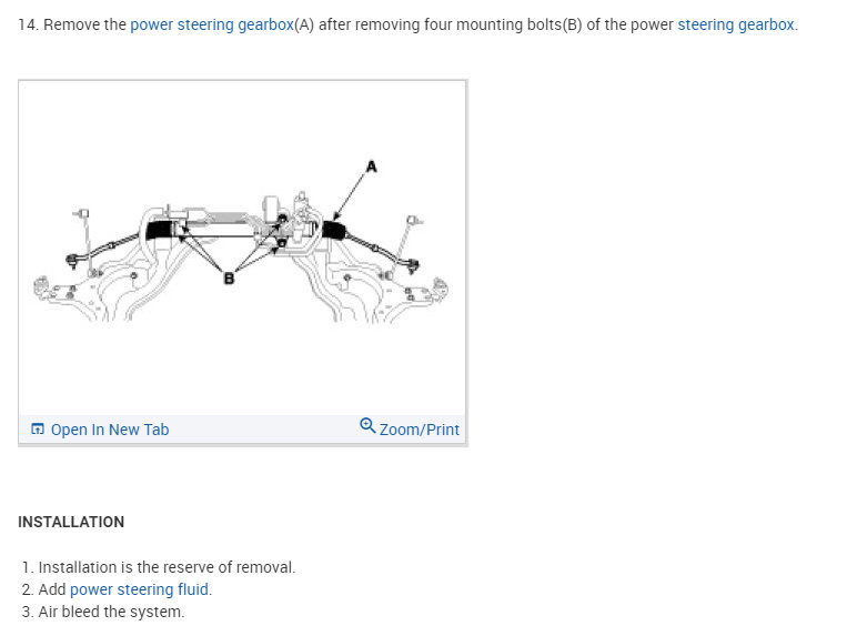

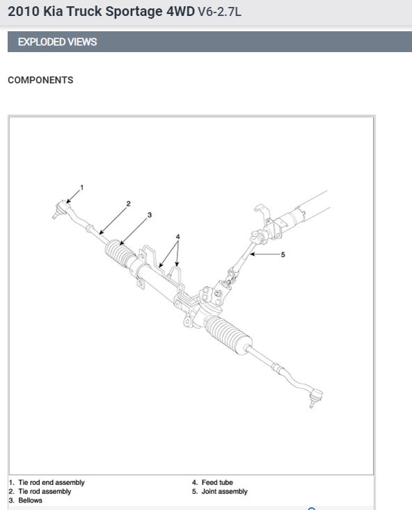

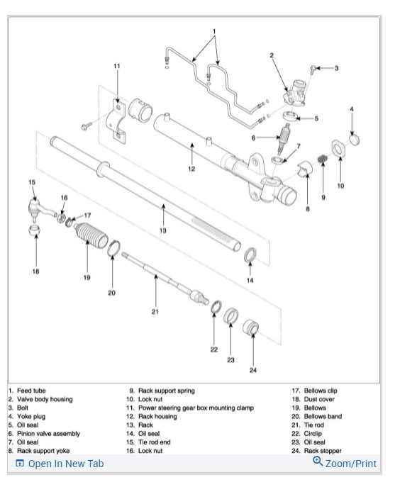

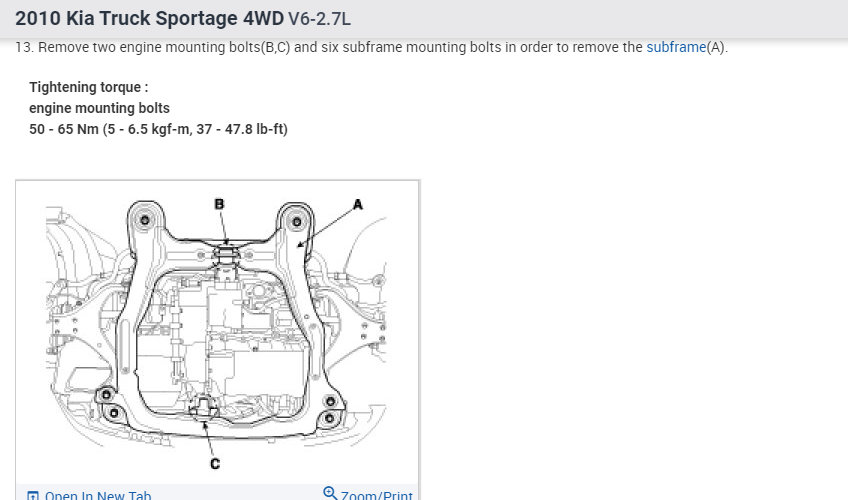

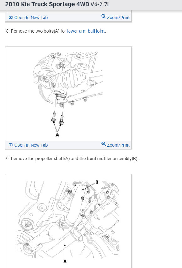

I have taken my Kia Sportage to get an alignment after replacing inner and outer tie rods on the driver side. I’m now being told that the steering rack is damaged and needs to be replaced. I already know that it will be too expensive and I can’t afford it. I’ve watched videos on how to remove the steering rack but not having much luck finding one for Kia Sportage 2010 lx 2.7l. Any idea where I might find info on how to replace the steering rack? Thanks, Rich
Mar 5, 2022 at 3:23 AM
SQM
  • 6,383 POSTS
Hey Rich, I have attached the steering rack replacement procedure below. It does require removing the subframe to get out.
Let me know of any questions.
Mar 5, 2022 at 10:00 AM
RICH NORBY
  • 30 POSTS

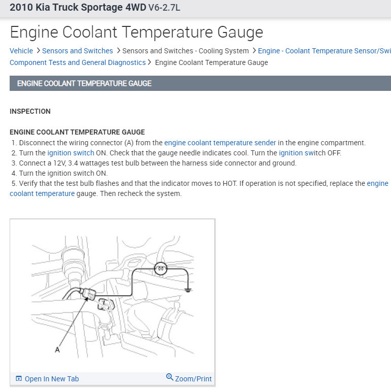

Hey Sean, I was able to remove and replace the steering rack on the 2010 Kia Sportage without removing the sub frame. I removed the air filter box and hoses to get to the rear motor mount bolt. I jacked the engine up just enough to take pressure off the bolt to remove it. Then raised the engine high enough to be able to reach the rack bolts. The top bolts were the toughest to reach. Used a shallow #17 mm socket and a cut off 3/4 bolt with the end squared off to to fit into the socket, then used a 3/4 in. open end wrench to remove the bolts. I also had to unbolt the exhaust pipe from the manifold to get room to get to the passenger side bracket. Interesting project but glad it’s done. Also had an alignment done all is good . Now I’m trying to figure out how to in stall a temperature gauge since the car only has a idiot light. Any suggestions on where I would put a sensor? Thanks again for your help .

For the temperature gauge, many of these vehicles come with a digital temperature readout that can be accessed by going through the display on the gauge cluster. Do you not have that option?
Mar 20, 2022 at 4:17 PM
RICH NORBY
  • 30 POSTS
I don’t think so, the car is basically just warning lights. I was wondering if there would be somewhere on the engine that I could install a temperature sensor and install a wire to a gauge.
Mar 21, 2022 at 3:20 AM
SQM
  • 6,383 POSTS
You might be able to tap onto the existing temperature sensor and have it hooked up to a gauge.
