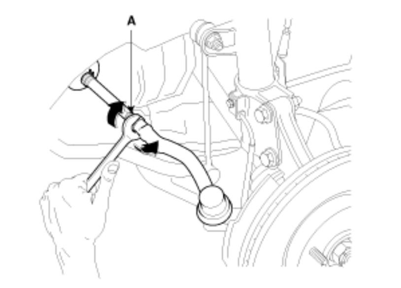

While driving straight the steering wheel pulls but wheels don't. it's like the steering wheel is going to the left a touch but wheels don't.

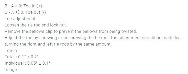

If the front end is pulling, it could be the result of alignment. You need to have the alignment checked to see if the geometry angles are within spec.

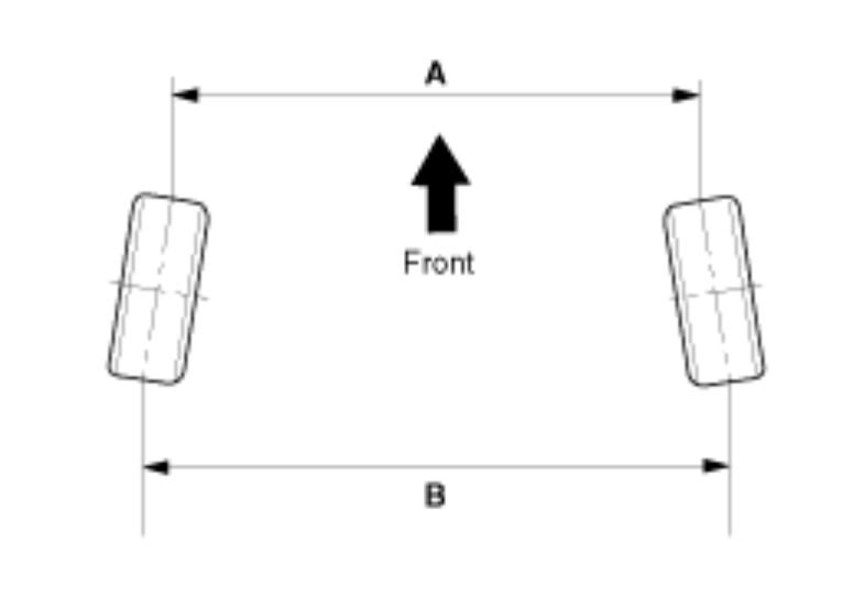

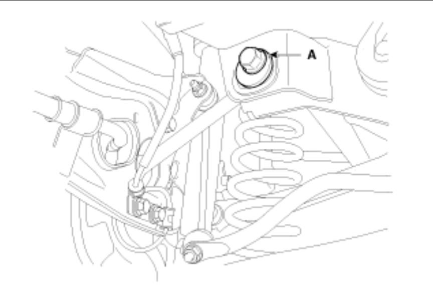

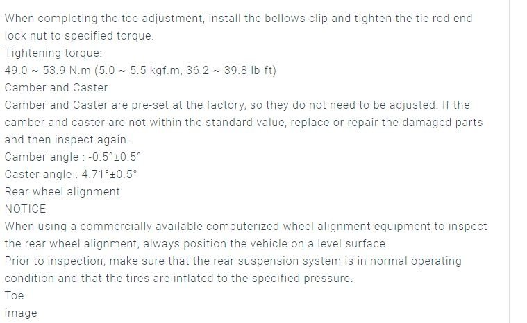

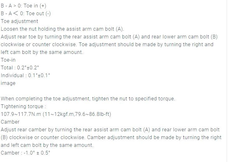

TUCSON(TL) 2016 G 1.6 T-GDI Suspension System
Front wheel alignment
NOTICE
When using a commercially available computerized wheel alignment equipment to inspect the front wheel alignment, always position the vehicle on a level surface with the front wheels facing straight ahead.
Prior to inspection, make sure that the front suspension and steering system are in normal operating condition and that the tires are inflated to the specified pressure.
Toe
