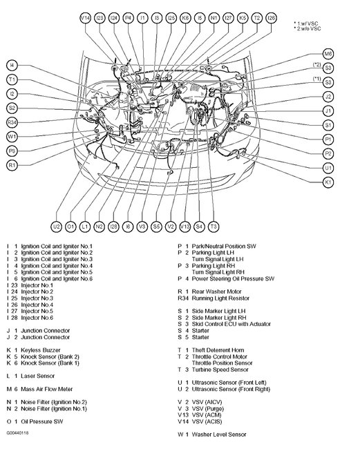

Steering wheel is hard to turn. I already change pump. But nothing.
Jun 27, 2018 at 2:24 PM
  • 110,194 POSTS
If this happened all at once and you have already replaced the pump, I would suspect the power steering oil pressure switch. It is located on the right front of the engine area. I attached a picture of its location to help. You want to locate component P4.
Check to make sure it is not disconnected, have damaged wiring, or a bad connection.
