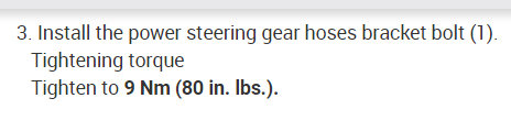

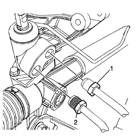

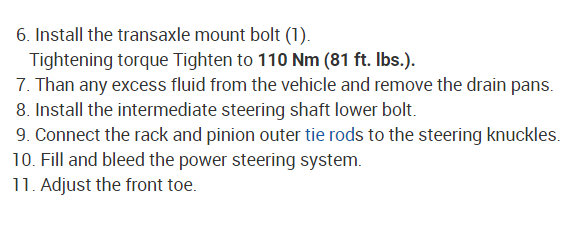

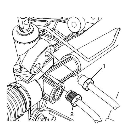

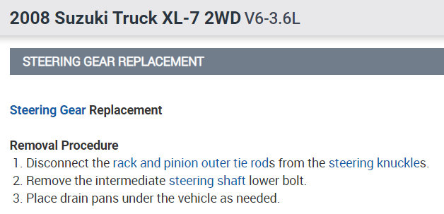

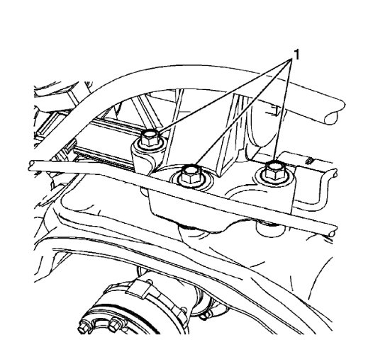

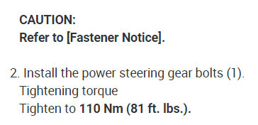

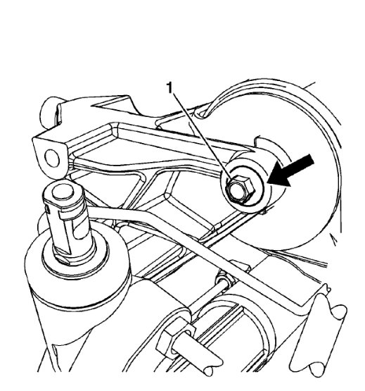

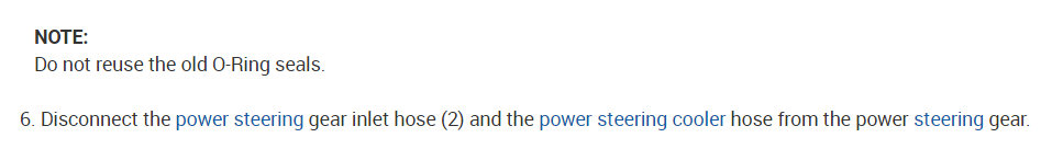

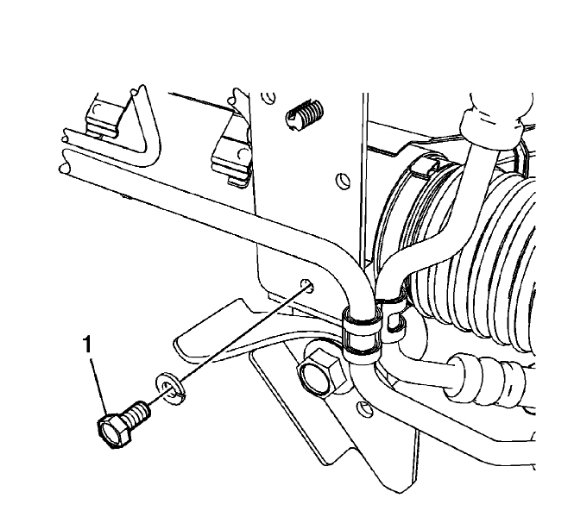

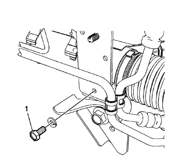

Hello, I'm Danny.

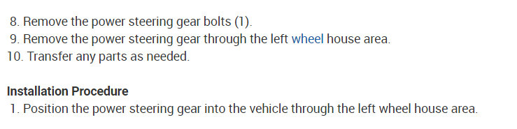

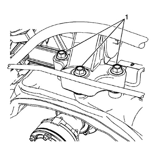

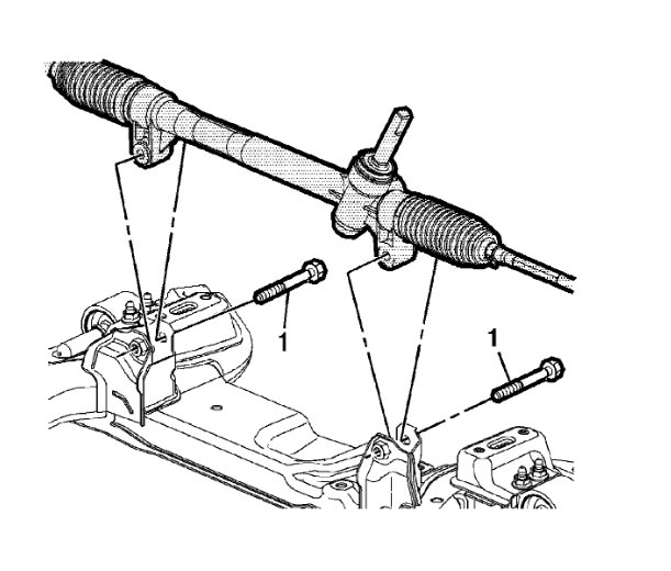

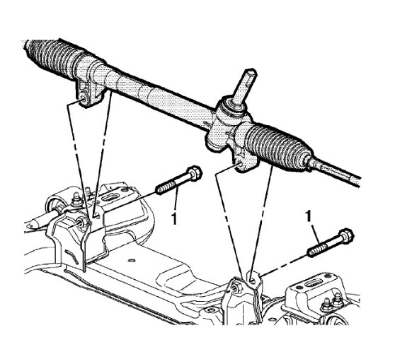

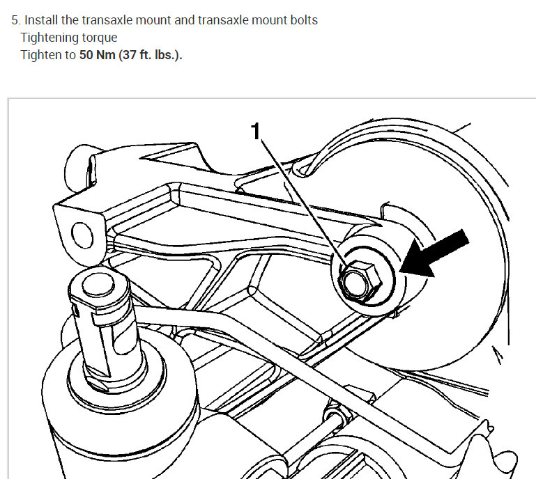

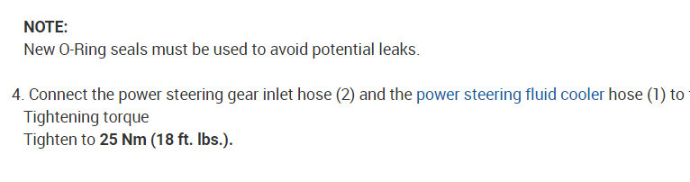

I've attached picture steps below on how to replace the power steering rack and pinion assembly on your vehicle. Hope this helps and thanks for using 2CarPros. Happy Holidays.
