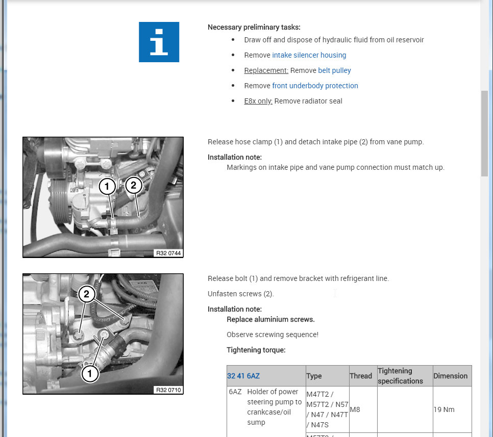

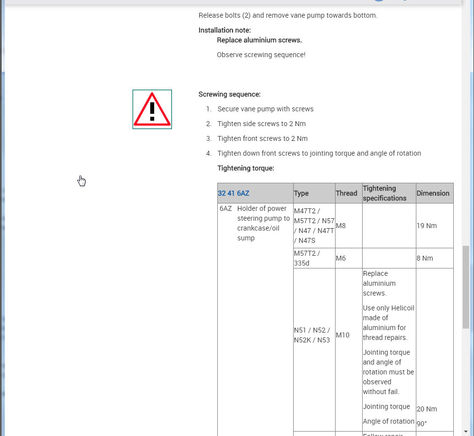

No noise from power steering. Started kind of suddenly and has stayed the same since. No better or worst. Extremely hard especially at sand still turns and low speeds. Parking , right left turns from a stand still.
Jun 25, 2020 at 1:39 AM

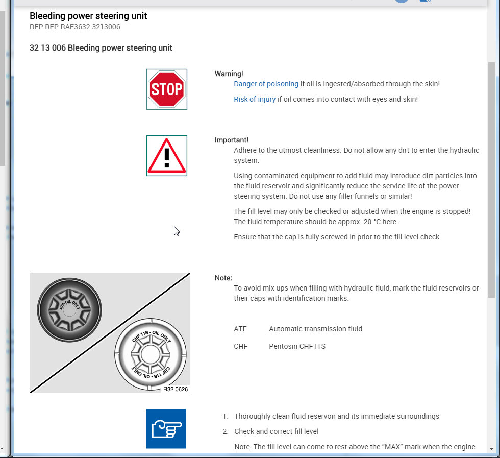

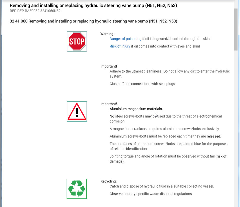

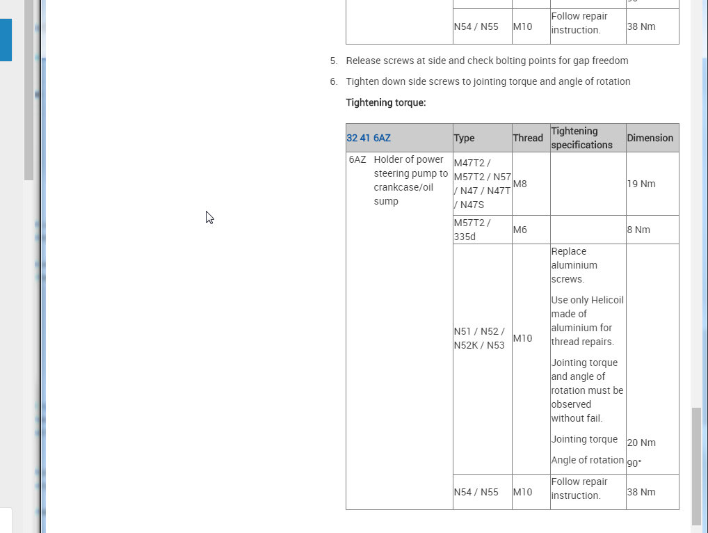

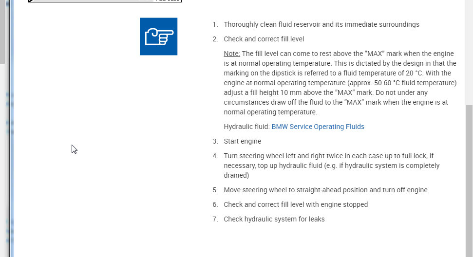

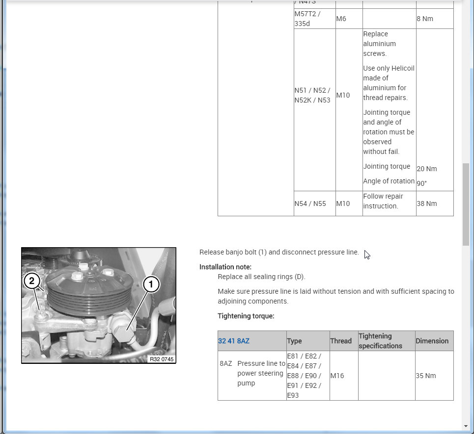

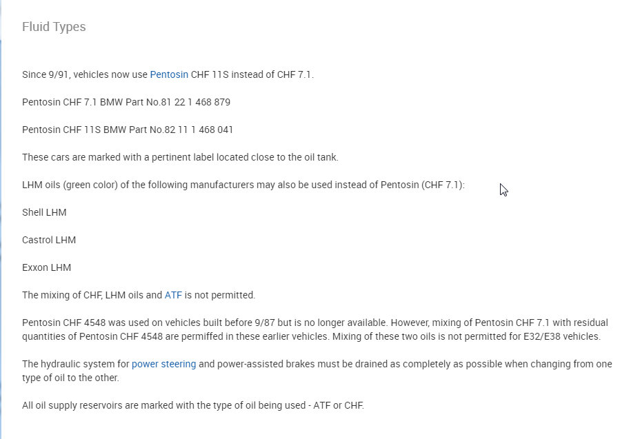

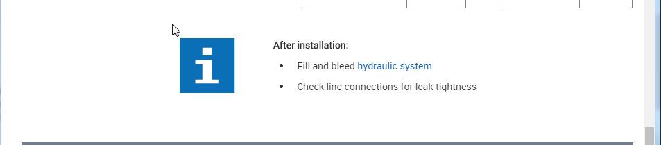

Sounds like the power steering pump has failed. Most of the time the shaft in the pump just sheers off and you lose all power steering suddenly.
I attached the process on how to replace it. Let us know if you have more questions. Thanks
Jun 25, 2020 at 11:44 AM
