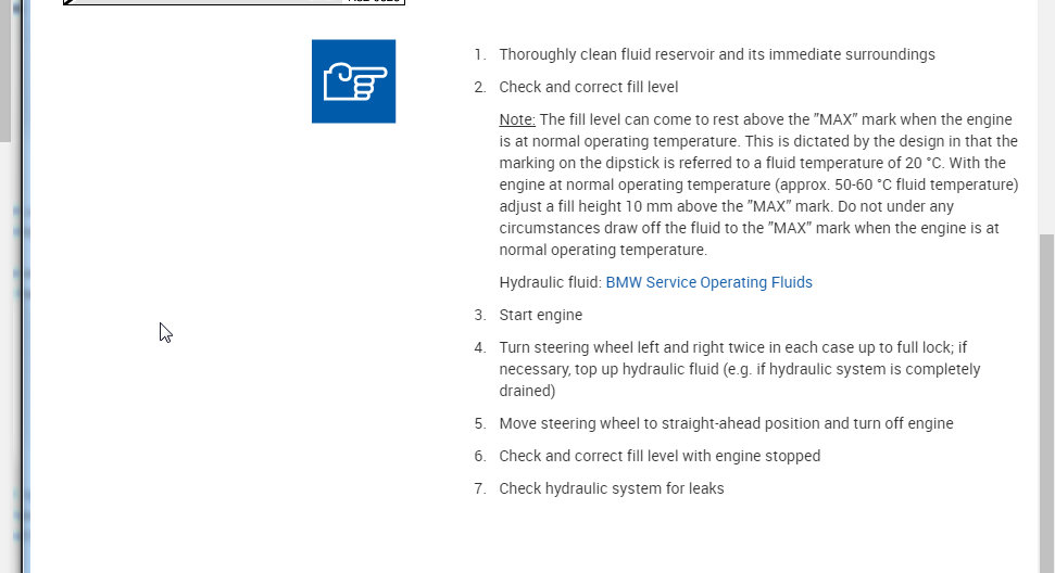

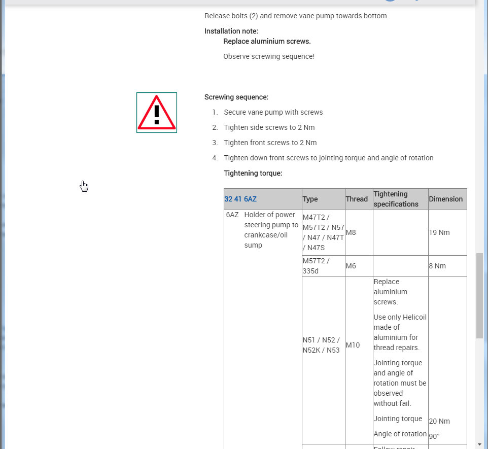

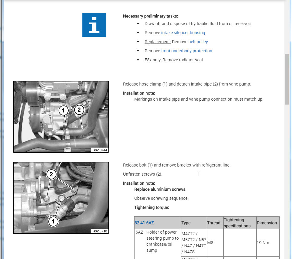

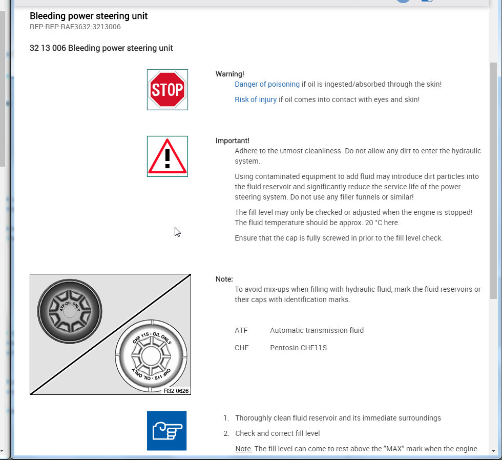

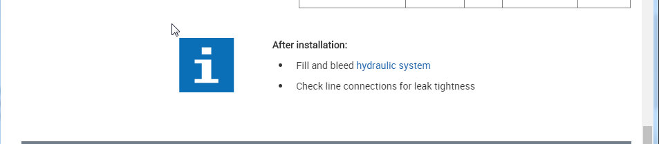

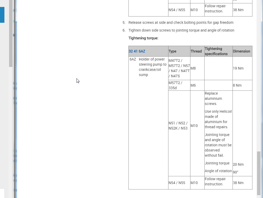

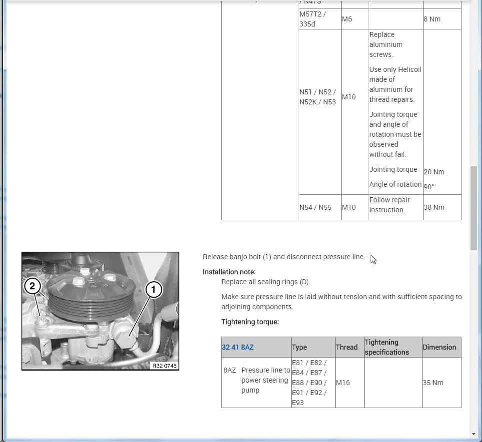

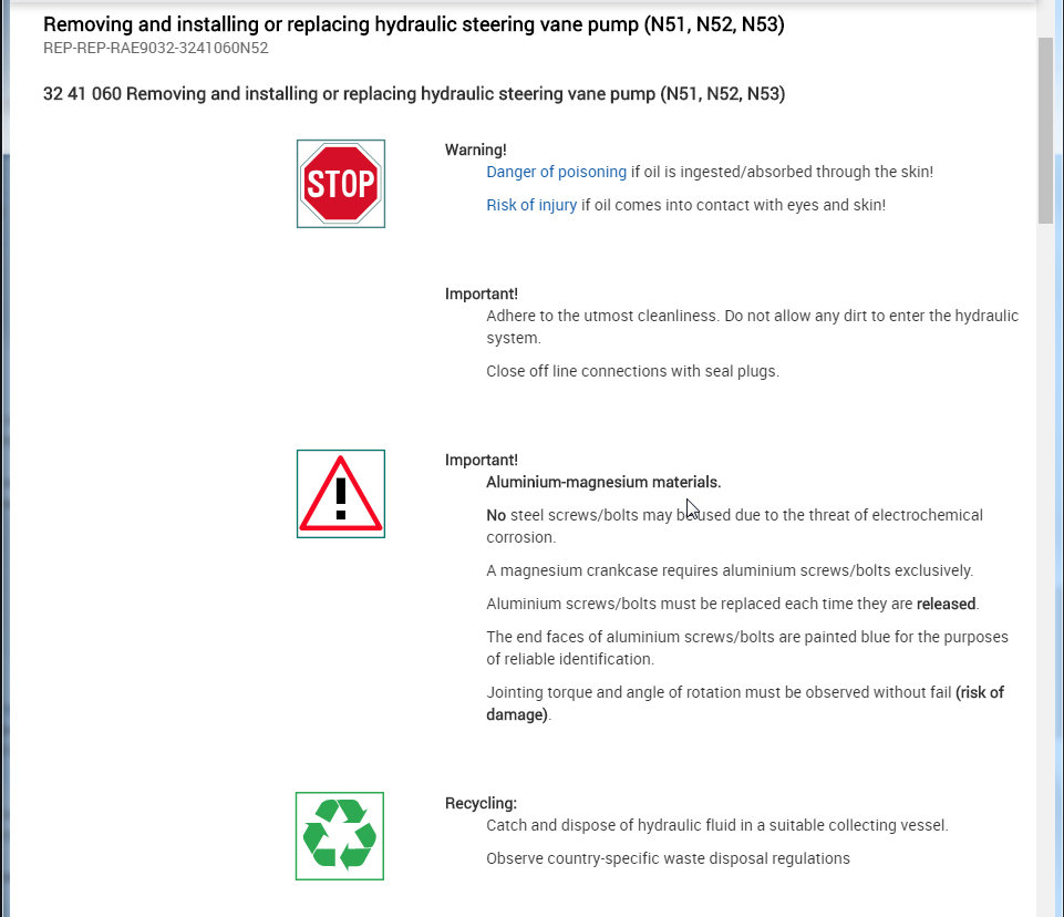

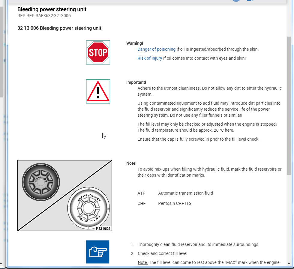

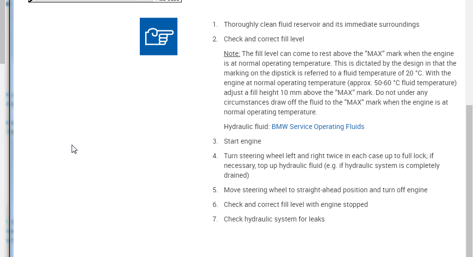

Sounds like the power steering pump has failed. Most of the time the shaft in the pump just sheers off and you lose all power steering suddenly.

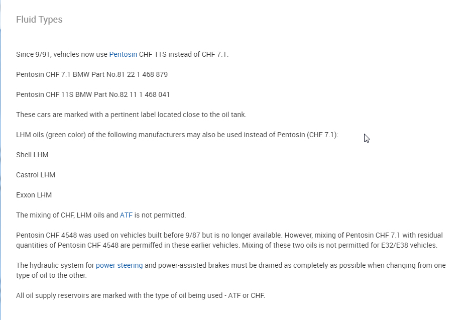

I attached the process on how to replace it. Let us know if you have more questions. Thanks

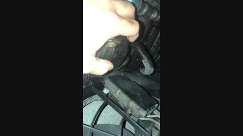

I am desperate for help, and I cannot verify my e-mail so I can place a question on the website since I have not yet to receive a verification mail from the website.

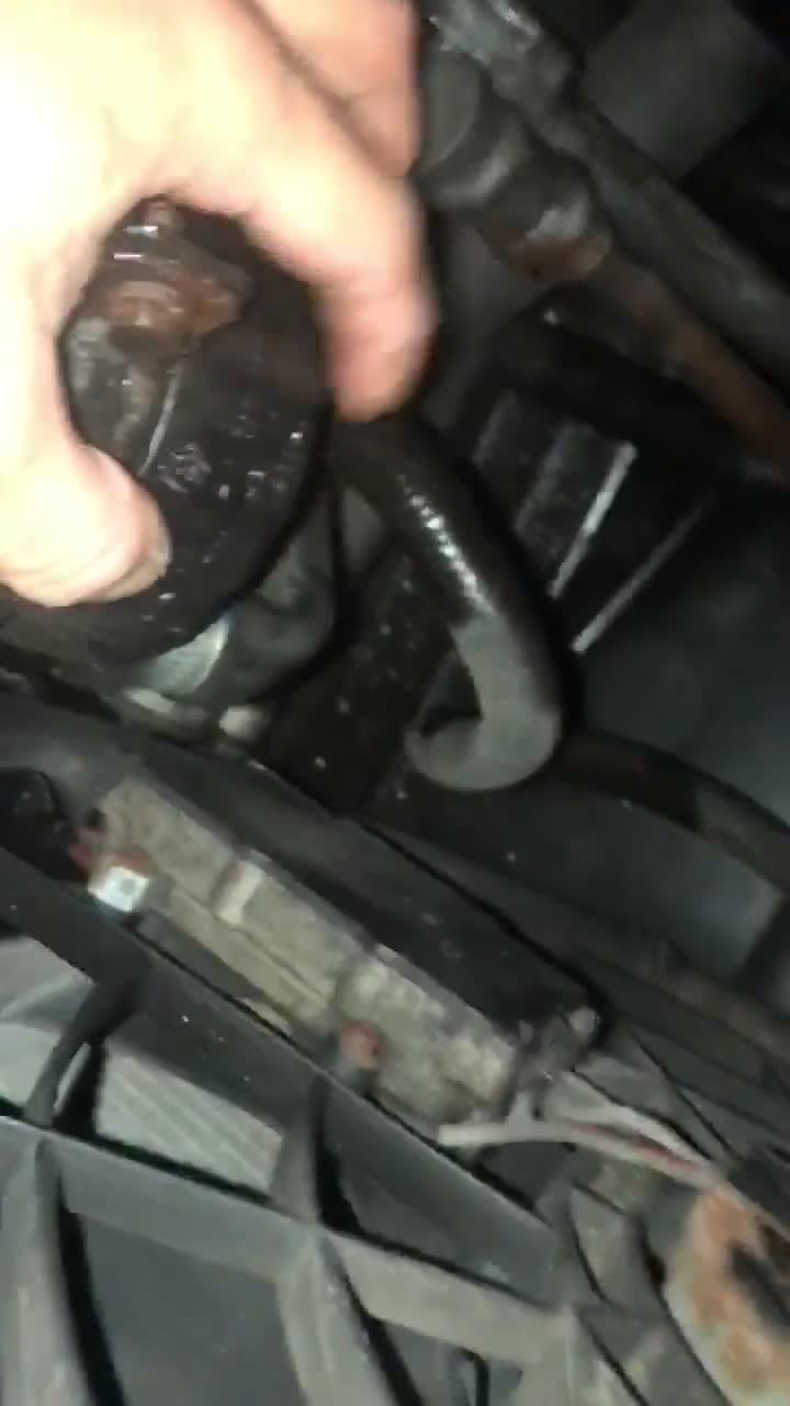

I just replaced my Power Steering Pump for my BMW e46 i318 because I began to hear a whining noise from the old one when I was turning on the car and when turning the steering wheel. I successfully replaced the old with a new one, but there is still a whining noise when I turn my steering wheel. I have also checked the Power Steering Fluid, and there is the right amount in the reservoir.
I then took a look at the hose, and by the looks of it, is it possible to assume that the hose is causing a clog?
