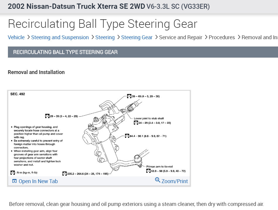

I cannot easily turn steering wheel to the left, I can turn to the right with no problem. I’ve already installed a new power steering pump and put some Sea Foam transmission tune into steering fluid yesterday and took it for long drive.

This happens when the steering box goes out. here is a video of the job being done on a similar car (the steps are the same) with a diagram below to show you how on your car:
https://youtu.be/KKeFqHLuRQ0
