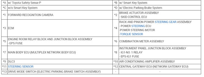

  • 55,064 POSTS

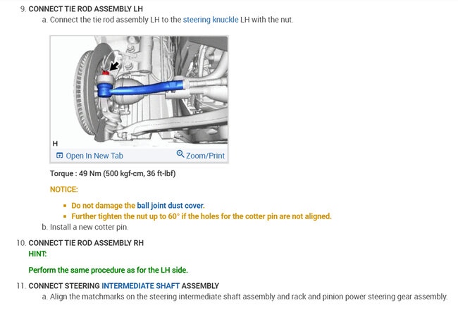

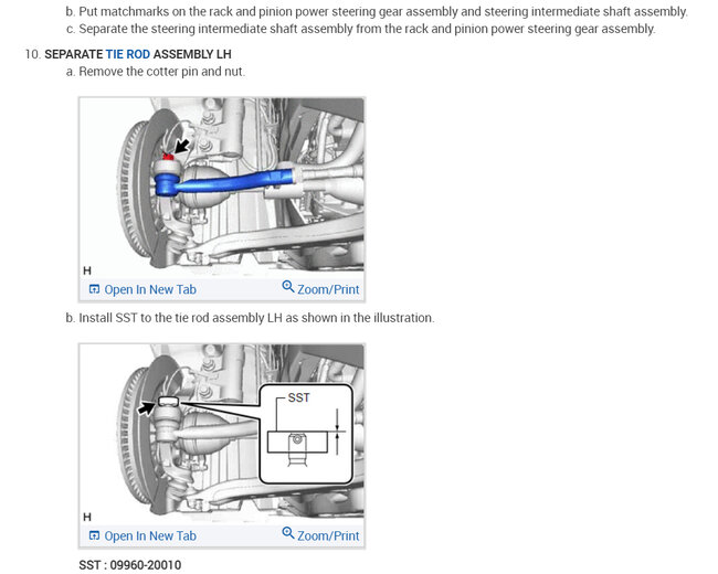

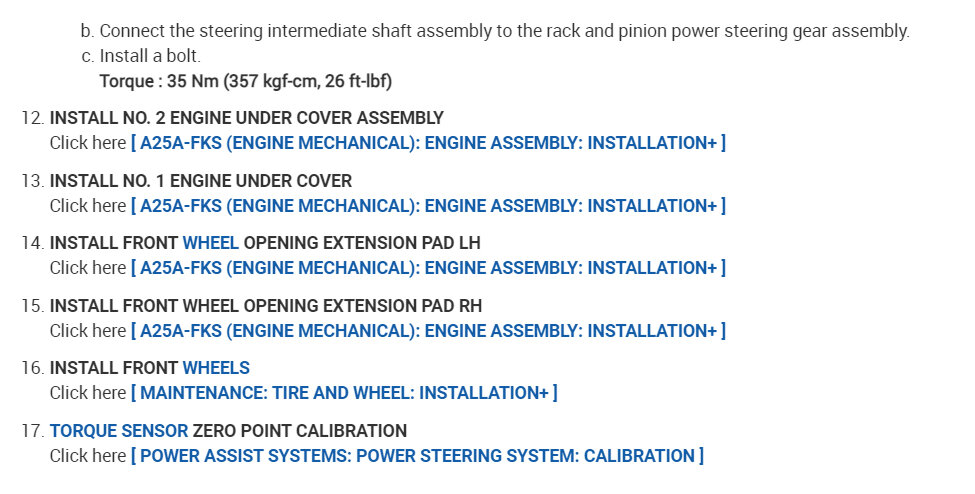

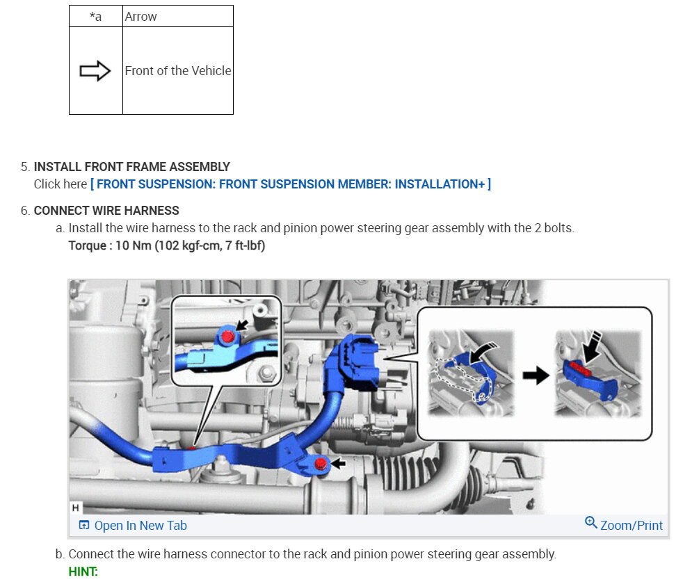

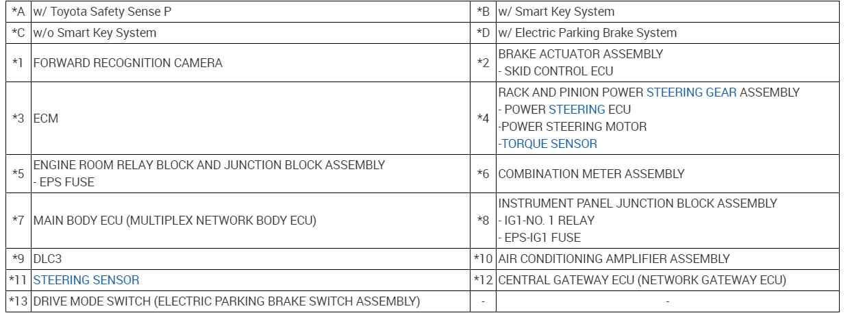

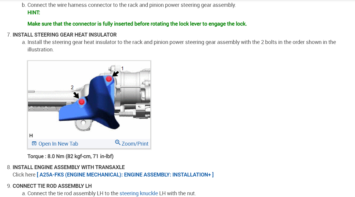

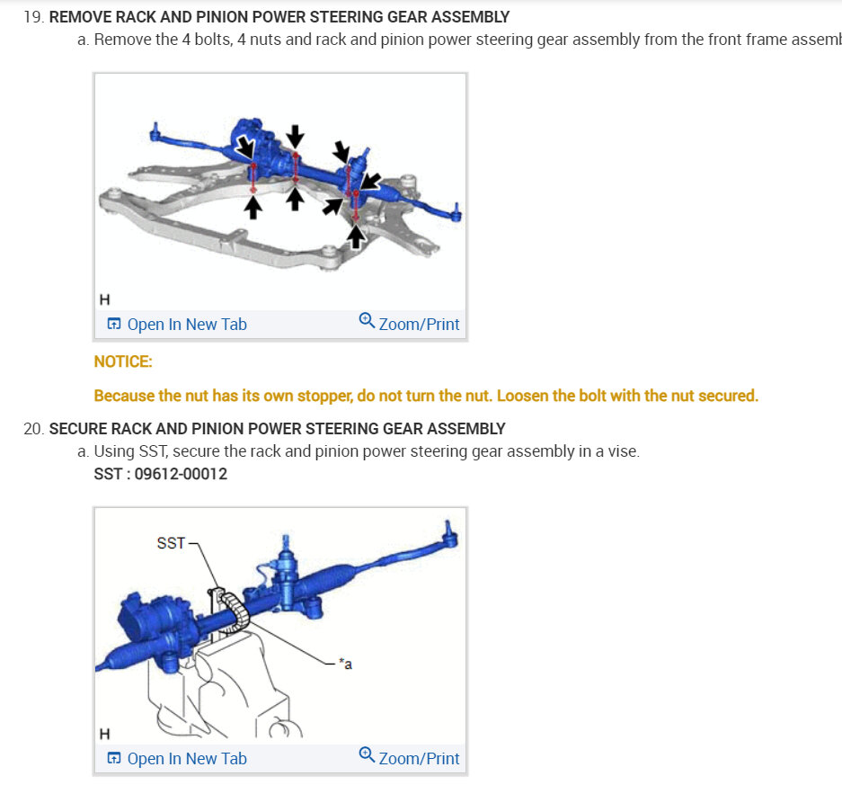

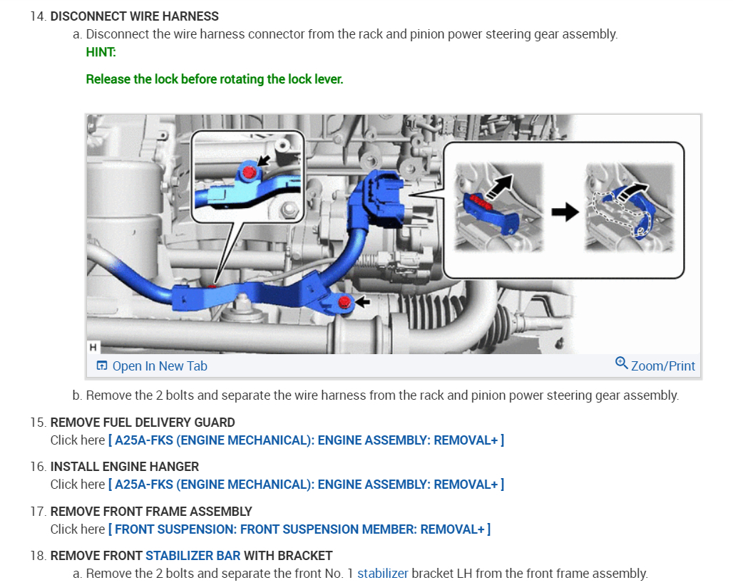

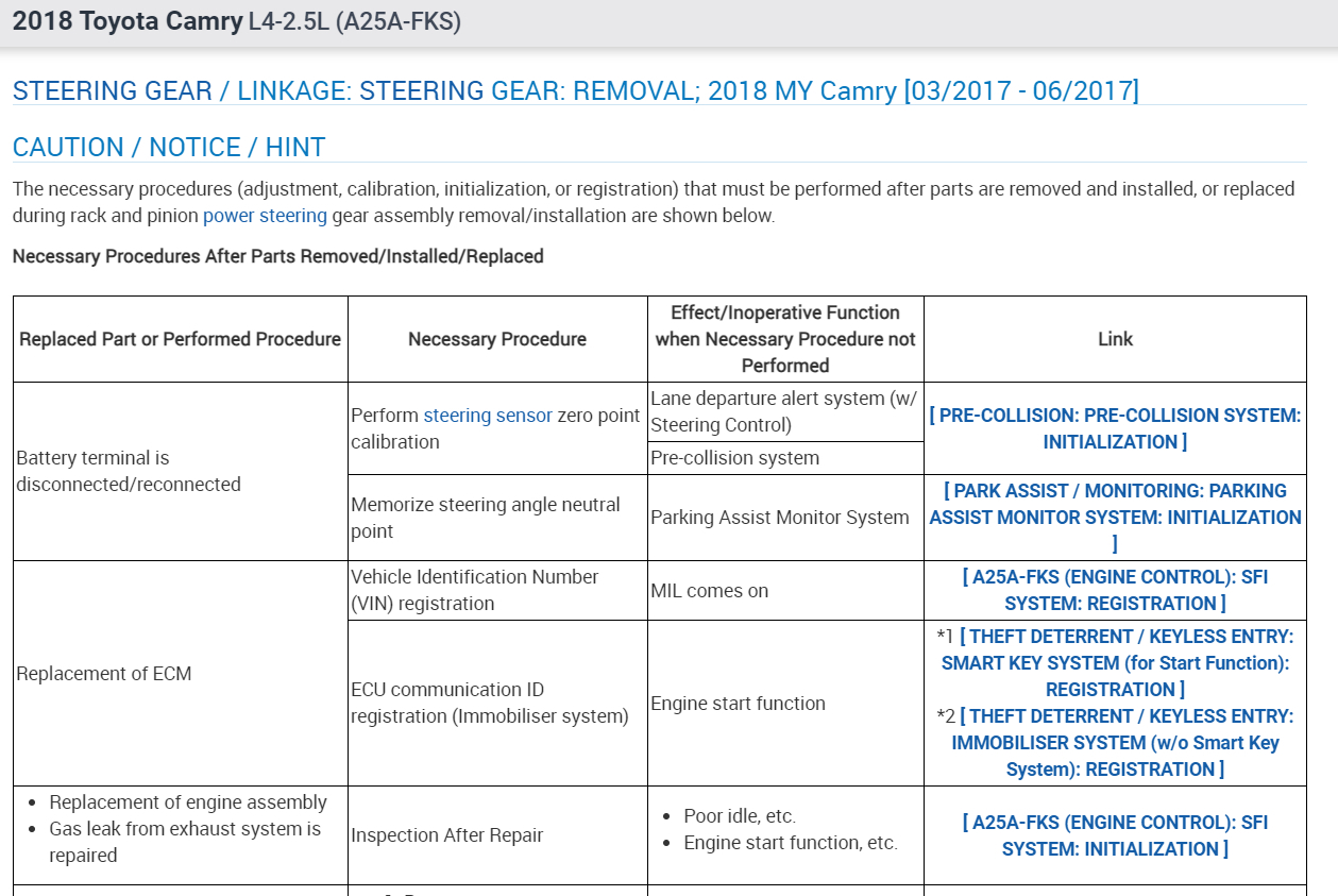

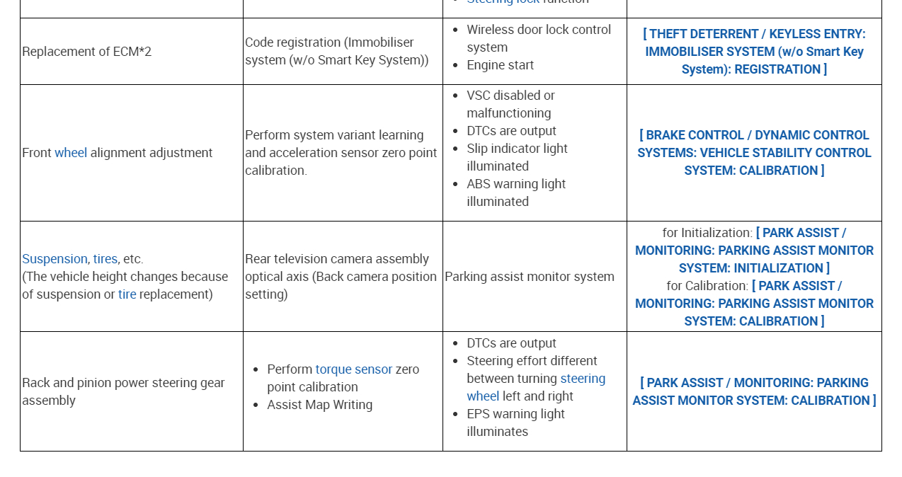

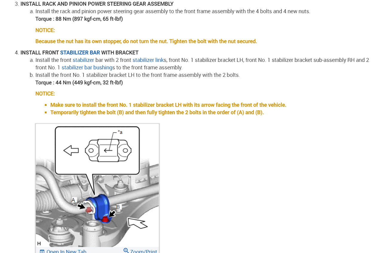

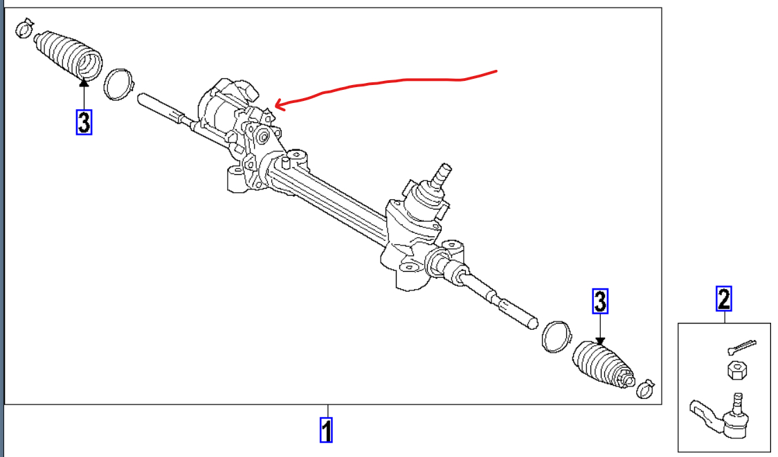

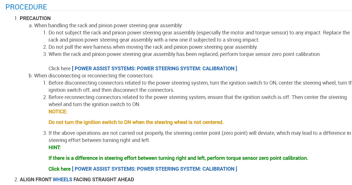

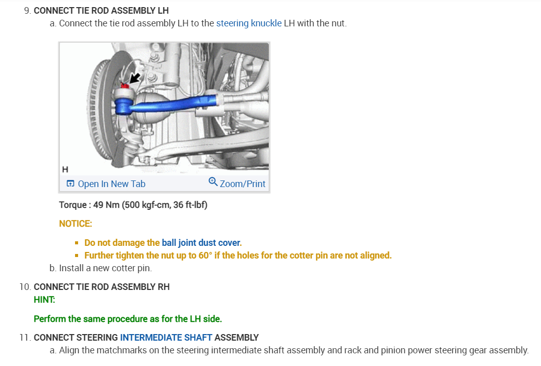

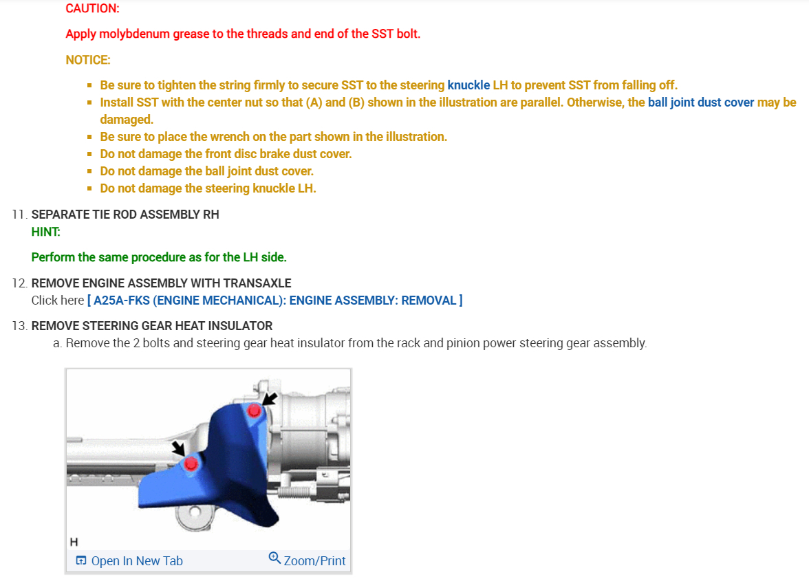

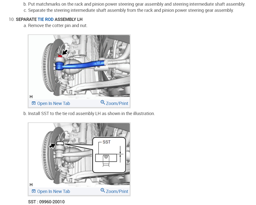

Do you hear any noise while turning? If not, it sounds like the turning rack is going out which uses an electrical motor to help assist the steering operation. I would run the codes through the CAN to see if any codes come up. You can get a CAN scanner (Controller Area Network) which will work on most cars from Amazon.
here is a video to show you how:
https://youtu.be/u-4syLc-ifQ
and
Here is one for about $99.00 if you need it:
https://amzn.to/3ZixY4v

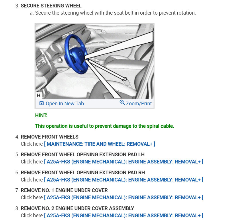

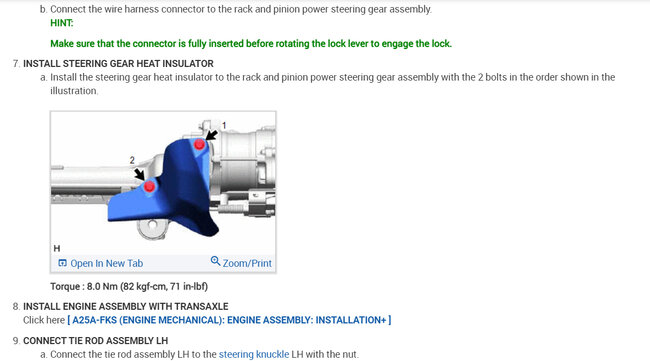

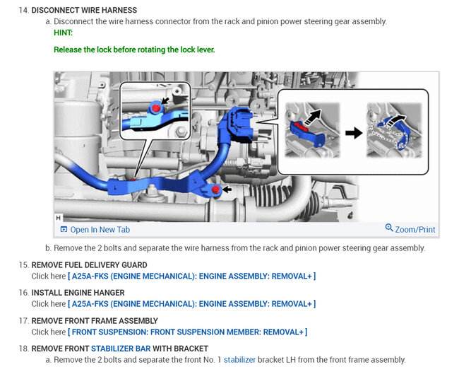

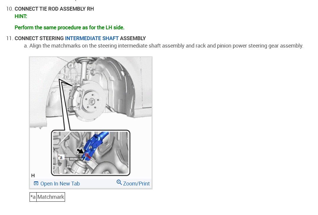

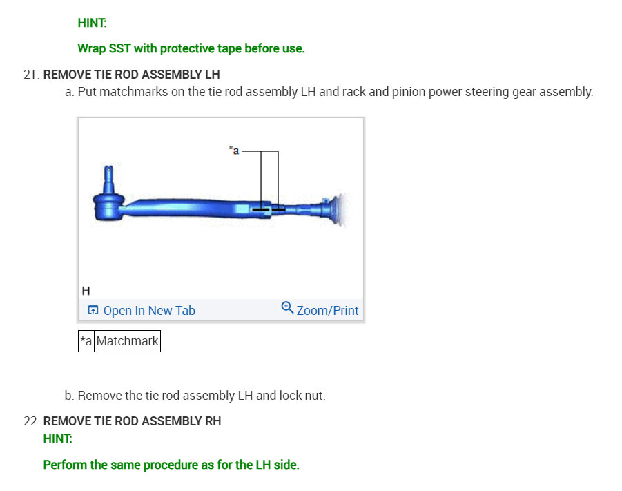

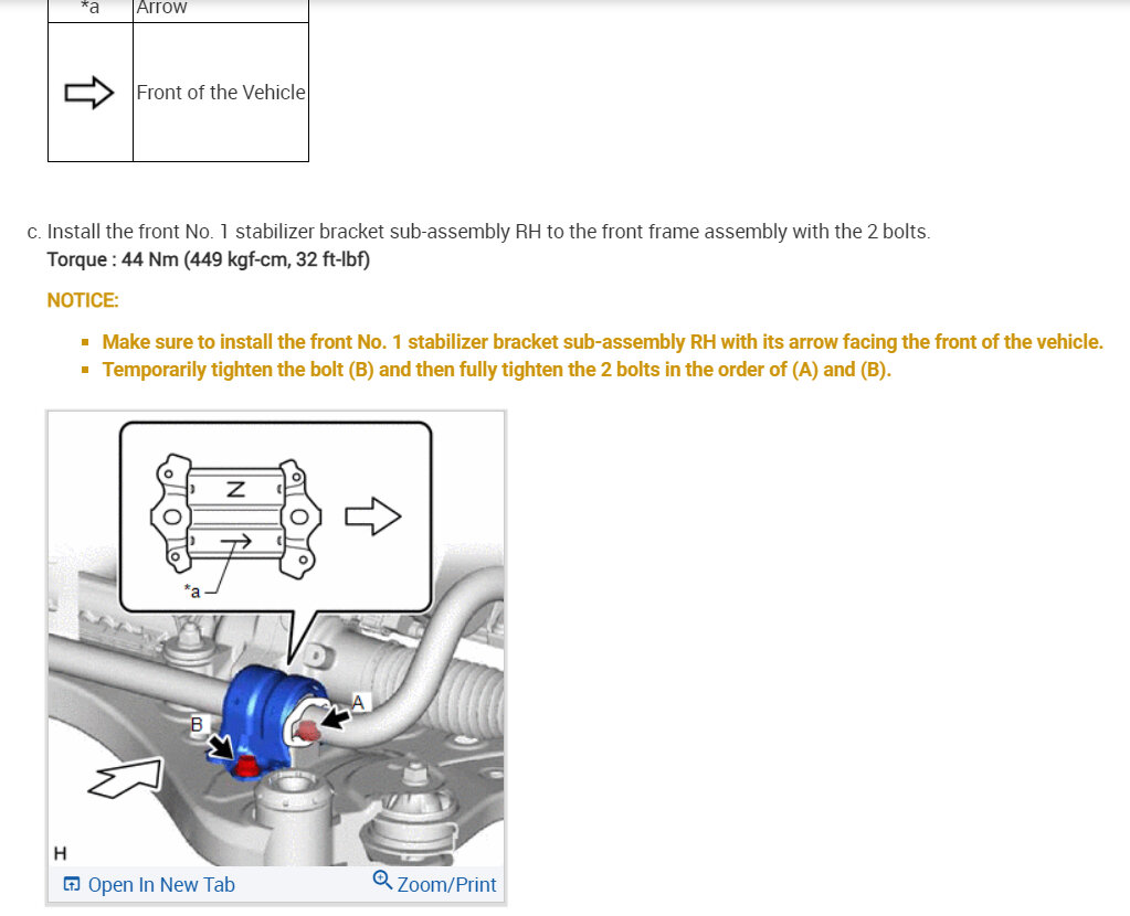

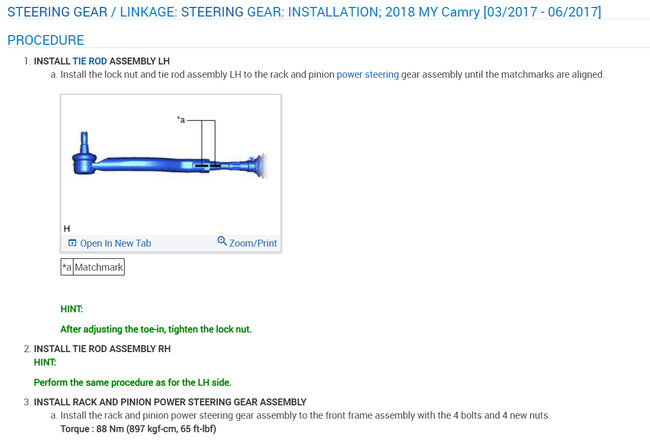

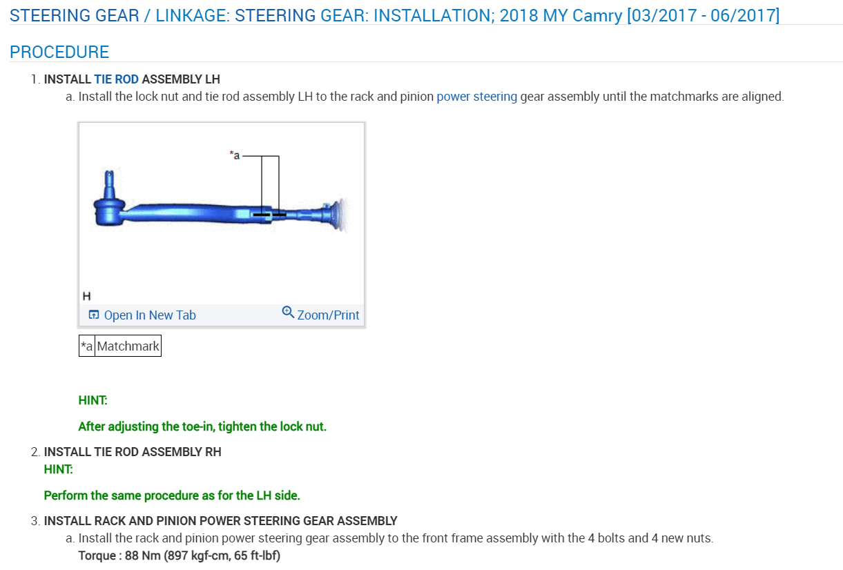

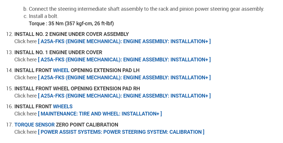

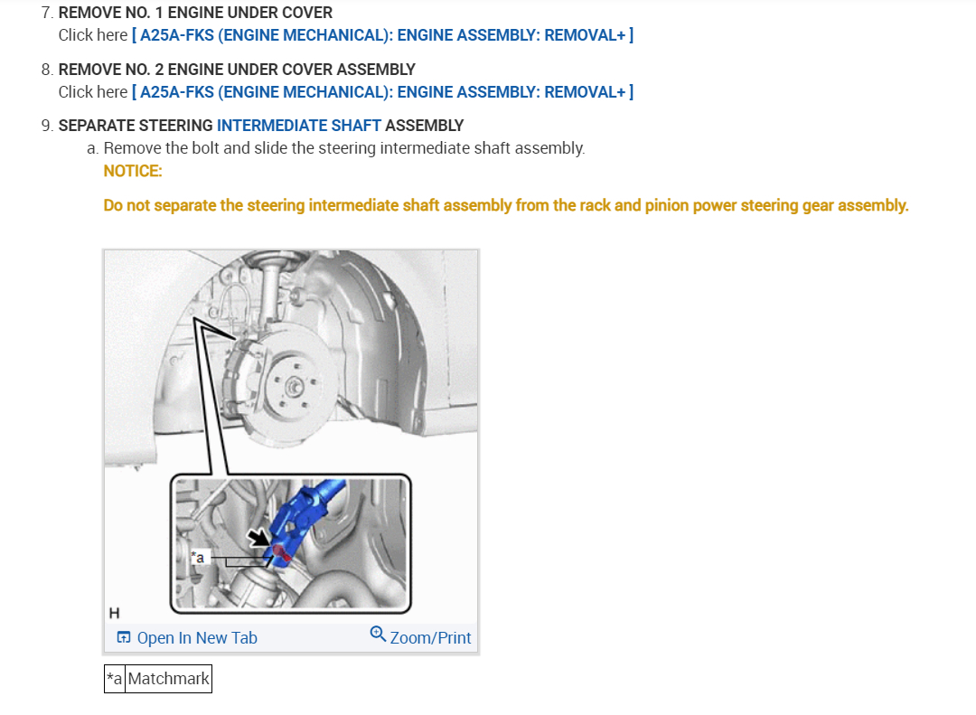

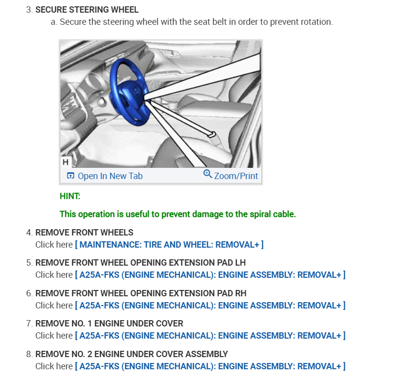

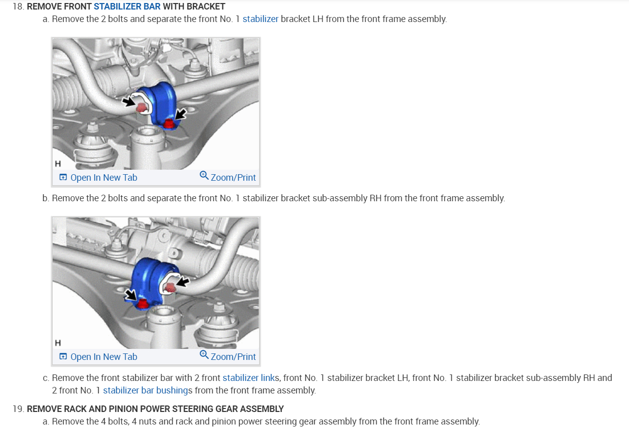

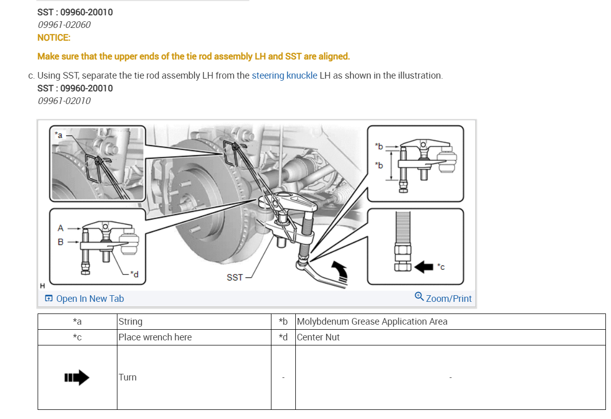

Here is how to change the unit out if there are codes that come up the steering rack failure.
