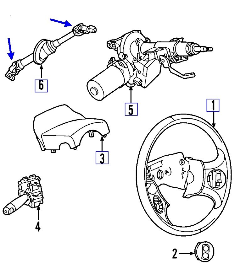

When driving or stationary on the ground the steering has an odd stiffness turn the wheel left or right about every third of a turn or so. With vehicle raised, all steering components look in good working condition but turning the wheel left or right there is 3 to 4 inches of play before the tires move in either direction. What would cause the stiffness or play?
Factory power steering recall has not been fulfilled yet.
Aug 16, 2025 at 12:13 AM
CARADIODOC
  • 34,380 POSTS
Both conditions can be caused by a worn universal joint in the steering shaft. The drawing below shows two joints to inspect. Watch each one while a helper moves the steering wheel back and forth. Let me know what you find.

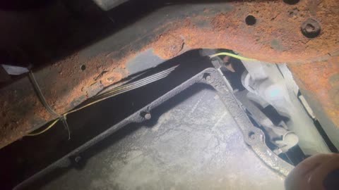

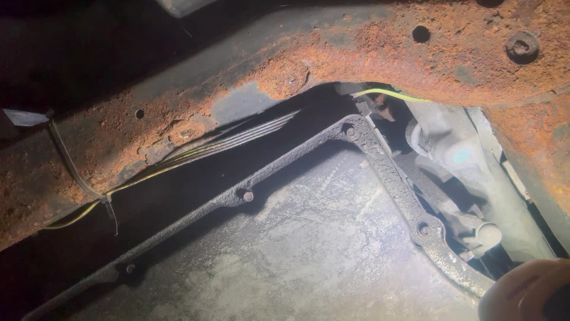

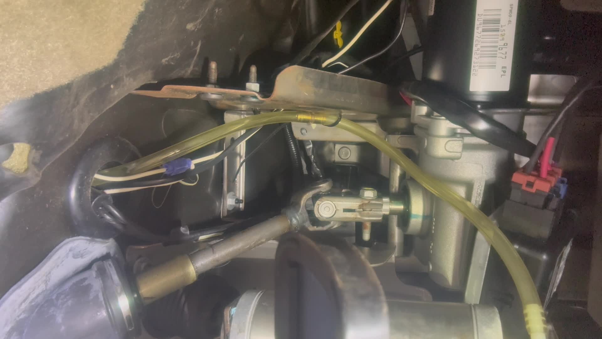

Both u joints appear to be intact, also noticed no movement or play while grabbing ahold of inside and outside of the car and shaking vigorously.
While not the clearest image of the joint connecting to the rack and pinion, both show free movement with no binding while turning the steering wheel stop to stop.
Any other suggestions?

Then a standard system inspection is in order. Besides checking for looseness in tie rod ends, ball joints, and bushings, we would have a helper rotate the steering wheel back and forth roughly 1/8th revolution, and watch for which part(s) don't respond immediately.
Stiffness when turning is very commonly caused by tight universal joints in that steering shaft, but GM also had a problem we called "morning sickness" because it affected every single one of their front-wheel-drive cars with loss of power steering assist in only one direction, first thing in the morning when everything was still cold. The cause was deep grooves worn into the spool valve housing part of the soft aluminum rack and pinion steering gear assembly by the Teflon-coated sealing rings. As they warmed up, at first within a minute or two, the power assist returned. After a few weeks, the power assist was lost when turning in the other direction too. GM's fix was to install a new spool valve with new sealing rings. That was a temporary repair designed to get the vehicles out of the 50,000 mile warranty, then the proper repair was the car owners' responsibility. That repair was to install an aftermarket rebuilt steering gear with a stainless steel insert. This affected models back to the 1980s, and is no longer very common, but the same condition can still happen to any model, especially at higher mileages. The quickest clue to look for is the hard steering only occurs with the engine running. With the engine off, steering will of course be very hard, but you won't feel those tight spots.
Something else to consider during an inspection is the rack and pinion assembly itself. This is not common with GM's design, but watch to see if the assembly moves left and right when your helper works the steering wheel. Loose mounting bolts is accompanied by a knocking noise and steering wander on the road. Wear in the spool valve, (that's what directs the flow of pressurized power steering fluid), can require too much steering wheel movement to get the wheels to respond, but most of the time you'll also have power steering fluid leaking. That fluid can show up on the ground or inside right behind the brake pedal.
With as much steering wheel play as you described, the worn part should be fairly easy to identify. If not, the steering and suspension systems should be inspected by a specialist. Anyone at any tire and alignment shop can do that in a few minutes, and many do that for free. This can be done at other repair shops too, as long as they have a specialist for steering and alignment.

This type of binding, the way you described it, can not be caused by ball joints or tie rod ends. The bearings in the upper strut mounting plates can bind, but again, not in this way. While very uncommon, the only way the rack and pinion assembly can do this is if one of the front wheels was slid sideways, pretty hard, into a curb. Even that doesn't put the biggest stress on the steering gear. There would be other, much more significant damage. The only other way for the steering gear to do this is if something is coming apart inside it, and that almost always is accompanied by fluid leakage.
I'm still leaning toward the steering shaft. First, look for rust-colored stains around one of the universal joints. That indicates a cup and bearing that has failed. Next would be to disconnect that shaft on one end so you can rotate the joints easily. One of the joints can have a tight spot with no looseness, it can be sloppy but with no tight spot. What is most common is to have both in one joint.

Replaced intermediate steering shaft, all issues have been solved.

Sure did.
Engine side of firewall, one direction in u joint was fine other direction completely frozen.
