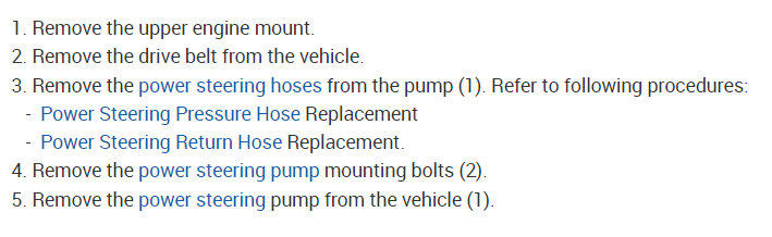

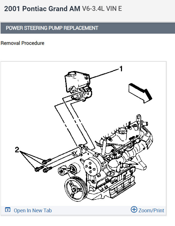

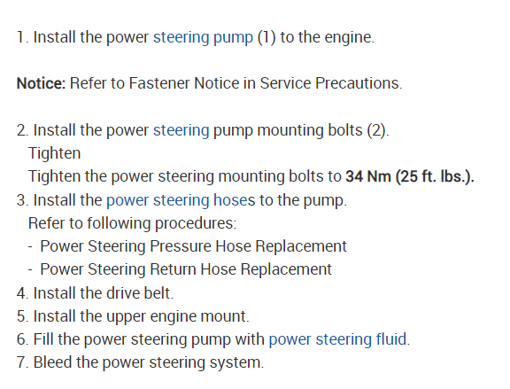

This is probably the power steering pump, I would remove the pump cap while the engine is running (cold) and see if fluid is circulating, if not the pump is bad, here is how to change the pump out.
Here is a guide that can help as well:
https://www.2carpros.com/articles/power-steering-problems
Check out the images below to see how the pump is replaced, there is a chance the rack and pinion are bad as well but most of the time it will be the pump. Here is a generic guide to help you step by step with instructions in the diagrams below to show you how on your car.
https://www.2carpros.com/articles/how-to-replace-a-power-steering-pump
Check out the images (below). Please upload pictures or videos in your response of any problems so we can see what to help you with.

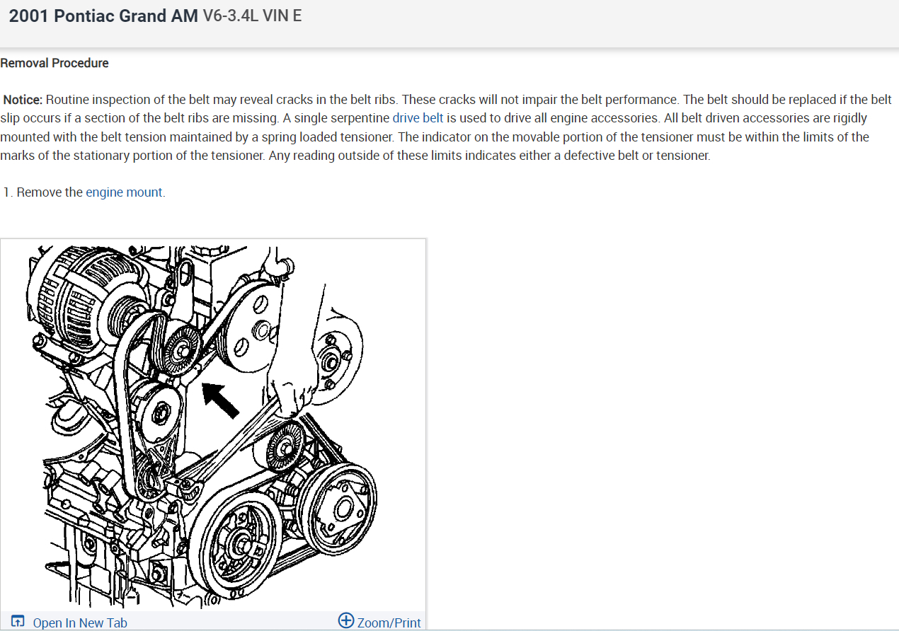

I would try removing the belt and turn the pump by hand to check the smoothness of the rotation, try to see if it has any hard spots. Check out the images (below). Let us know how it goes.
