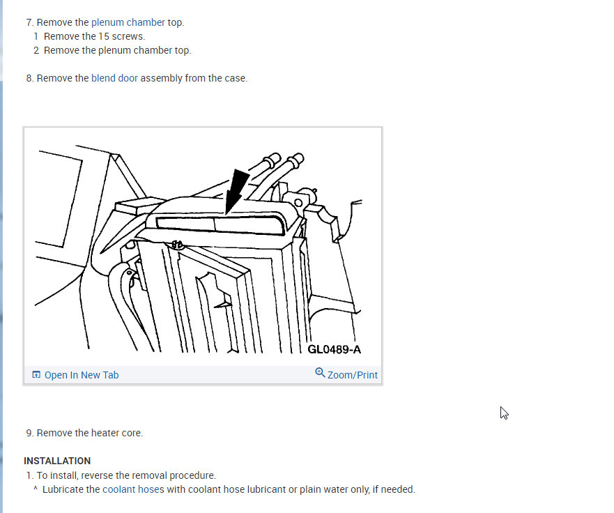

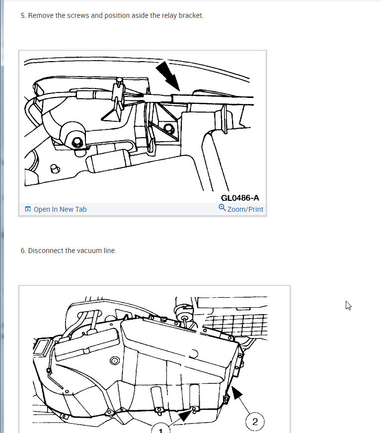

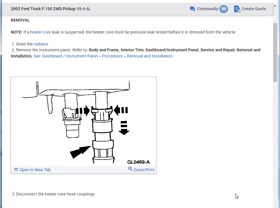

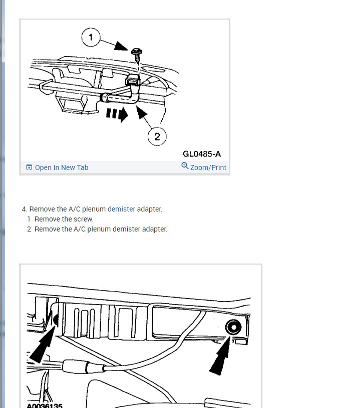

Unfortunately this means you most likely have a heater core leak even though you can see it or find coolant.
If the smell is sweet then this is coolant getting turned to steam.
I am attaching the process below for the heater core on the vehicle listed on this post.
Let us know if you have questions Thanks
