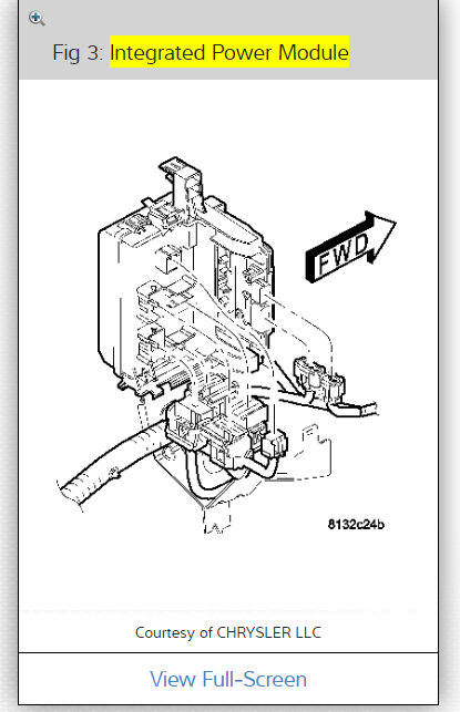

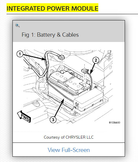

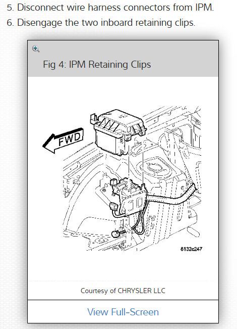

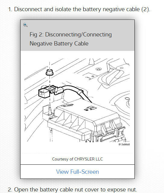

Yep, this happens when the TIPM module goes out but to be sure we should do a CAN scan. You can get a CAN scanner (Controller Area Network) which will work on most cars from Amazon.
https://youtu.be/u-4syLc-ifQ
Here is how to change the TIPM out in case you need it which is easy because it-self learns. Check out the images (below). Please let us know how it goes.
