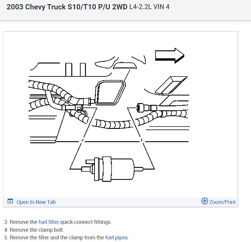

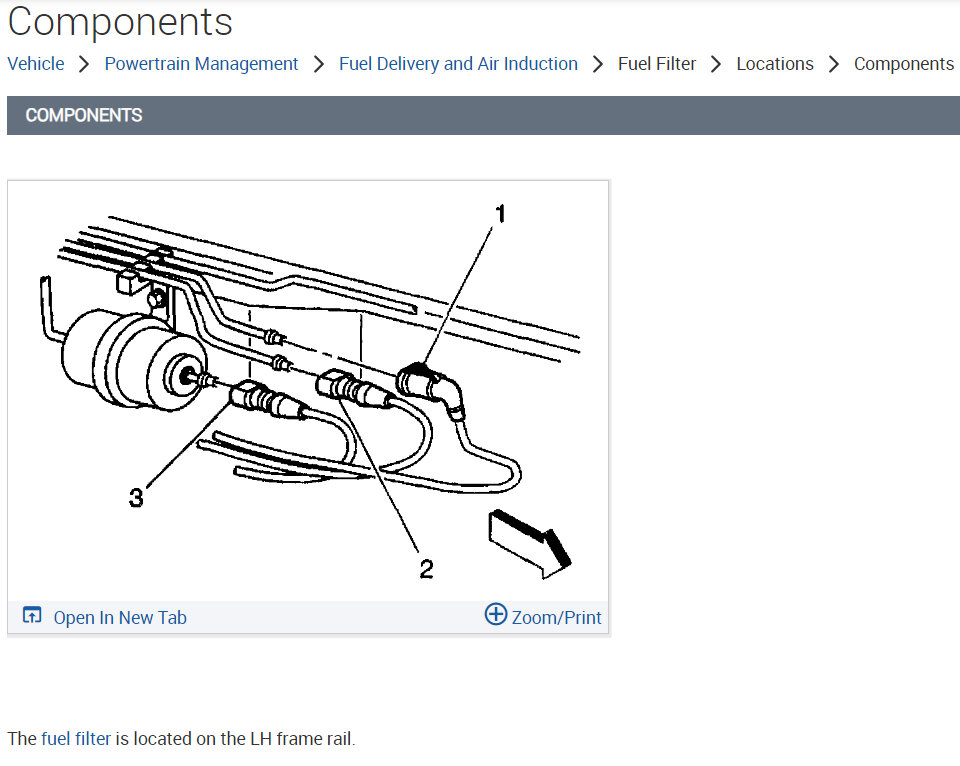

I'm going to try to change this fuel filter myself but found out it's on the inside of the frame halfway down the side of the truck. So, I will need to lay sideways to work on it. I'm worried about fuel spraying once disconnected so how can I prevent that? Also, my tank is 3/4 filled. I planned already taking this fuel cap off to depressurize it but what else can minimize the mess? Thanks
OEM Delco price is $80.
O'reilly Microguard fuel filter is only $16.
Which one would you get?
Oct 1, 2024 at 6:07 AM
  • 55,588 POSTS
I would go with the O'reilly Microguard fuel filter. Also, have a catch can ready when you loosen the fuel lines, just a cup full of fuel is all that will come out, and yes remove the gas cap. I have seen the fuel pressure regulator leak on these trucks which is inside the intake manifold. If this is the problem one or two or the spark plugs will be black so you might want to pulls the plugs out for inspection. Let me know how it goes.

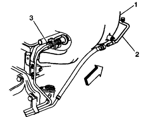

I would like to check pressure but can't find the Schrader valve on fuel rail or a place to hook it up. Also, I want to get the old gas out of the tank so not much will spill. Can you use some tubing down then filler neck or will it hit an obstruction in the system? I don't want it to get stuck in the tank.
Oct 2, 2024 at 2:37 AM
  • 55,588 POSTS
Here is a video that helps with the fuel removal:
https://youtu.be/Q5MH2gnyFH0?si=Mdt1CmF8lKX0FbHJ
They don't have a Schrader valve anymore, you will need to tap into the line.
This guide can help:
Please go over these guides and get back to us.
Oct 2, 2024 at 4:04 AM

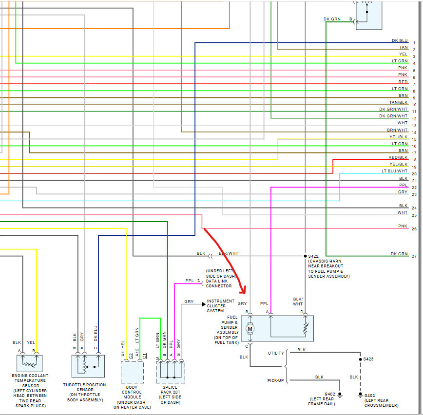

  • 55,588 POSTS
You won't hurt anything by draining the tank.
Here is a video to help:
https://www.youtube.com/watch?v=Q5MH2gnyFH0&t=37s
Let us know what you find. Here are the wiring diagrams for the fuel pump.

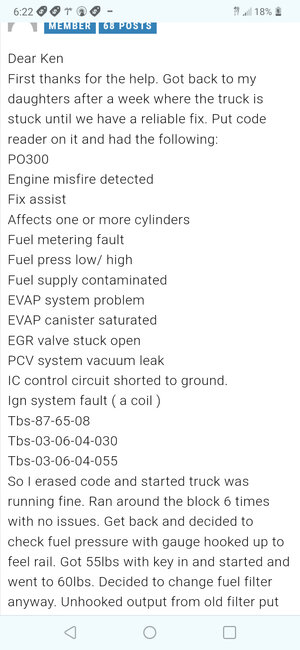

Dear Ken,
First thanks for the help. Got back to my daughters after a week where the truck is stuck until we have a reliable fix. Put code reader on it and had the following:
PO300
Engine misfire detected
Fix assist
Affects one or more cylinders
Fuel metering fault
Fuel press low/ high
Fuel supply contaminated
EVAP system problem
EVAP canister saturated
EGR valve stuck open
PCV system vacuum leak
IC control circuit shorted to ground.
Ign system fault ( a coil )
Tbs-87-65-08
Tbs-03-06-04-030
Tbs-03-06-04-055

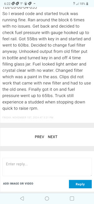

So I erased code and started truck was running fine. Ran around the block 6 times with no issues. Get back and decided to check fuel pressure with gauge hooked up to feel rail. Got 55lbs with key in and started and went to 60lbs. Decided to change fuel filter anyway. Unhooked output from old filter put in bottle and turned key in and off 4 time filling glass jar. Fuel looked light amber and crystal clear with no water. Changed filter which was a paint in the ass. Clips did not work that came with new filter and had to use the old ones. Finally got it on and fuel pressure went up to 65lbs. Truck still experience a studded when stopping down quick to raise rpm.
Nov 1, 2024 at 8:21 AM

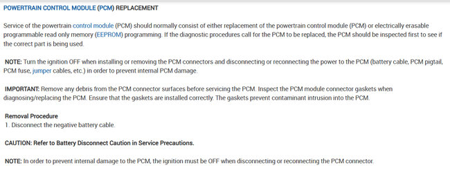

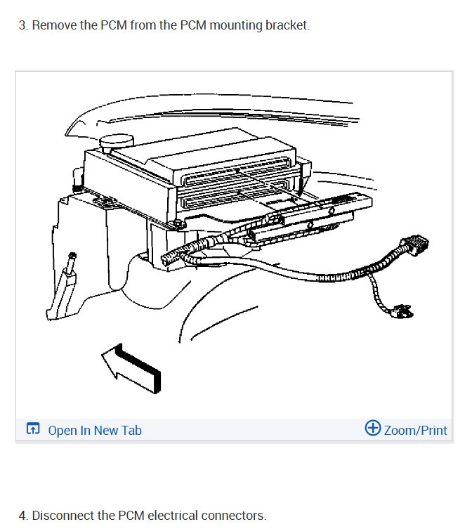

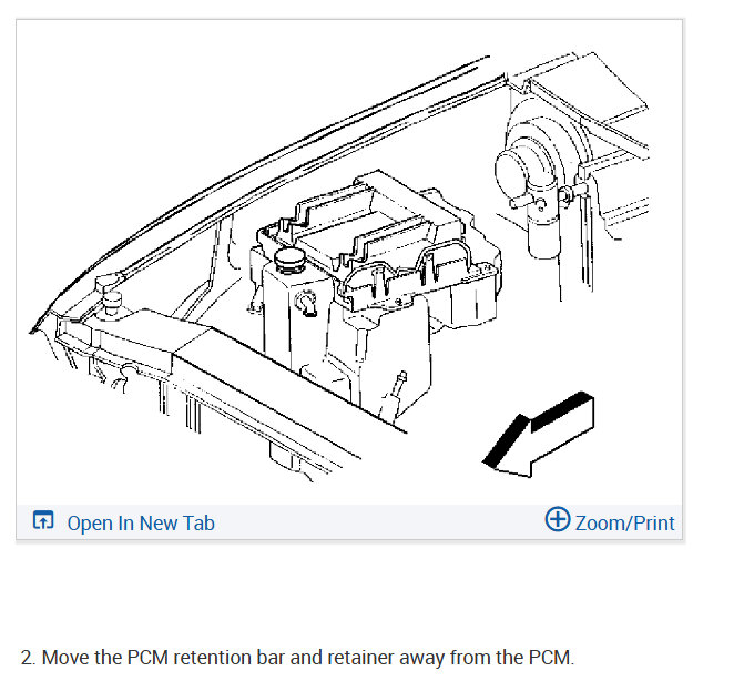

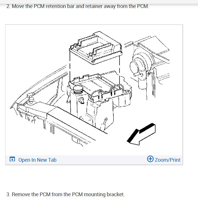

  • 55,588 POSTS
With all of these codes it seems like the PCM is bad, you can remove it and send it in for testing to confirm. Here is the location of the PCM and how to change it out. You can get a preprogrammed unit by searching Google or Ebay. Check out the images (below). Please let us know what happens.

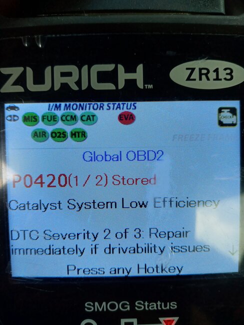

ROBERT WALBROEHL
  • 122 POSTS
New update.
Reset code. Put Lucas engine conditioner in fuel tank. Headed home with no service engine light until 6 miles out. Stayed on without flashing until I got home. Truck ran normally. Once home put code reader on it and got.

  • 55,588 POSTS
You could have a partially clogged catalytic converter, please go over this guide to see if that is the issue.
Please go over this guide and get back to us.
Nov 11, 2024 at 12:53 AM
