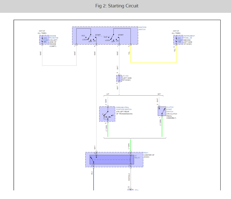

The car tries to start without the key being in the ignition
2008 SCION XB
21,700 MILES • 1.6L • 2WD • AUTOMATIC
TAYSHAWN
I tried changing the ignition switch, but this was not the problem.
Jul 1, 2022 at 1:47 PM
  • 55,224 POSTS

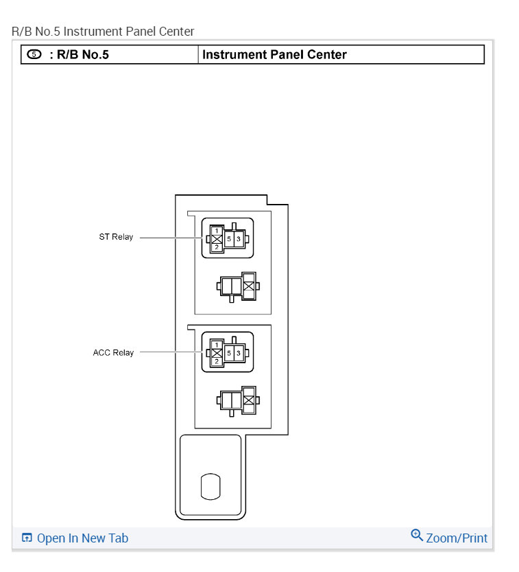

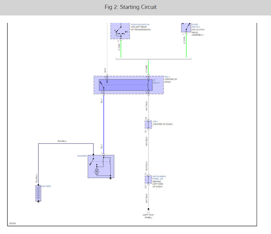

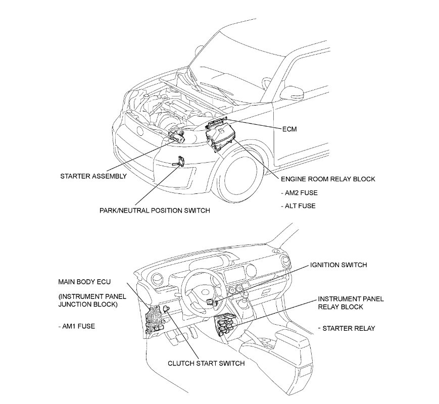

The starter relay or the starter itself is bad, let's remove the relay to see if it still does it. here is the location of the relay and the starter wiring diagrams below to show you how the system works. Check out the diagrams (below). Let us know what happens and please upload pictures or videos of the problem.
Jul 2, 2022 at 9:58 AM
