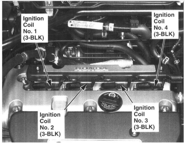

After having the car washed the engine started to buck driving 40 MPH?
2003 HONDA CRV
183,000 MILES • 4 CYL • 4WD • AUTOMATIC
CHERYL LATHAM
I went to the car wash its winter in Minnesota so it's kind of cold and I decreased the engine and washed it, then when I left within 3 minutes it started to buckle. so, I slowed down and then it was okay for 5 minutes and it did it again. made it home had someone look at it and dried it in the garage overnight took it for a ride it was okay that evening. Then the next morning I drove it after 10 minutes going 45 to 50 started to buck again. I don't know if the transmission or the engine is still wet a sensor got wet, I'm not sure do you think after it dries for a while, I can drive it and see if the problem still continues or maybe it might fix itself on its own. Any suggestions? I just don't have the money to put into this anymore. thank you

This happens when the ignition coils get wet. I would remove the coils and dry them out here are instructions to help you. Also, if the engine has not been tuned up this will help as well, please go over this guide:
https://www.2carpros.com/articles/how-to-tune-up-a-car-engine
Spark plug .................... NGK: IZFR6K-11 DENSO: SKJ20DR-M11
Gap .................... 1.0 - 1.1 mm (0.039 - 0.043 in)
Torque .................... 18 N.m (13 lb.ft)
Check out the images (below). Let us know how it goes.
