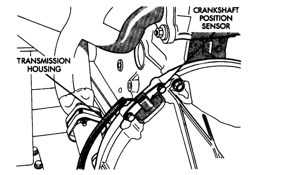

I have good spark coming out of the coil when I use my spark tester. Also, now I have replaced the fuel filter and unhooked the vacuum to the regulator at cranking I have 40 psi. On fuel. I checked spark at the spark plug it seems to be losing spark when engine shuts off then spark comes back and it runs again then shuts off. If I hold the key in the run position I can watch the spark come and go every time it shuts off. Could it be the pick-up plate in the distributor?
Friday, August 17th, 2018 AT 4:54 PM (Merged)
  • 52,797 POSTS
A very common issue is the crank sensor. It is located on the bell housing upper left side.
When this fails there will be no spark.
You can get it at any parts store.
SCOTT QUAIL
  • 12 POSTS
I have replaced the crank sensor still the same problem. I have ordered a new distributor. So I will let you know what I come up with. Thanks for your help so far.
