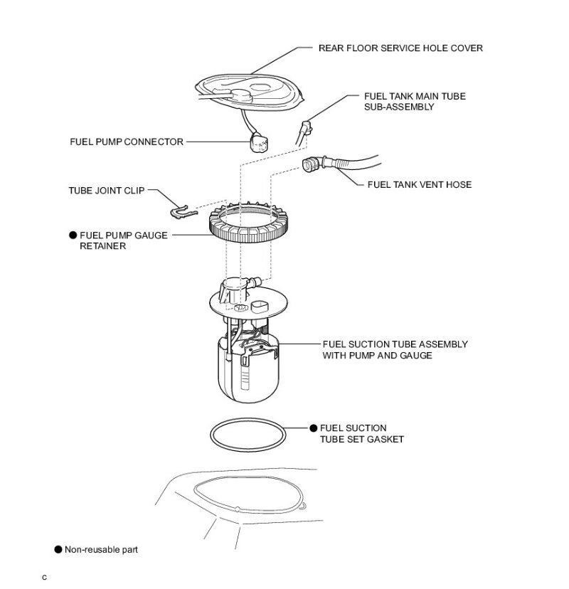

Starts then turns off?
2010 TOYOTA COROLLA
175,000 MILES • 2WD • AUTOMATIC
HAUDIWI6381

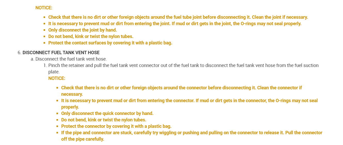

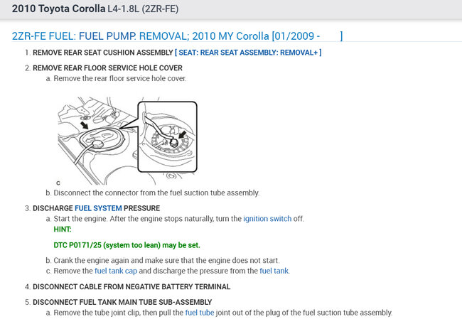

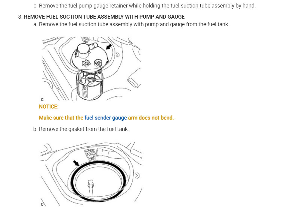

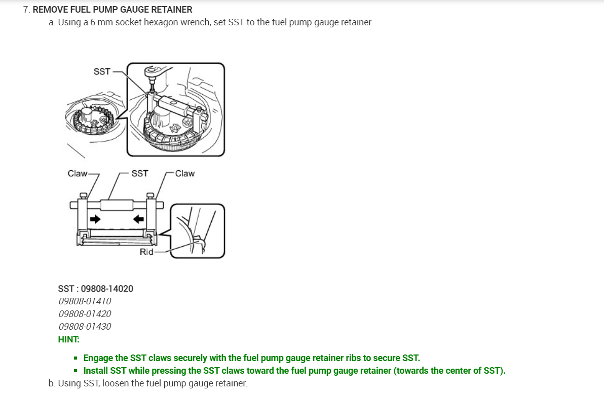

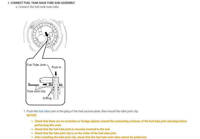

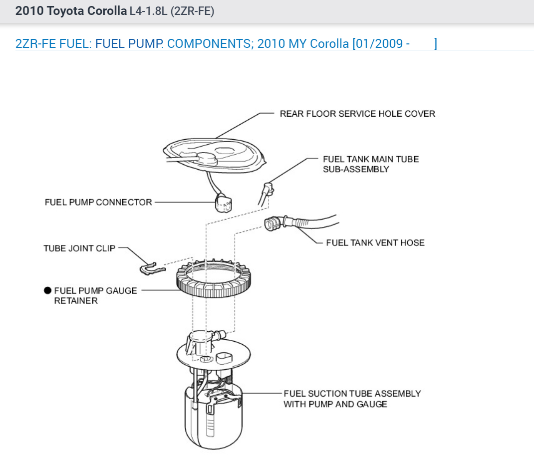

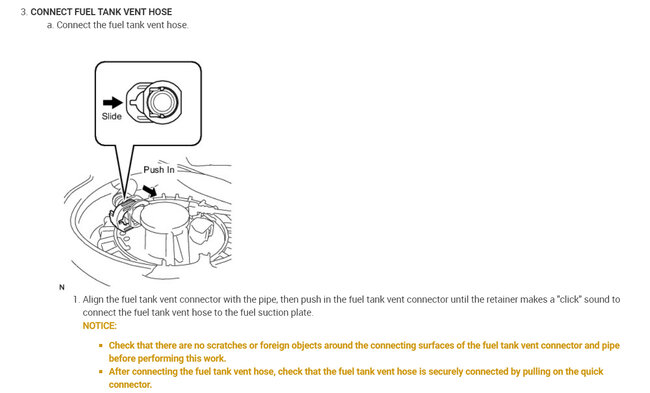

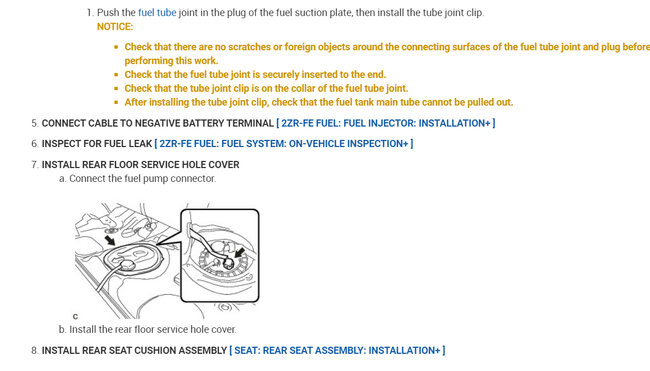

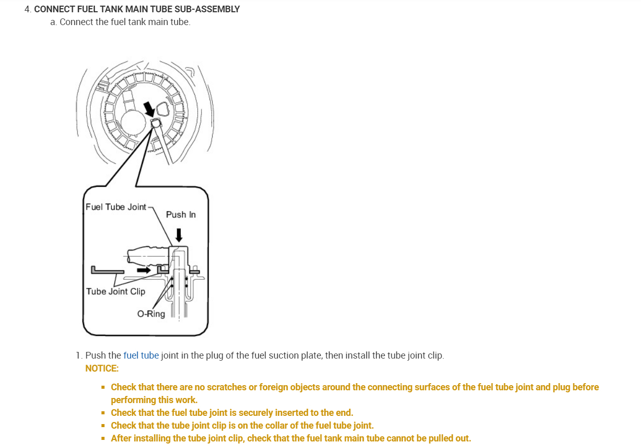

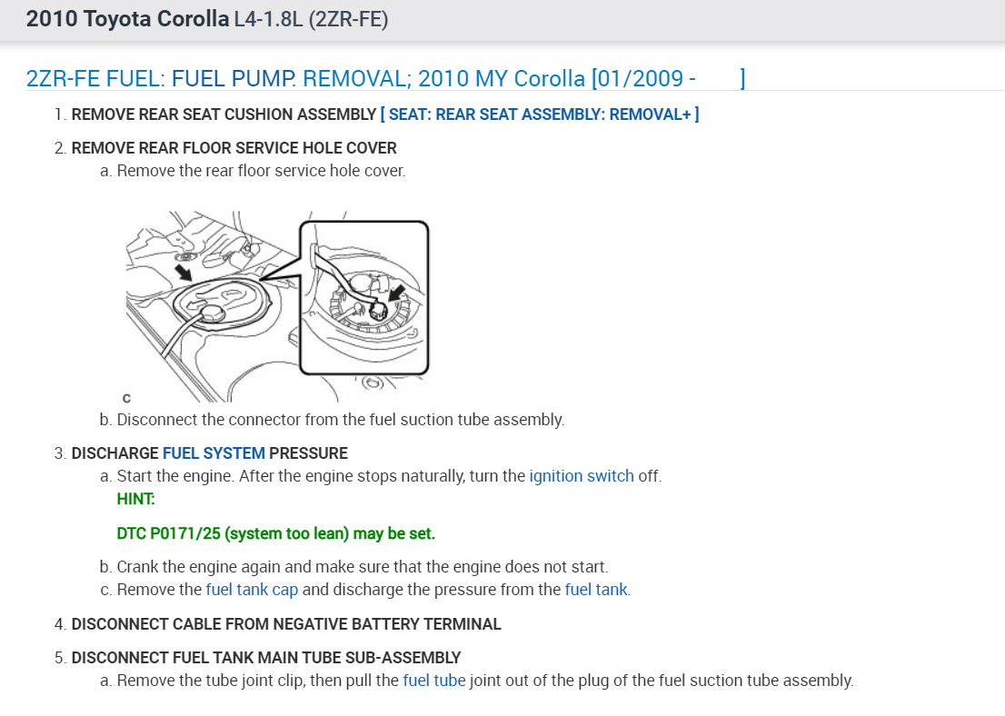

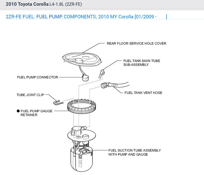

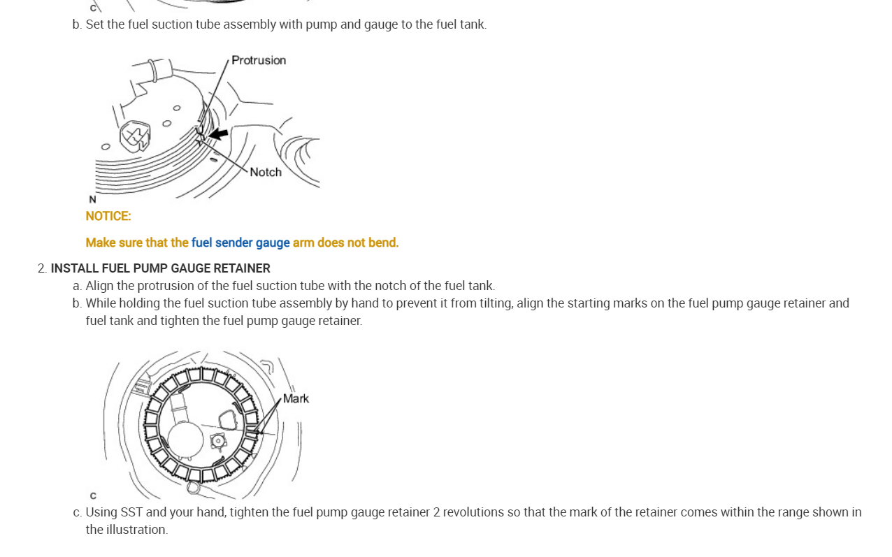

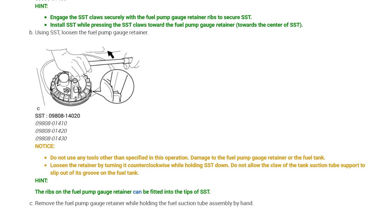

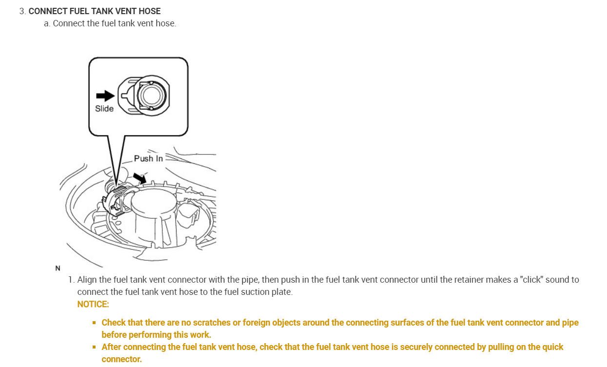

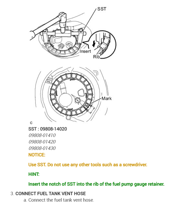

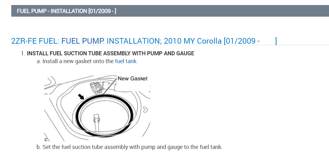

98% of the time the car starts and runs as normal. Randomly, the car will turn off after starting (hot or cold). Have gotten it started and running continuously by hitting the fuel tank. Fuel pressure is at 50 PSI.
Mar 16, 2023 at 7:10 PM
  • 54,832 POSTS

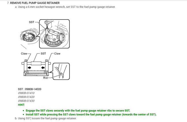

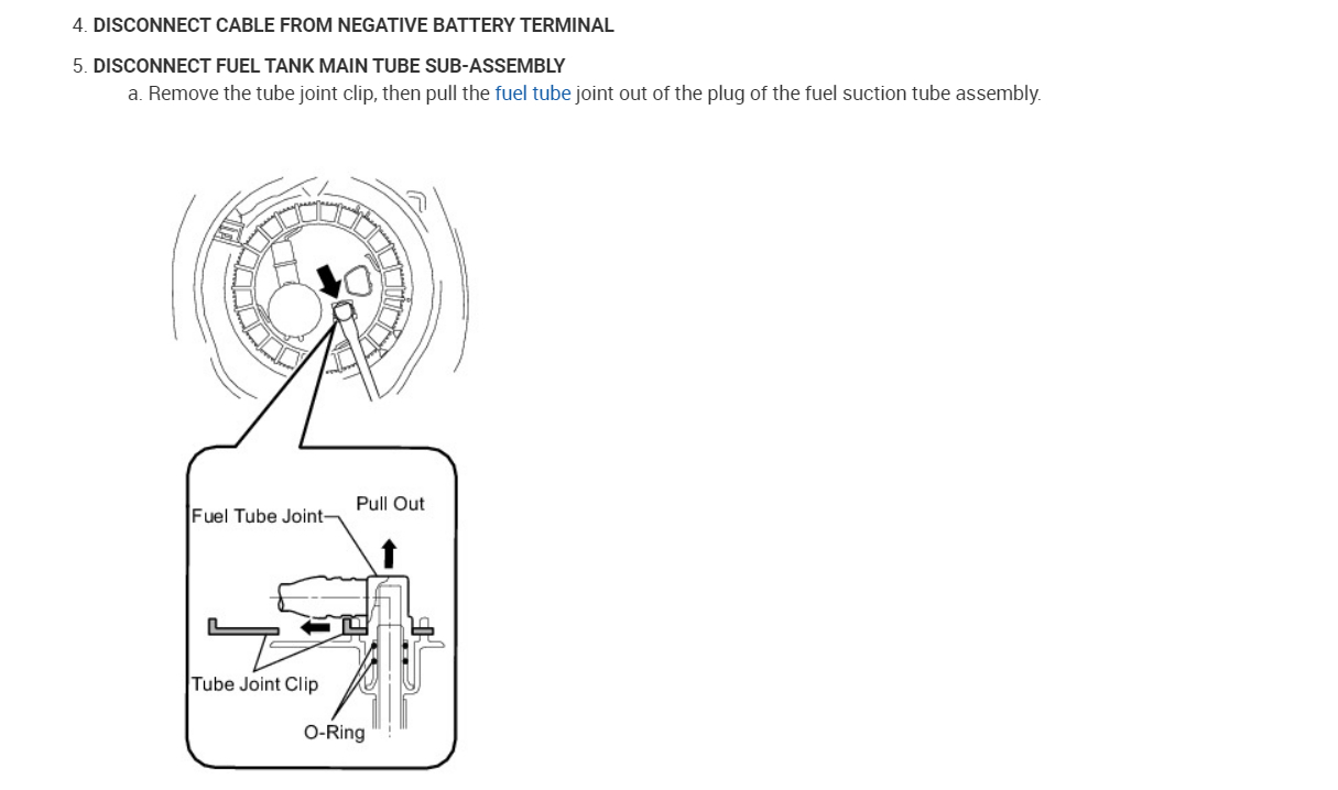

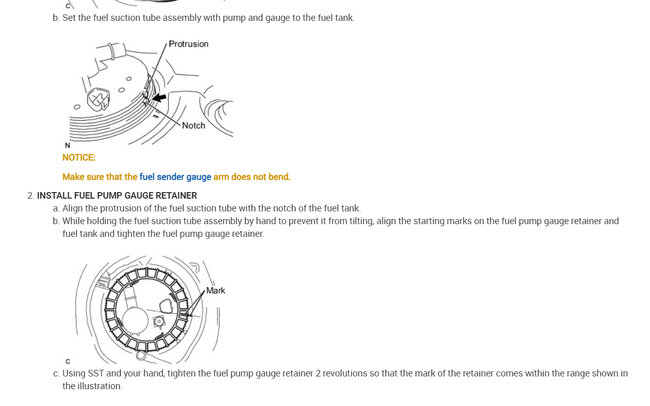

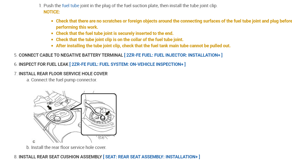

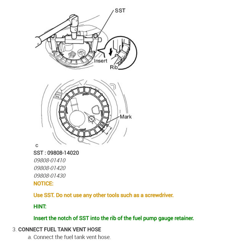

"Started and running continuously by hitting the fuel tank" is a clue the fuel pump is going out here is how you can change it out to fix the problem in the images below. Also 50 PSI is low, another clue the fuel pump is weak. Fortunately, the fuel pump was a tap door under the rear seat, so replacement is easy. Also check inside the tank to make sure there is no contamination or water rolling around in the bottom of the tank. Check out the images (below). Please let us know if you need anything else to get the problem fixed.
