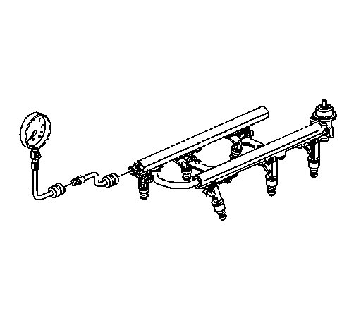

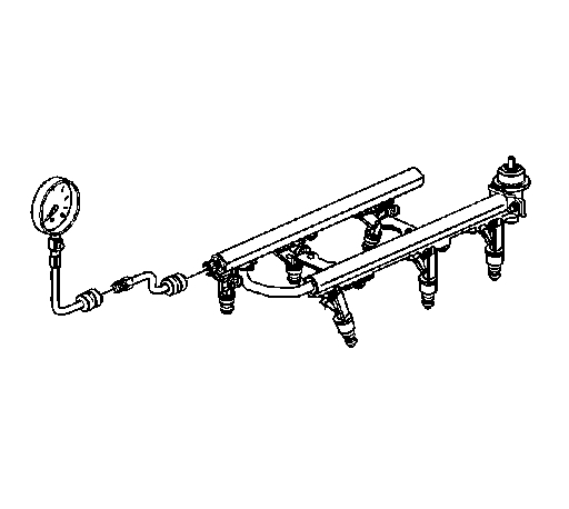

Here is a link that explains how in general to check fuel pressure:
Here are directions specific to your vehicle for connecting the fuel gauge (most parts stores will lend you one) Pic 1 correlates with these directions.
FUEL PRESSURE GAGE INSTALLATION AND REMOVAL
TOOLS REQUIRED
- J 34730-1A Fuel Pressure Gage
- J 34730-262 Fuel Pressure Gage Fitting
INSTALLATION PROCEDURE
CAUTION:
- Gasoline or gasoline vapors are highly flammable. A fire could occur if an ignition source is present. Never drain or store gasoline or diesel fuel in an open container, due to the possibility of fire or explosion. Have a dry chemical (Class B) fire extinguisher nearby.
- Refer to Fuel Gage Leak Caution in Service Precautions.
NOTE: Clean all of the following areas before performing any disconnections in order to avoid possible contamination in the system:
- The fuel pipe connections
- The hose connections
- The areas surrounding the connections
1. Disconnect the negative battery terminal.
CAUTION: Refer to Battery Disconnect Caution in Service Precautions.
2. Remove the fuel pressure connection valve cap.
3. Install the J 34730-262 to the fuel pressure connection.
IMPORTANT: Install the fuel pressure gage fitting above the belt in order to avoid contact with the belt.
4. Connect the J 34730-1A to the fuel pressure connection. Wrap a shop towel around the fuel pressure connection while connecting the fuel pressure gage in order to avoid spillage.
5. Install the bleed hose into an approved container and open the valve to bleed the system pressure. The fuel connections are now safe for servicing.
6. Drain any fuel remaining in the fuel pressure gage into an approved container.
7. Close the bleed valve on the fuel pressure gage.
8. Command the fuel pump ON with a scan tool.
9. Inspect for fuel leaks.
REMOVAL PROCEDURE
1. Place the fuel pressure gauge bleed hose into an approved container and open the bleed valve to bleed fuel system pressure.
pic 1
2. Place a shop towel under the fuel pressure gage adaptor fitting to catch any remaining fuel spillage.
3. Remove the J 34730-1A from the adaptor fitting.
4. Remove the J 34730-262.
5. Drain any fuel remaining in the fuel pressure gage into an approved container.
6. Install the cap on the fuel pressure connection.
Here are the manufacturer's fuel pressure specifications.
Fuel Pressure (Key ON, Engine OFF) .................... 358-405 kPa (52-59 psi)

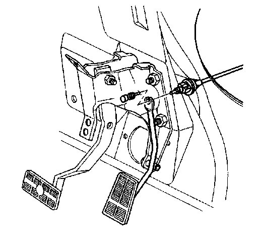

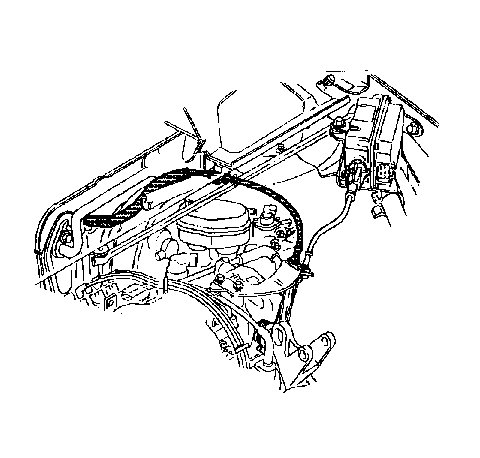

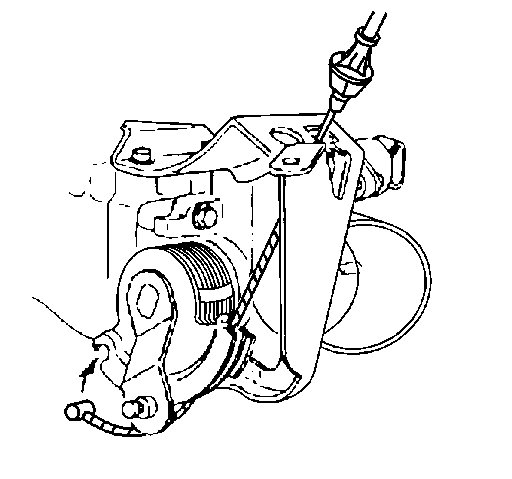

Last, this vehicle has a throttle cable. Make sure it isn't frayed or sticking. Check on the throttle body to make sure it moves freely.
If you find it is bad, here are the directions for replacement. The remaining pics correlate with these directions.
ACCELERATOR CONTROLS CABLE REPLACEMENT
REMOVAL PROCEDURE
pic 2
1. Disconnect the accelerator cable from the throttle body lever.
2. Disconnect the accelerator cable from the accelerator cable bracket.
pic 3
3. Remove the left instrument panel sound insulator.
4. Disconnect the accelerator cable from the accelerator pedal.
5. Pull the accelerator cable through the bulkhead.
