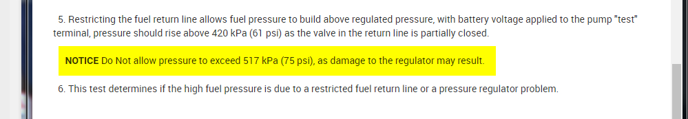

Had issue where under load it would spit and sputter. Replaced fuel pump, fuel filter, rotor cap and button,and pressure regulator. After replacing all this it ran fine for 3 or 4 minutes then started down road it shut off. Now it starts idles rough for a few seconds then shuts off. The spider injector is fine was replaced last summer. No fuel leaks, plenty of fuel pressure and is getting to the cylinders. Anyone have another idea or similar issue that they fixed? Thank y'all in advanced.

If there are no vacuum leaks then we need to confirm what the fuel pressure is. When you say it has plenty of pressure, do you know what this is?

80 PSI.

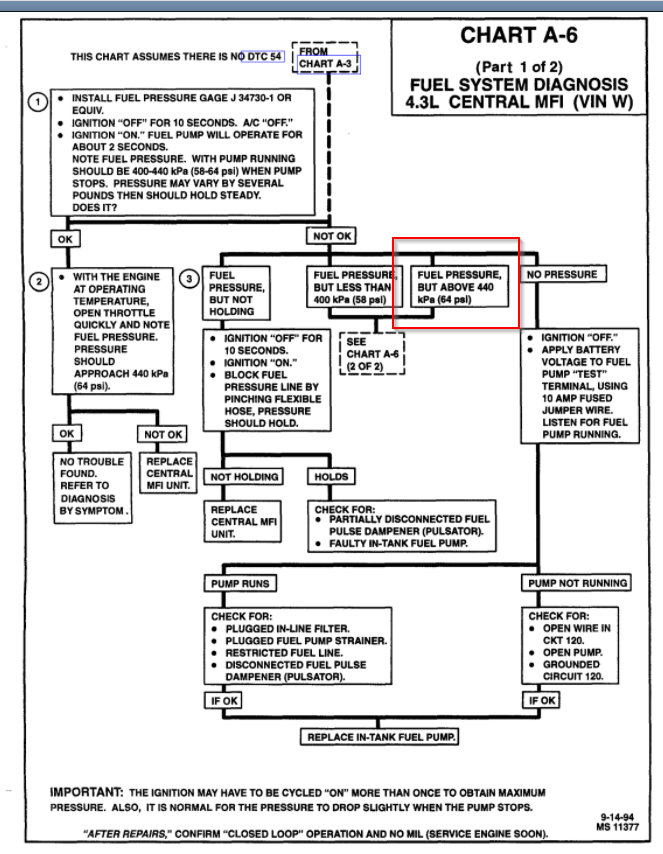

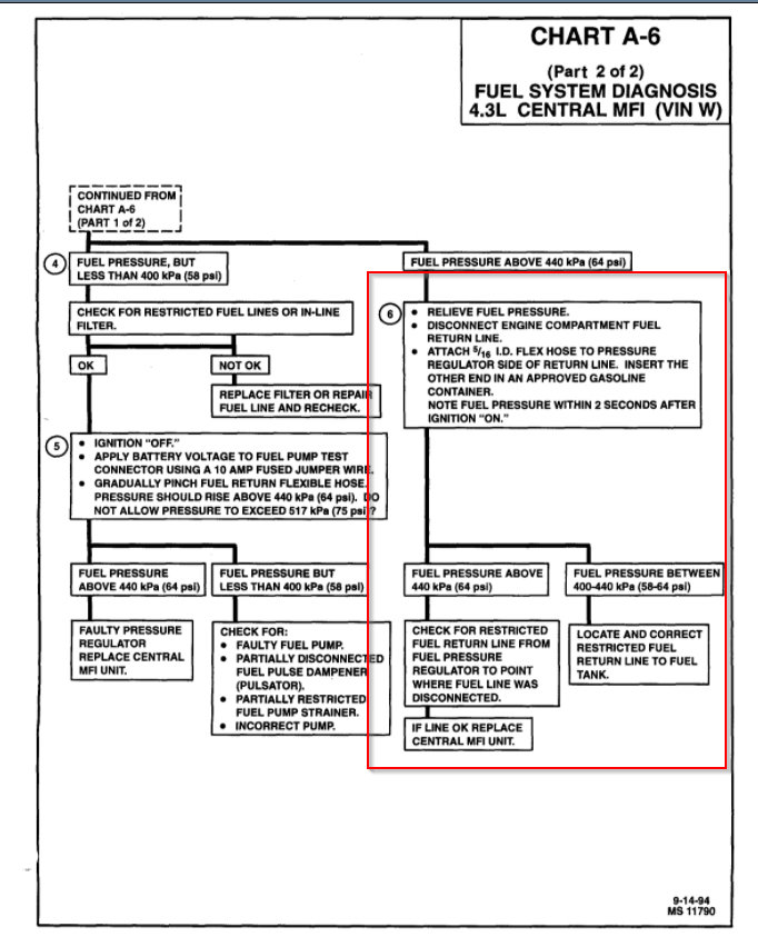

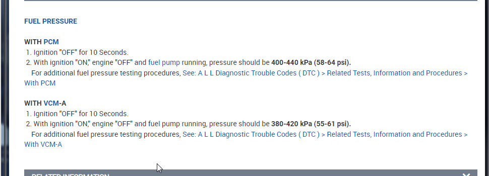

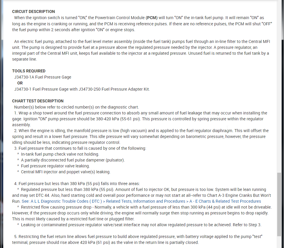

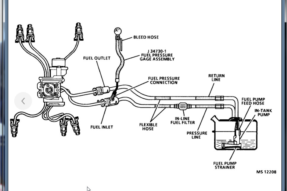

That is way too high and is most likely your issue. High fuel pressure will cause the engine to run poor or not even run.
Take a look at all the attachments below. This will help run through how to figure this out.

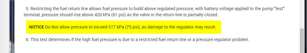

However, it is most likely an issue with the return line. Please take note of the last page where it says not to run the engine with more then 75 PSI or you will damage the regulator.
