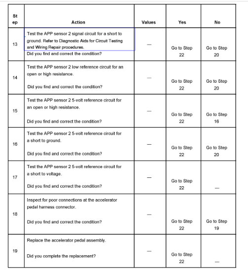

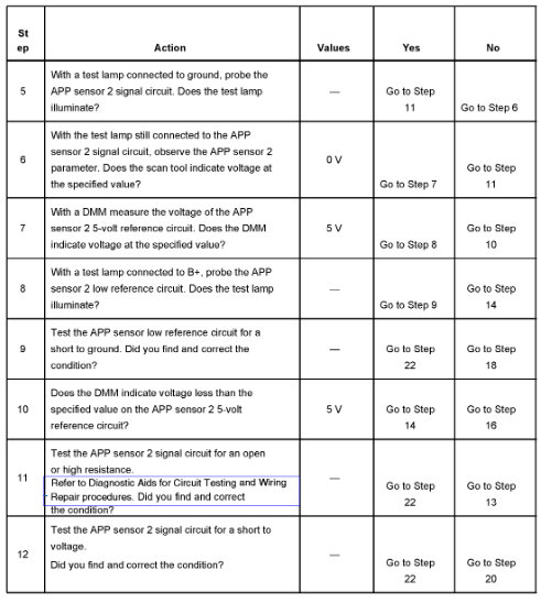

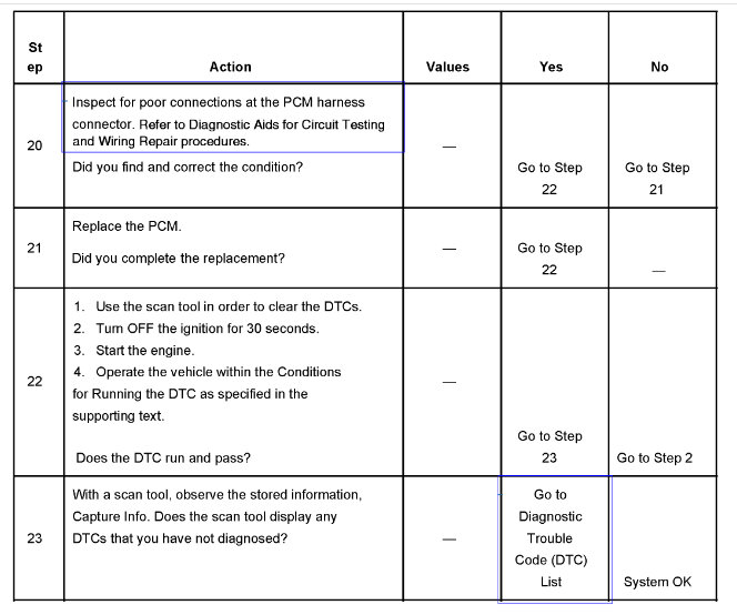

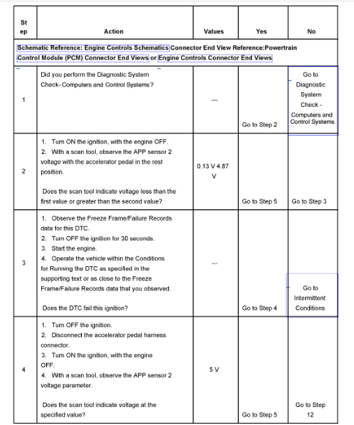

Both codes are related to the accelerator pedal position switch in the vehicle. Was any work done to that?
Do me a favor. I attached diagnostics for the P1280 below. I feel that code should be checked first. Take a look through the diagnostics and let me know if you are comfortable performing them.
Aug 19, 2024 at 1:02 PM
HUNTER0307
  • 13 POSTS
No work was done to the interior at all, I have a Foxwell scan tool, I am comfortable with testing, and will get back tomorrow.

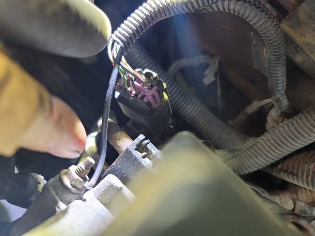

Problem solved, thank you for all your help, attached picture of issue.
Aug 20, 2024 at 11:58 PM
  • 110,248 POSTS
It was a ground??? If so, I'm glad you found it. Electrical issues can be a pain. LOL
As far as your question about specifications is concerned, yes, I would be happy to get what you need. I just need you to start a new question when the topic changes or the vehicle changes. It is more helpful to others when that is done.
Here is the link to start a new one:
Regardless, I'm glad to know the problem is resolved. Take care and feel free to come back any time in the future.

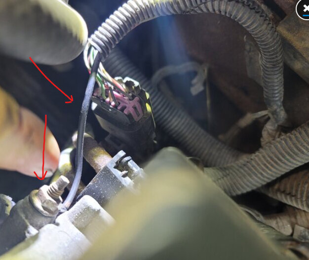

Hi where was this fix at I'm having the same issue
Jun 28, 2026 at 3:28 PM
  • 55,721 POSTS
The fix was the throttle body was damaged internally or the throttle body connector/pins got disturbed during the repair. Let me know if you you have other issues.
Jun 29, 2026 at 7:06 AM
THICKISHGARAGE
Hunter0307 where was this ground fix. Is this under the ecm
Jun 29, 2026 at 7:52 AM
  • 55,721 POSTS
Check out the arrows
Jun 29, 2026 at 11:01 AM
THICKISHGARAGE
I can see that. I was asking what location this is.
Jun 29, 2026 at 3:14 PM
  • 55,721 POSTS
Yep, sorry about that, it is near the throttle body.
