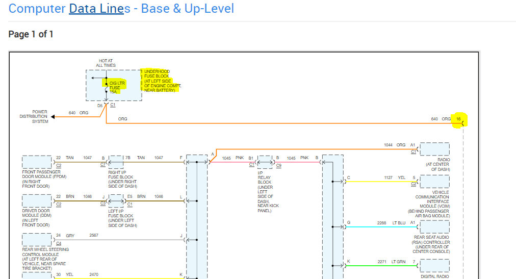

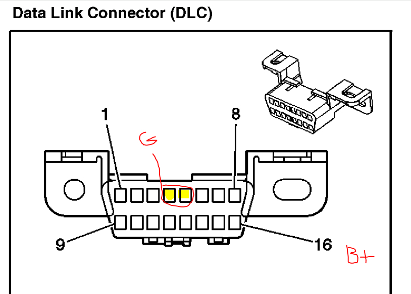

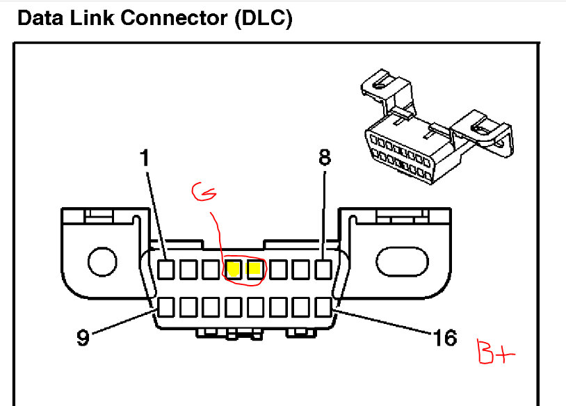

As far as the fuse question is concerned, there are no fuses on the fuel rail. Also, you indicated you can't retrieve codes. Check pin 16 at the data link connector. It should have power at all times. If there is no power, check the cigarette lighter fuse in the under-hood fuse box. If the fuse appears good, confirm there is power to and from it.
Pic 2 below shows the DLC. Pin 16 should have battery voltage at all times. Pins 4 and 5 are grounds. Check for continuity to ground if pin 16 checks are good.

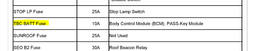

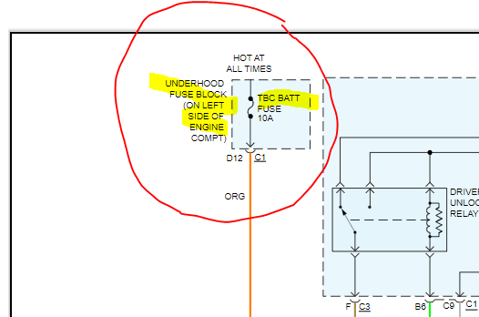

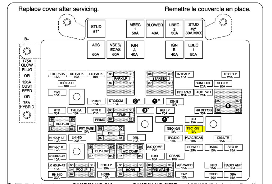

First, I need you to check the TCB fuse. This is a 10-amp fuse in the under-hood fuse box.
The TCB fuse powers the body control module which controls the electronics you are dealing with. See pics below.
When you check the fuse, make sure there is power to and from it.
Let me know what you find.

Were you able to confirm there is power to and from it? If so, then we need to check at the body control module for power at the orange wire.
Also, consider scanning the can-bus to see if there are codes stored in the BCM that may point us in the right direction.
