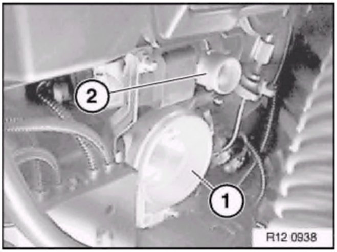

It sounds like an issue with the idle speed control valve. I will supply the directions for replacing it, but before replacing it, check it for carbon build up or corrosion that can cause it to not function properly. The attached pictures correlate with the directions.

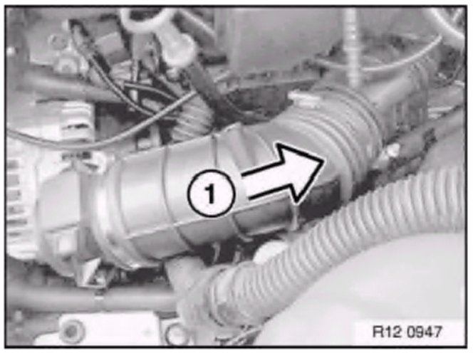

pic 1
M52TU only:
Remove intake filter housing.
Pull Bowden cable upwards out of holder (1) and suspend from throttle.

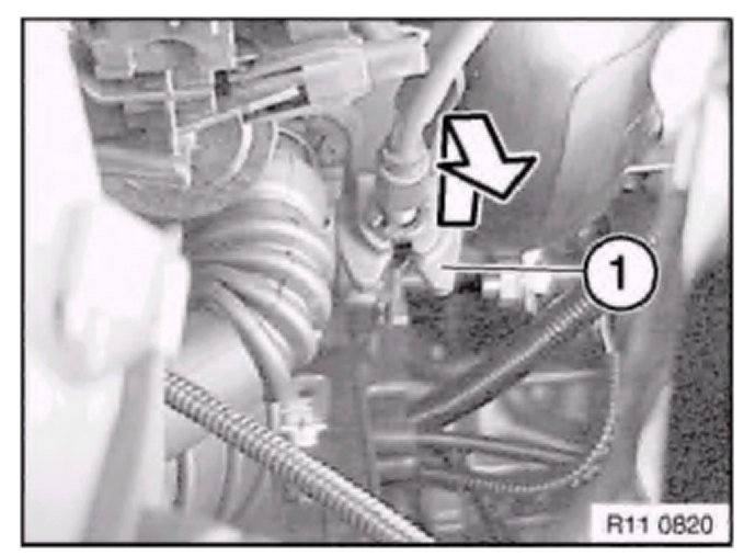

pic 2
Release hose clamps (1).
Detach intake hose piece from throttle assembly and idle-speed control valve.

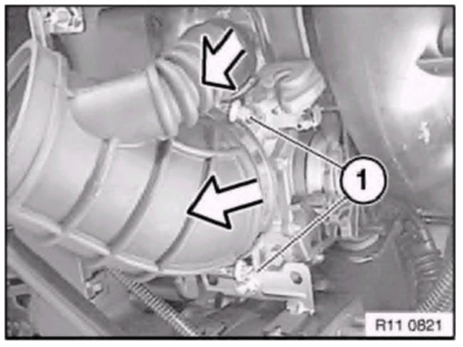

pic 3
Installation:
To facilitate installation, fit air-mass flow sensor with intake hose (1). Coat intake hose (1) with antiseize agent.

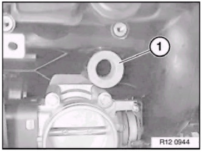

pic 4
Disconnect following plug connections:
1 - Resonance flap
2 - Idle-speed control valve
Installation location:

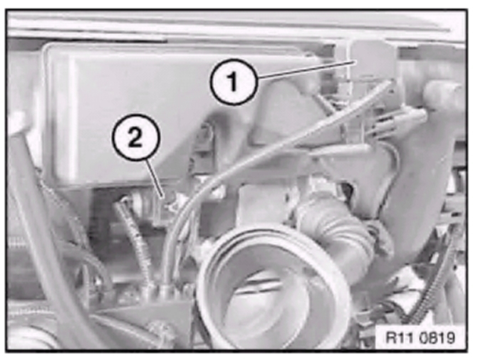

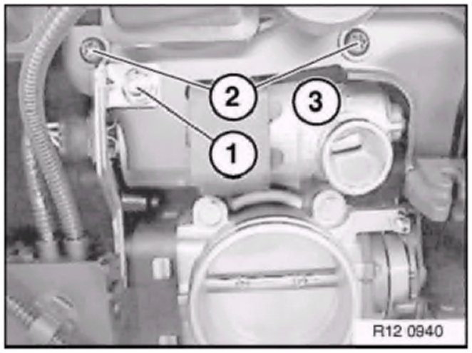

pic 5
Idle actuator (2) is fitted below intake air manifold, directly above throttle (1).

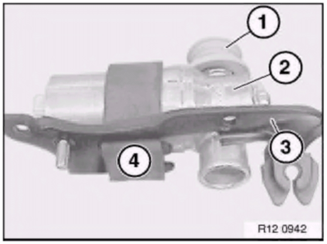

pic 6
Release screw (1) on cable duct mounting.
Release screws (2) on holder of idle actuator (3).
Remove idle actuator valve with holder from intake air manifold.
pic 7
Detach idle actuator (2) from rubber retainer (4).
Always replace gasket (1) from idle actuator (2) to intake air manifold. However, during reinstallation, do not fit gasket on idle actuator but install first in intake air manifold.
