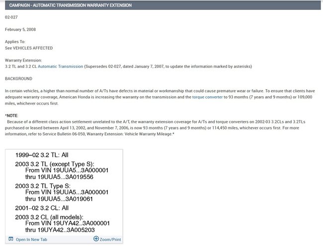

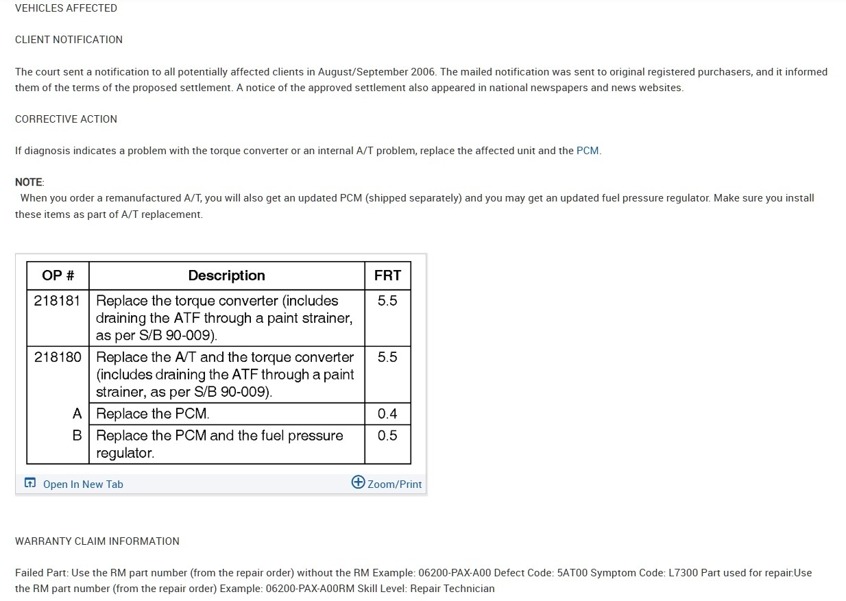

Okay, there was a campaign for a manufacturers defect in the transmission and/or torque converter, there are also quite a few technical service bulletins for the transmissions in these vehicles. As for the injectors being replaced, or a fueling issue, the shop should have been able to diagnose that pretty easily. With monitoring the live engine data with a scan tool, it should show if the engine is going lean (lack of fuel) when put into drive if that was the case. Or if the fuel injectors were losing a control signal from the ECM. You may want to try a better shop if they cannot give you more information. They should also have done an idle relearn after putting the ECM back in the vehicle.
