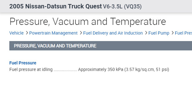

Starts but then sputters and shuts off?
2006 NISSAN QUEST
180,000 MILES • 3.5L • V6 • AUTOMATIC
MCARTER93
Also, no reaction from pressing on the gas pedal. What can it be?

Based on your description, it sounds like the fuel pump may be failing. With that in mind, I would start by checking the fuel pump pressure. You will need a fuel pressure gauge for this, but most parts stores will lend one to you.
Here is a link that explains in general how to test it:
If you look below, I attached the manufacturer's fuel pressure specifications for this vehicle.
Let me know if this helps and what you find.
See pic below.
