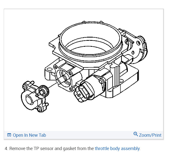

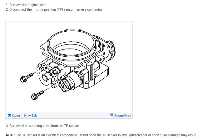

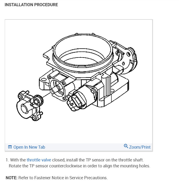

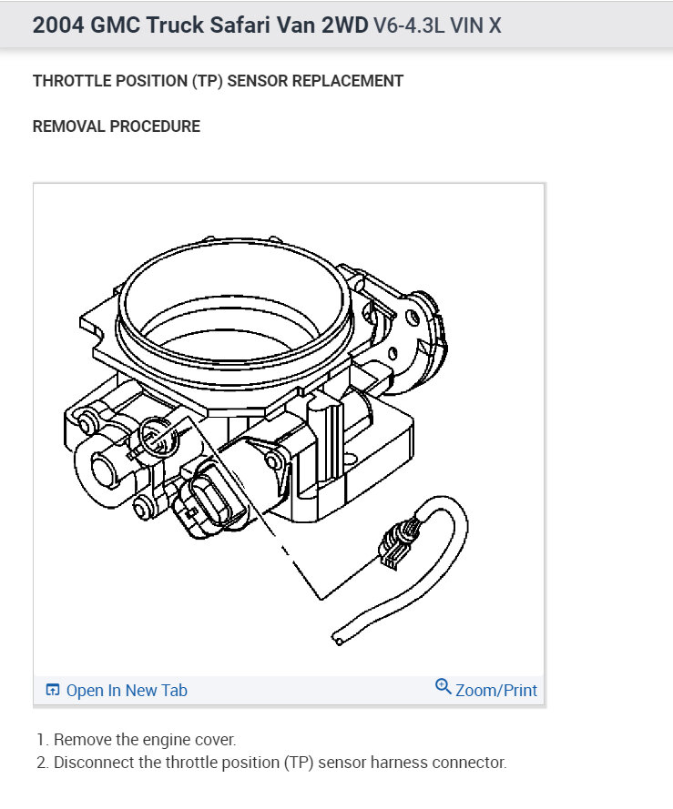

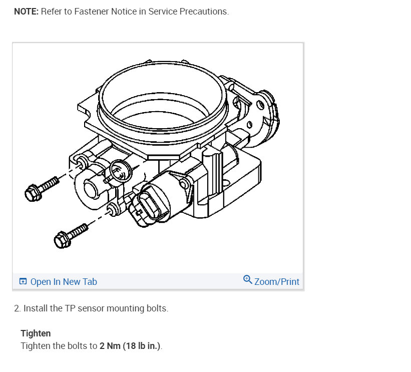

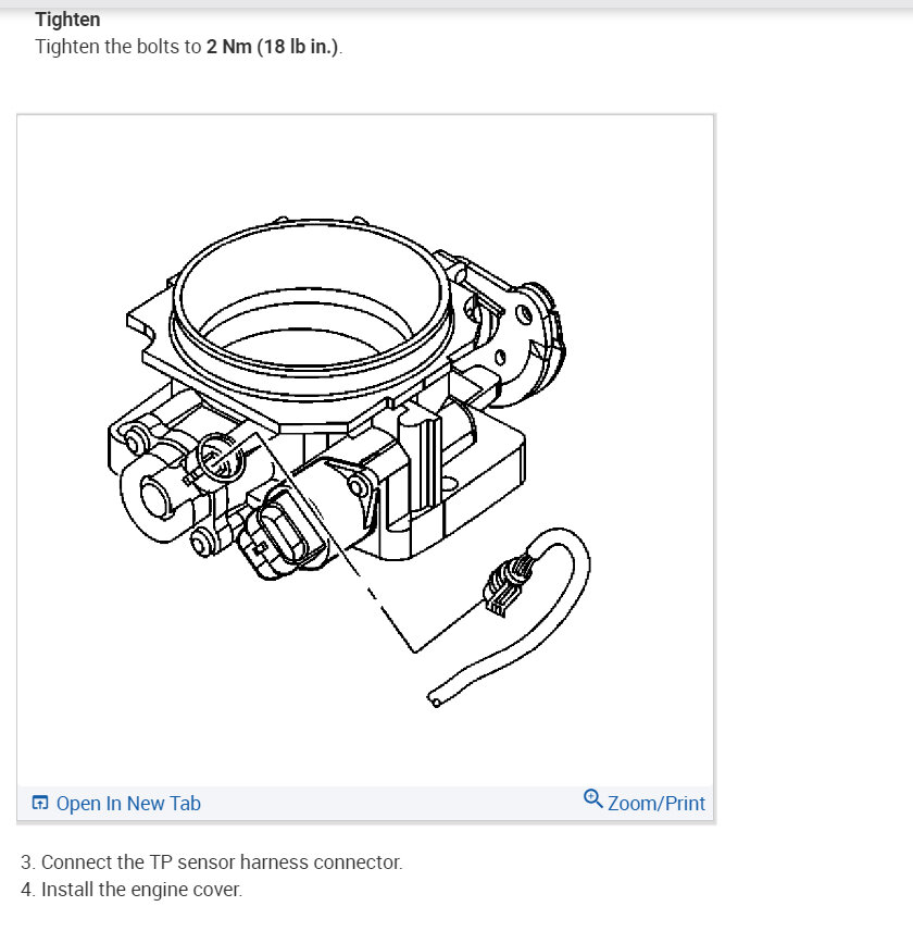

Okay it could be the TPS sensor that has gone out, but we should run the codes to see what comes up. Also let's run the codes as well, here is a guide to help and I have included the TPS location so you can check it out:

Can you scanner read the TPS to see if it is working?
Apr 2, 2023 at 2:53 AM
THE1NONLY
  • 8 POSTS
I checked the TPS with multi meter and it checks out all good. Power, ground, signal and when open throttle it's smooth increase. So that's all good. I really think it's the crazy pass lock. All my research and testing so far. But is there any way to test pass lock. Cause it could be my (BCM)cause the pass lock is part of my BCM I'm pretty sure. I couldn't find a separate module anywhere. or the cylinder lock / or cylinder housing, correct? And anyway, to test these? I'm about to just try to bypass with a 2200ohm resister, and knowledge on how well that works. I've been hearing mixed reviews but can't afford the 250$-$300 bypass module.
