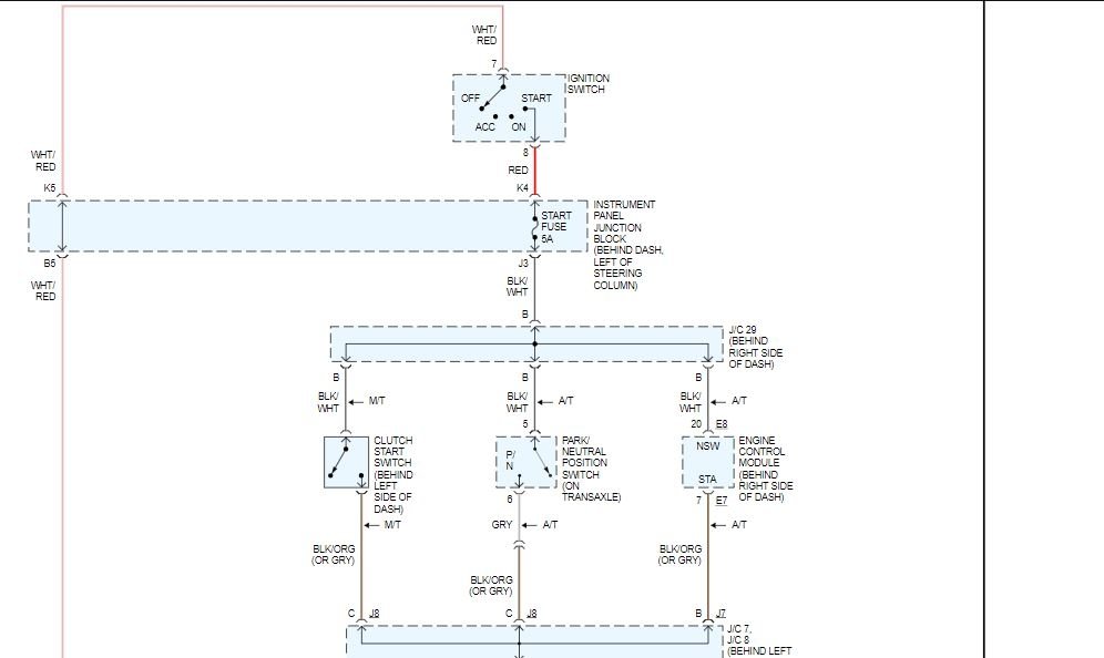

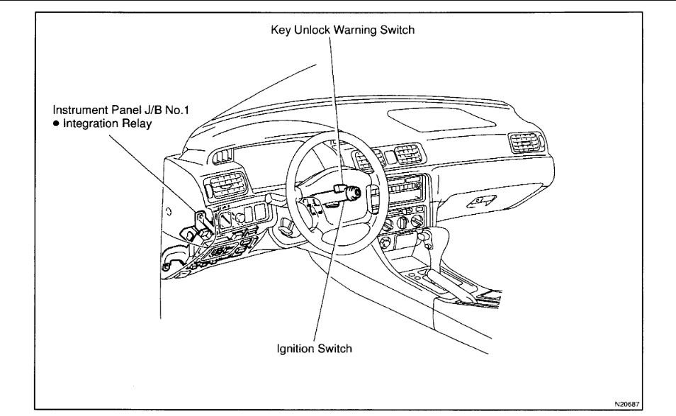

I am having a starting problem when I turn the key to the "on" position the starter cranks. I replaced the relay but problem continues. Anyone have any input? Thank you
Oct 6, 2018 at 11:47 AM
Good morning.
The starter signal should only be sent in the start position. It sounds like you have a failed ignition switch if power is being sent in the on position.
