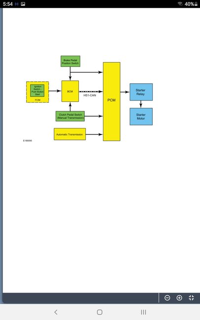

I see you've gone through alot with this so far usually its the simple thing that gets over looked. In that making sure that the clutch switch, brake switch and the anti theft ID key aren't causing your no start condition or the ignition button itself or the starter solenoid. What was the situation when this first began? Just one day you went to start it and it didn't start clear out of the blue? Does the remote start system work? I would work my way backwards and get right to the starter and jump it there, then get to the starter relay and jump its terminals to see if its good there.
Here is the description of your system and I have attached the signal flow chart too. Review this and let me know if it helps as well as going right to the starter and its relay making sure they are good by starting the car from them.
Push button starting vehicle is equipped with a PATS that disables the engine from cranking if an unprogrammed PATS key is used or an invalid PCM ID is received. The PATS is controlled by the BCM . If there is a PATS concern that causes the engine to be disabled, the IPC displays the corresponding message in the message center. Ignition modes are controlled by the RFA module and the BCM .
The ignition switch - push button start is connected to the RFA module and the BCM as a backup in case of a failure. If there is a circuit failure to either module from the ignition switch - push button start, the modules communicate the ignition switch - push button start request to each other over the Medium Speed Controller Area Network (MS-CAN).
During a start event the ignition switch - push button start is pressed in combination with either the brake pedal (automatic transmission) or the clutch pedal (manual transmission) input. The RFA module, the BCM and the PCM receive a request to start the engine. The PCM recognizes the correct inputs and provides voltage and ground to energize the starter relay coil and close the starter relay contacts. The starter relay contacts close, providing voltage to the starter solenoid, allowing the starter motor to crank the engine. The PCM disengages the starter motor once an engine Revolutions Per Minute (RPM) threshold is reached, a set crank time is exceeded or the ignition switch - push button start is pressed indicating an engine shutdown.
