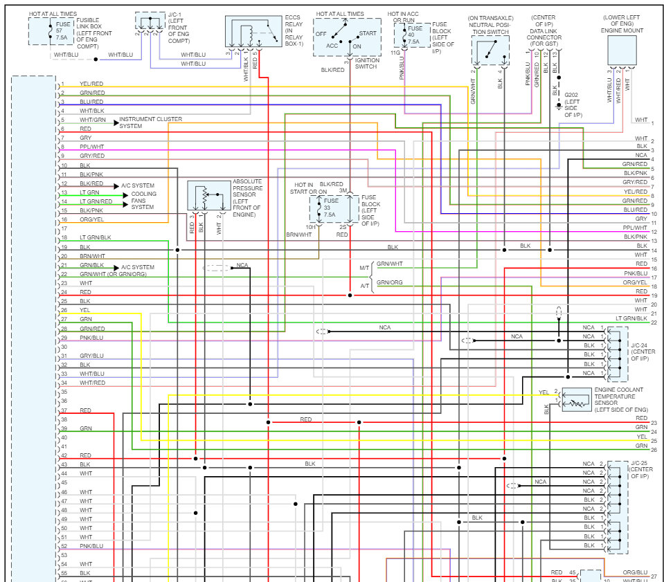

If it sits for a while, it doesn't want to start. It'll crank several times before it starts. Once it starts it dies. It started just dying on low idle. Now it's dying as it runs. It gave a power train code. P1335. It has a new harmonic balancer, crankshaft position sensor (the one on harmonic balancer, not bell housing) belt tensioner, alternator and radiator.
Jul 23, 2023 at 2:16 AM
  • 55,456 POSTS

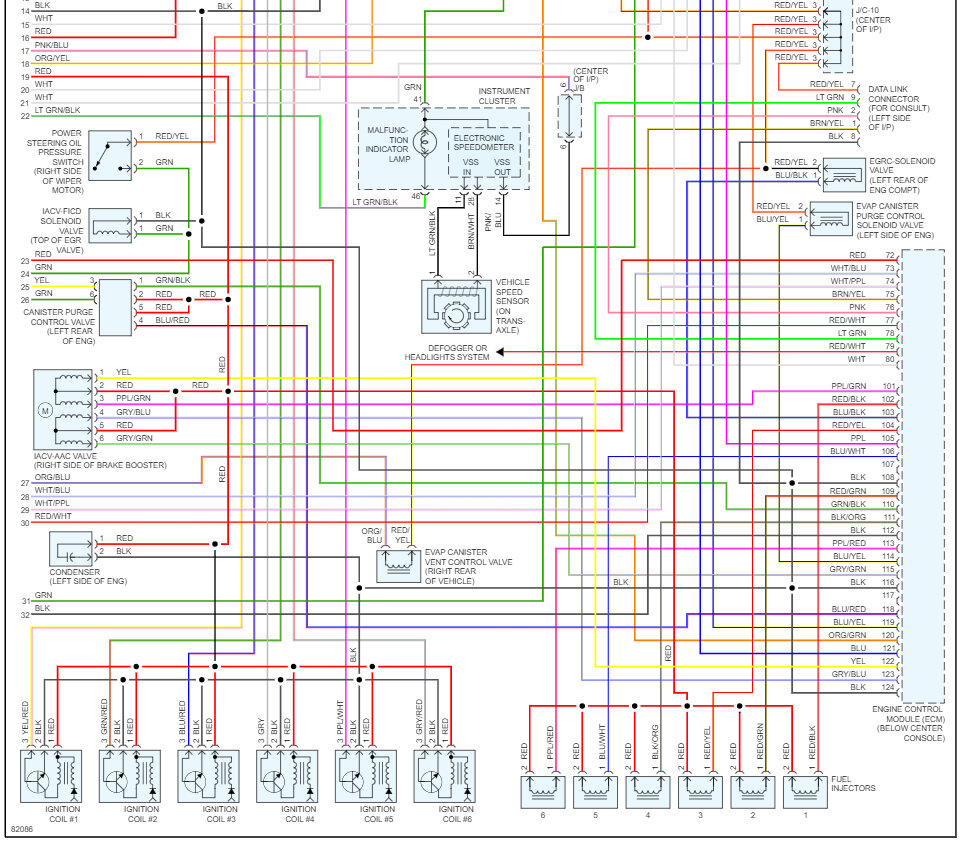

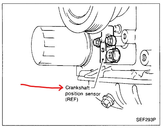

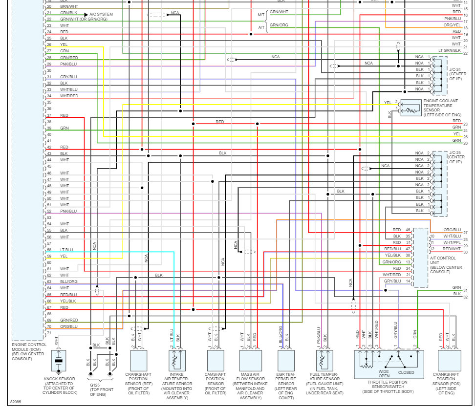

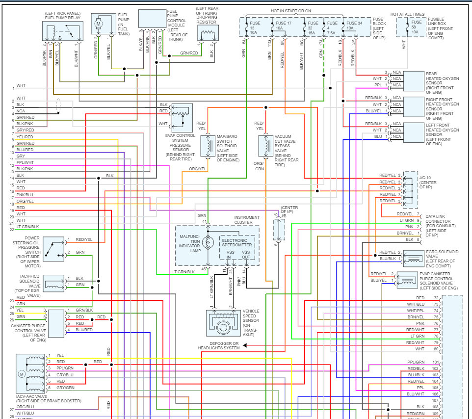

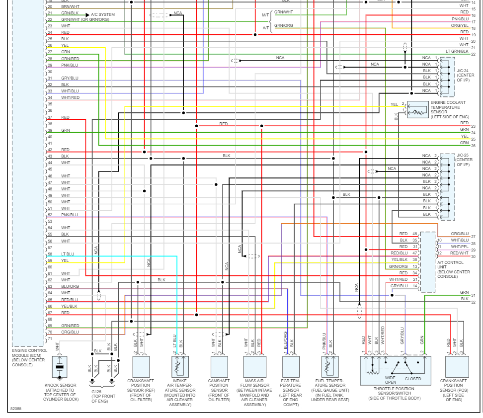

Just to be clear this is the sensor you replaced, correct? If so, you have an issue with the wiring circuit. I have included the sensor that should have been replaced in the diagrams below. You should check all the fuses as well.
Error code P1335 a problem with the Crankshaft Position Sensor (CKPS) or its circuit.
here is a guide to help you test the wiring and the PCM and crankshaft wiring diagrams below to help as well:
Check out the images (below). Please let us know how it goes.
