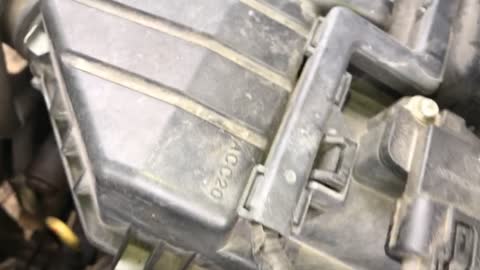

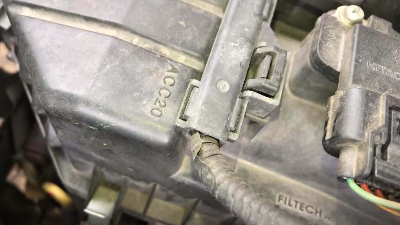

When I try to crank my car it make a noise but don’t turn on. My lights in the car come on. Someone said it was the starter. So I got a new one and got it put on and it still did not crank. So they said my motor could be locked, but I’m thinking it’s my VVT switch.
Monday, January 4th, 2021 AT 11:15 AM (Merged)
What noise does it make when you turn the key? Does it actually turn over or does it just click? Maybe get a video of what it does when you are starting it because that will help us get on the same page.
Let me know and we can go from there. Thanks
JAZZYPHAY249
Okay, it was making a clicking noise but I think I tried cranking it too many times to the point it started making the noise in the video.
Put a socket and breaker bar on the crankshaft pulley and make sure the engine turns over. That noise is the starter gear bouncing on the flex plate (the toothed gear wheel that turns the engine when the starter turns). If the engine is locked up it will do this so we need to make sure you can spin the engine by hand.
