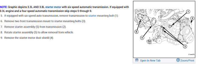

My van has been sitting several weeks with a dead battery. I finally got to it today and replaced the battery correctly. All the electronics work including lights, windows, power seat, power doors, even the rear backup camera works when I place the selector in the R position. All the instrumentation lights come on and go out as they should, except two red squiggly lines on the left-hand side of the instrument panel when the key is turned on. The security red light comes on and goes off as it should, but the two red squiggly lines on the far left of the instrument panel stays on. I get no noise from the starter, not even a clicking noise. Everything worked fine several weeks ago when I parked it. The only thing I have done is change the battery. Any help will be greatly appreciated.

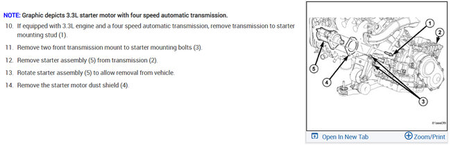

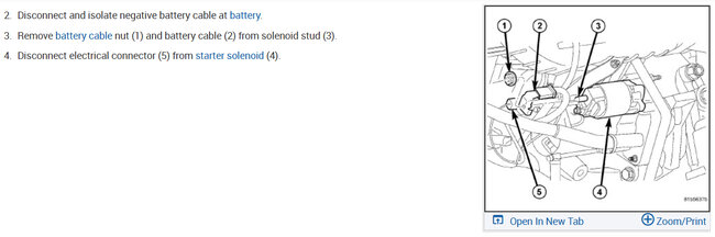

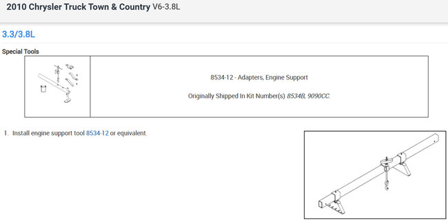

Try to crank the engine over in neutral to see if anything changes. If you tap on the starter and it starts working it is bad, here is how to change it out. Check out the images (below). Please let us know what happens.

I am sorry to hear about your troubles. I would try the hammer trick on the starter to see if there are any changes, it does sound like the starter is the problem though. Here is a guide to check and see for sure though in case the hammer trick does not work.
Please go over this guide and get back to us.
