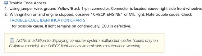

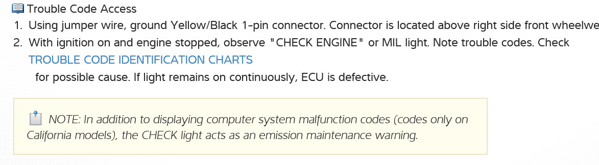

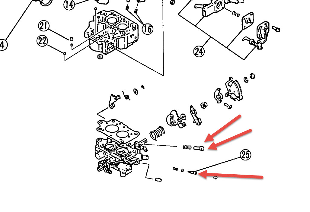

IS THERE A SPECIAL WAY TO CHECK FOR VACUME LEAKS..ANS HOW WOULD I KNOW IF ITS A CARB
Apr 15, 2016 at 4:50 AM
HMAC300
  • 48,601 POSTS
scan for codes first if you can see pic 1 for carb adjustment remove screw 25 and shoot choke cleaner in hole then blow out with air. lightly seat screw and go out 1 and half turns. this is not a good pic of this carb so I thinkit's double arrow screw for idle. carb should still be overhauled. also this is a mikuni carb so may not be right as there are two different ones.
