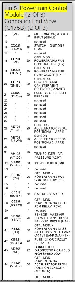

On turning the key to "on" position three additional lights show on dashboard, these are 1) system management 2) engine management 3) water in fuel. Turning the key to start position does not initiate cranking (new battery installed one week ago). On knocking the dashboard a few times above lights extinguish and engine can be started. This is a random phenomena. Local Ford dealer technician opened the dashboard and checked out all of the wiring they were okay, but the scan could not identify the fault. It looks like protection interlock activation does not allow energizing the starter motor. Are there any PCB's, power control modules etc. which might malfunction? Has anybody reported similar problem with Ikon Duratorque 1.4?

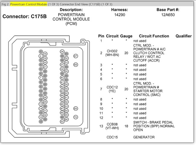

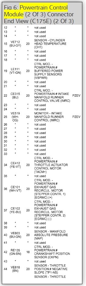

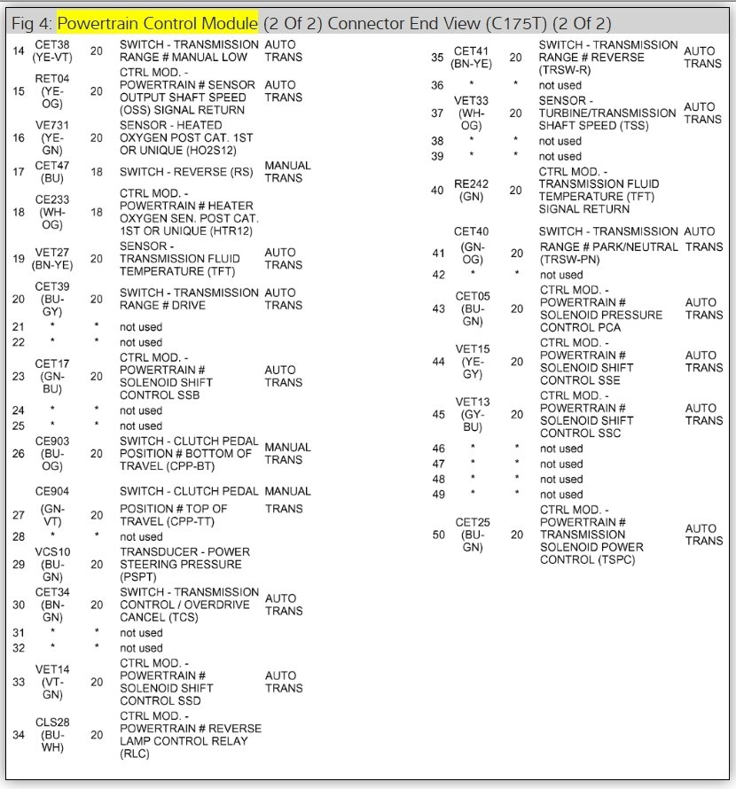

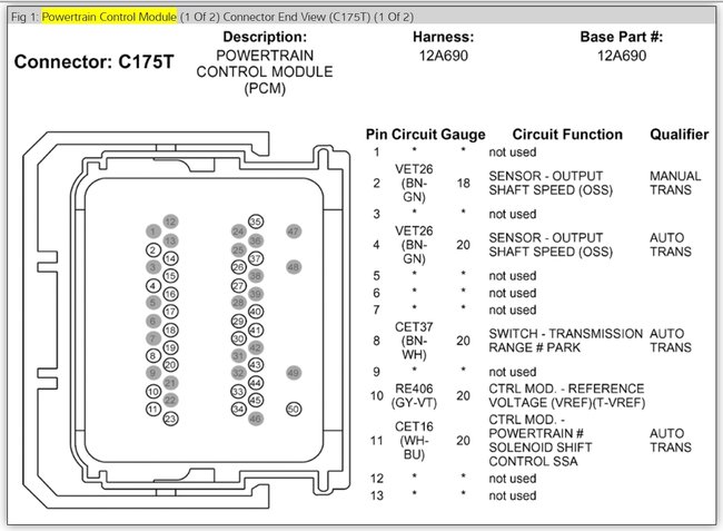

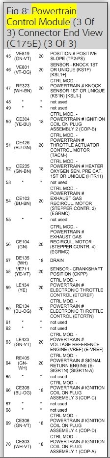

The BCM stands for body control module, but I apologize your car does not have one, it will be the PCM causing the problem. I would do a pin to pin check on the all the system grounds first though because of the blown fuse which could be an indication of this problem. Here are the wiring diagrams for the computer so you can check the computer ground which look like they are at he front fender.
Please let us know what you find
Best, Ken
