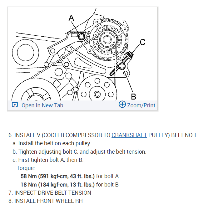

When i turned my car ignition on the check engine and battery light comes on, then when i start the car up the engine runs for 2 seconds and shuts down. Then the Check Engine and Battery light does not come on when i tried to restart the car engine it doesn't start.

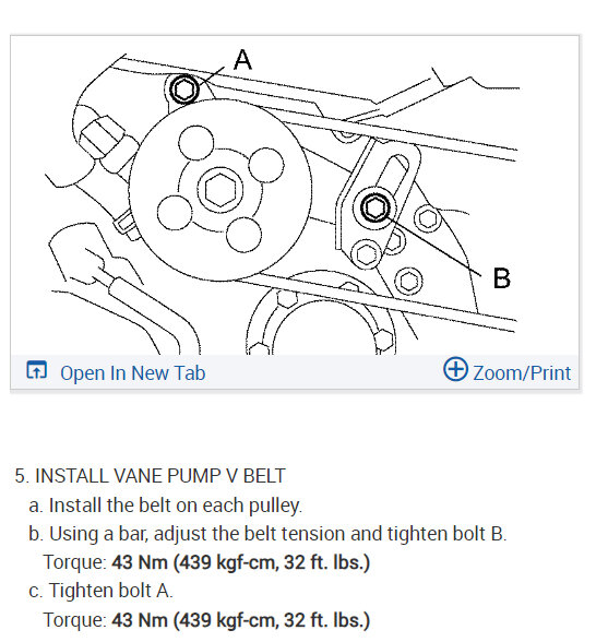

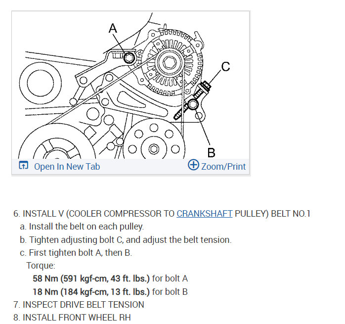

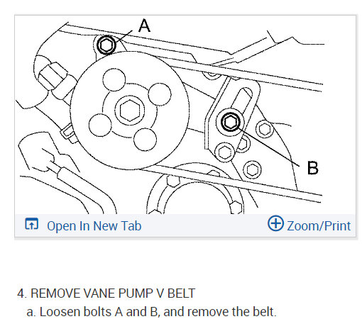

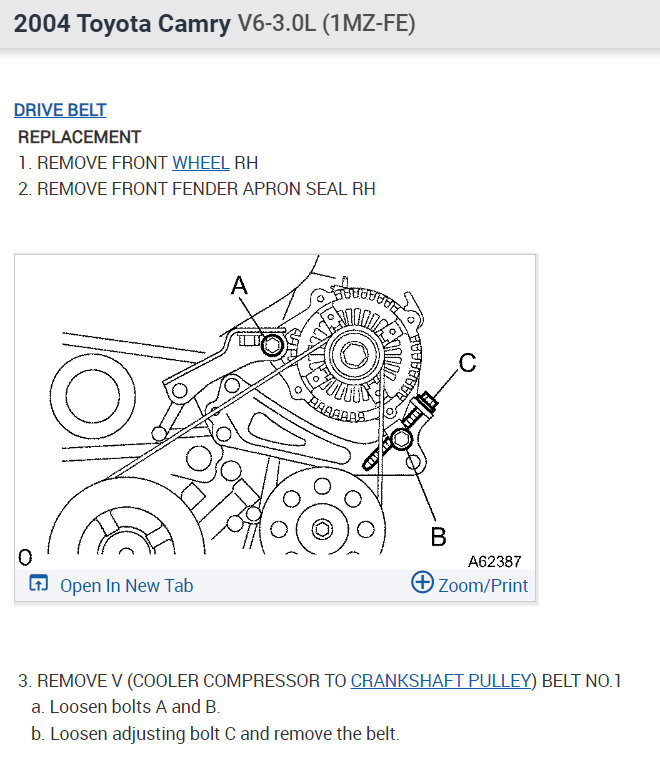

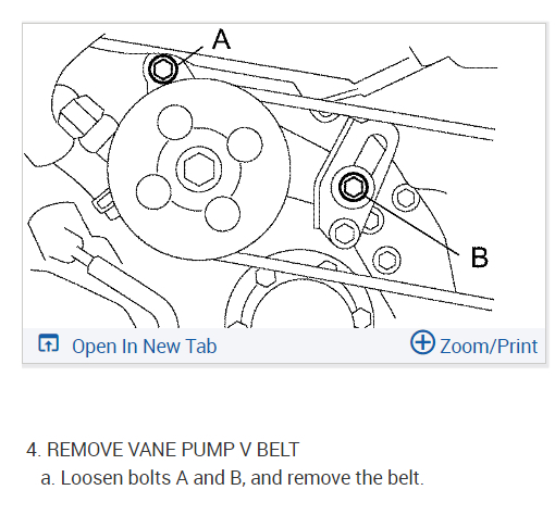

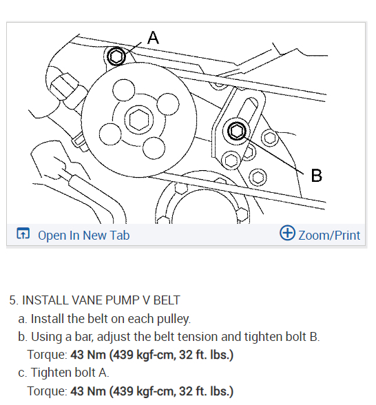

I have seen a bad alternator cause this problem by having a bad diode so it will charge AC voltage. To check for this, you can remove the drive belt and start the engine to see if it runs longer, here is how the job is done in the images below. Also, can I ask if the security light is flashing? Please only run the engine for a short time so it doesn't overheat.

Check out the images (below). Please upload videos of the problem so we can see what's going on.

Yes, i did disconnect the belt and tried it car the engine still wouldn't run. The security light goes off when i insert the key and turn it to the ACC position. I also check all the fuses battery power and ground cable rear engine ground main ground 2 kick panel ground. One more thing i have only the valet key which i have been using. Could that be any issue, but the security light goes off when i inserted it and turn to ACC position. what is my next step?
